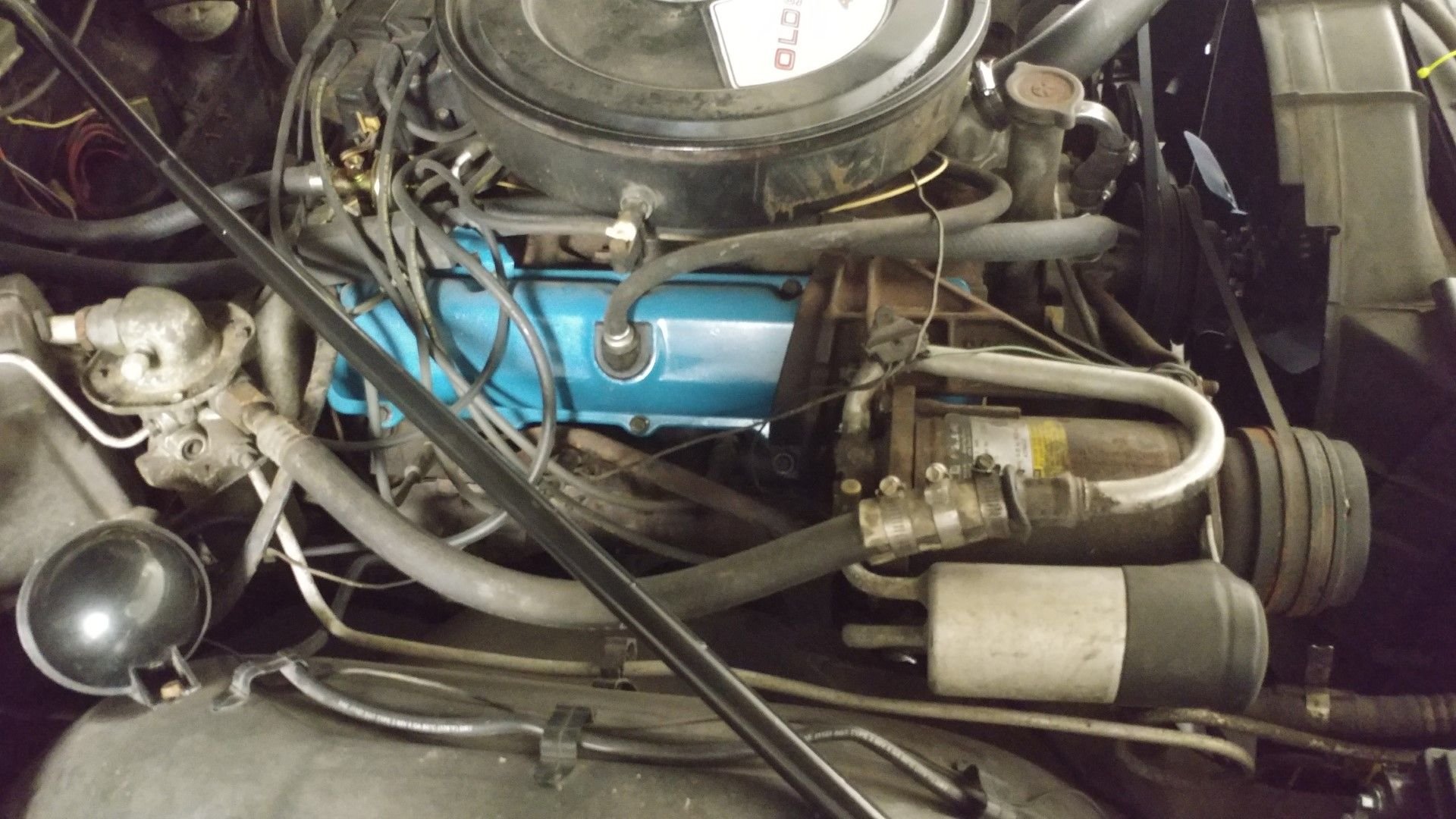

Got the car back this morning, and it is glorious! Nice cold air blowing out all five dash vents just like God intended. I took some photos of the new installation and will post them later.
Old Sep 26, 2018 | 08:23 PM
jaunty75's Avatar
Posts: 15,194
From: southeastern Michigan
Here's some before and after action. The compressor is the original unit, rebuilt. The major issue as far as reinstallation of the new parts was in getting the new condenser, which I couldn't really get a good picture of as it's in front of the radiator, properly hooked up. In the old system photo, there is a narrow diameter, hard-steel line that runs below the thick gray hose and that has a loop in it at the far right. This line had to be replaced because it wasn't long enough nor shaped properly to reach the new condenser. Classic Air refurbished this line with new fittings on each end, but I'm now kind of curious why they did so knowing that it would not match up with the universal condenser they recommended I use. My local shop had to make the flexible black hose you can see in the same location in the second photo. That one is long enough and has the properly-shaped end on it to attach to the condenser.
But all's well that ends well as far as I'm concerned, and I'm very pleased with the performance of the system. Good, cold air flow through all vents. Very comfortable to ride in with all the windows up, something I did not often do in this climate when the A/C wasn't working. I like that it has a combination of old (the compressor) and new (pretty much everything else!).
One last comment. In the old system photo, look at the right-side end of the black hose that connects to the curved piece that connects to the back of the compressor. (If I knew the actual names of all these parts and components, I'd use them!) See the three hose clamps with some piece of white tubing underneath them? Say what? This isn't factory. When I first took the car for a look-see by my local shop back in mid-May, they took one look at this setup, something done by the prior owner, and practically barfed. They said "no way we're going to put anything under pressure with that setup." So I knew right then and there that the old system was pretty much toast, and it set me on the course that led to today.
