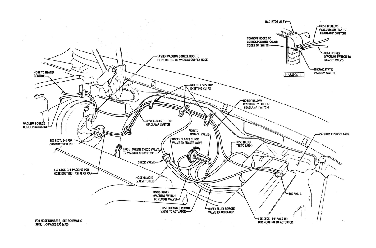

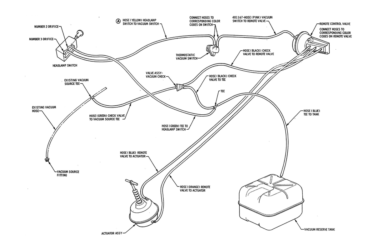

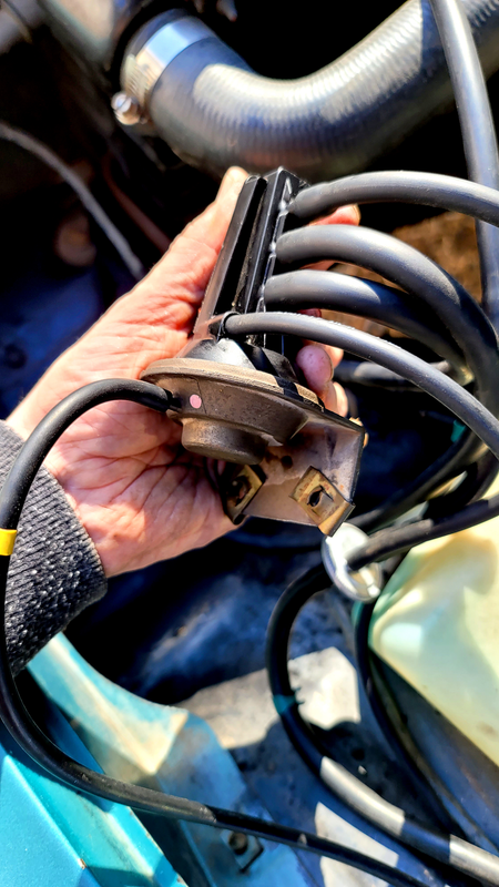

For the last couple years the headlamps have been a real pain on my Toronado every time I have needed to use them... So today I decided to replace the vacuum the vacuum lines going to the actuator and to the reserve tank. First I removed the reserve take and fished new lines through to the actuator. I was hoping this would resolve my issue, but just narrowed everything down to the control valve. Of course finding one for a 68 or 69 Toronado is close to impossible. I nervously decided to remove, clean, and oil the slide mechanism inside... Thinking if this didn't work I might try a Headlamp controller from a 68-82 Corvette Stingray. The diagrams look very similar and the control valves look almost alike. Well apparently cleaning and lubrication was all I need... I hook everything back up and now look how flawless they are working...

Nice! So did you take the vacuum piece apart, or just clean/lube the mechanical action of the covers?

Future reference: you can do same thing with the headlight switch itself.
No just replaced the hoses and then that controller that has all the hoses going into it... I took the slide out cleaned all the dirt out and sprayed it good with wd-40, wiped it down, and then put it back together... It has allot of dust inside it...
