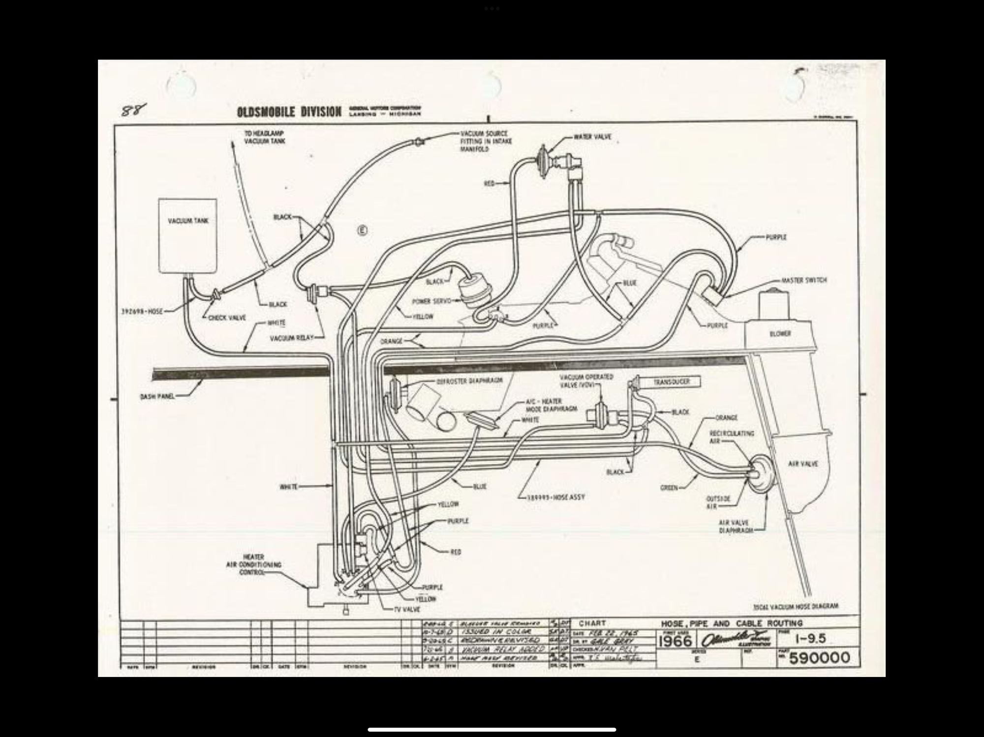

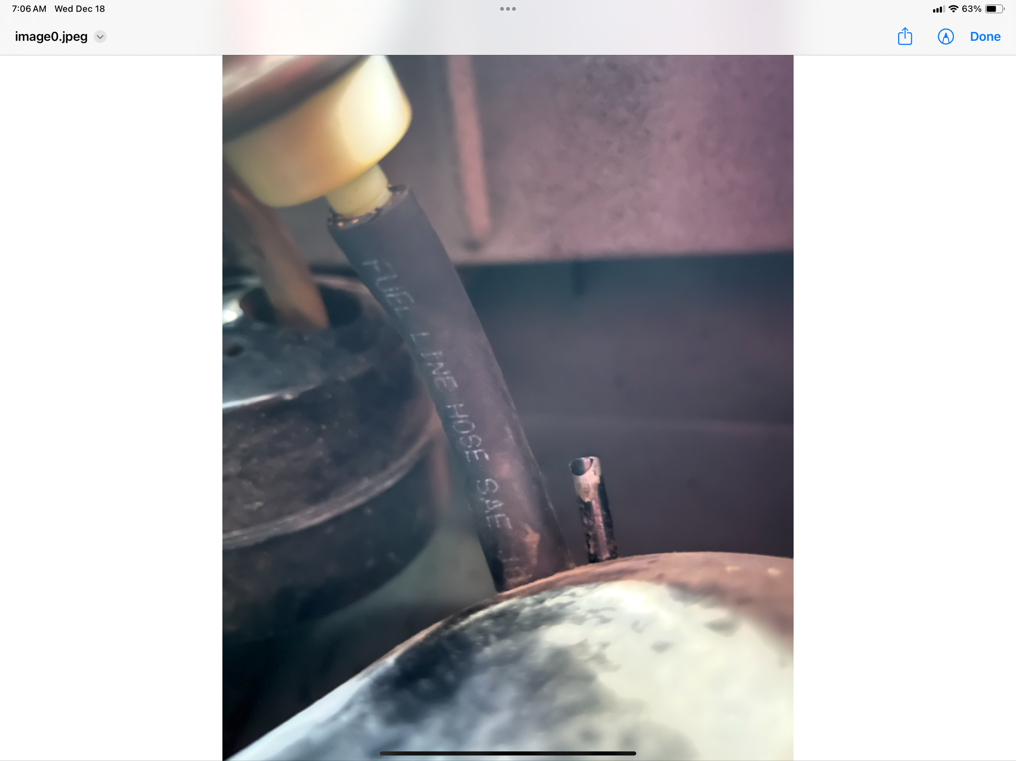

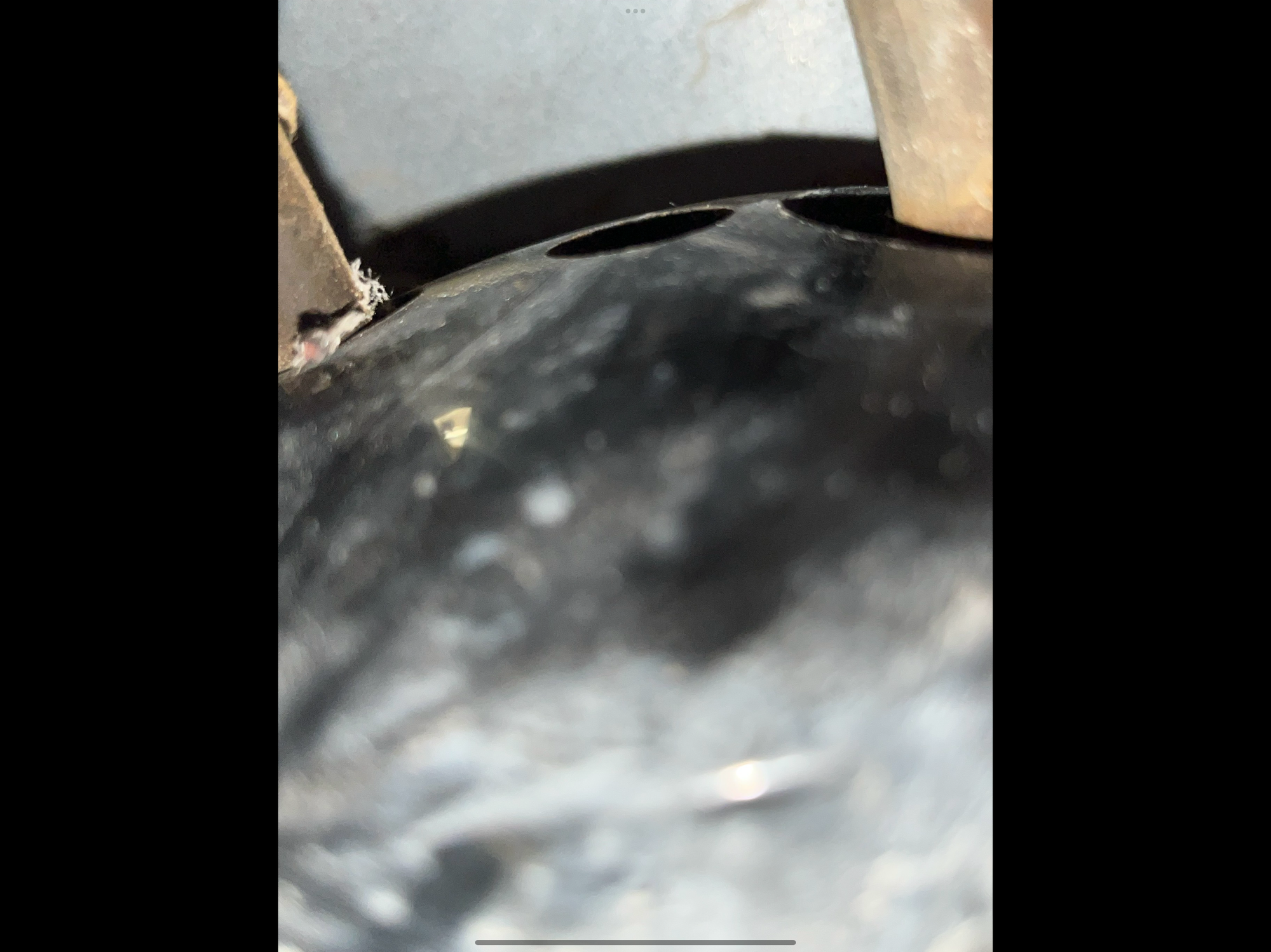

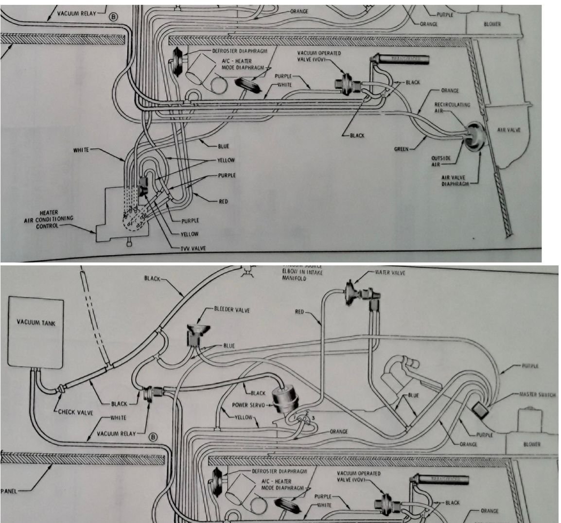

I’m in the midst of replacing the vacuum lines on a 1966 I bought a few months back. I’m struggling with the service manual manual and the files I have downloaded, see below. All of them are different in some ways and don’t match my car. I’m struggling with which one to use as they seem different in what I think are fundamental ways. Also, none of the components have part numbers on them for identification, so it’s hard to discern what is what - the vacuum relay as one example. I searched this site and the broader internet for images and such to help, but I’m not seeing anything that applies directly to my car. Any guidance on this would be appreciated. Lastly, there is a component under the driver’s side fender, to the rear of the vacuum tank that is not in any diagram that I can see. It has two vacuum lines going to it and is spherical in shape. I took two admittedly poor pictures of it, they are at the bottom of the set below. Any thoughts on what this might be? Thanks

For starters, I don't think I'd be using the '65 Comfortron manual on a '66 car. There's bound to be differences.
In your vacuum diagrams, one has four lines running off of the master switch and uses a remote bleeder valve. The other eliminates the bleeder valve and replaces the vacuum line at the master switch with a sintered metallic plug. I only have experience with the non-bleeder valve system and I know bad things happen if the metallic plug is missing.
I would put hands on a '66 Olds shop manual (Toronado section is in the back) and go by that. I would also put hands on set of '66 service bulletins. They updated things as the year progressed. I know that metallic plug is addressed in a service bulletin (or an issue of the Service Guild).
The vacuum tank in your photos could be for the vacuum trunk release.

That big thing on your inner fender is probably a vacuum reservoir. If it has 2 ports and is either metal or Bakelite plastic its job is to hold a little or a lot of reserve vacuum. To test it, use a carb vacuum plug on the small port and then pump up the big port and see if your vacuum gauge holds steady after probably lots of pumping. If it’s steady, the reservoir is sound, if it leaks down, find and plug the leak. A compressor pumping air into the reservoir while submerged in water will show you where the leak is.

Thanks for all the replies. I had the shop manual but was not looking in the back. One of the pictures I showed above was the right one and aligned with the 1966 SM in the 94 and 96 series section. I ordered the colored hose kit and replaced all the hoses in the engine bay, splicing some so I didn’t have to disturb what was in the interior of the car, as that all looked good and weirdly, original. In the engine bay, all the components were there, though not plumbed exactly like the diagram for 1966, and this was difficult to understand at first given the condition of the system and its components under the dash. Going back into the car, I traced all the tubes to each component and found them all to be where they should per the diagram, giving me confidence I was using the right routing diagram in the SM. I found a few loose connections and was able to cut the ends off of them and reinstalled to get a better connection. Some of these seemed to be plasrtic hoses and didn’t want to go on and were persuaded with a little blast for a heat gun to soften them up before pushing them into place.
