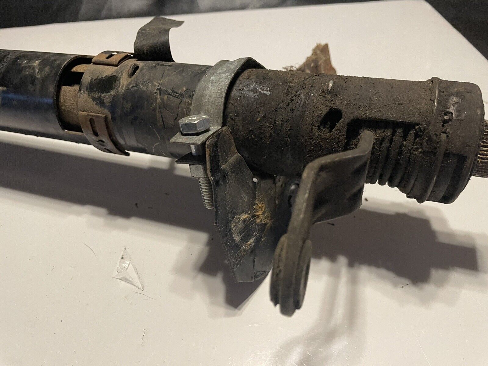

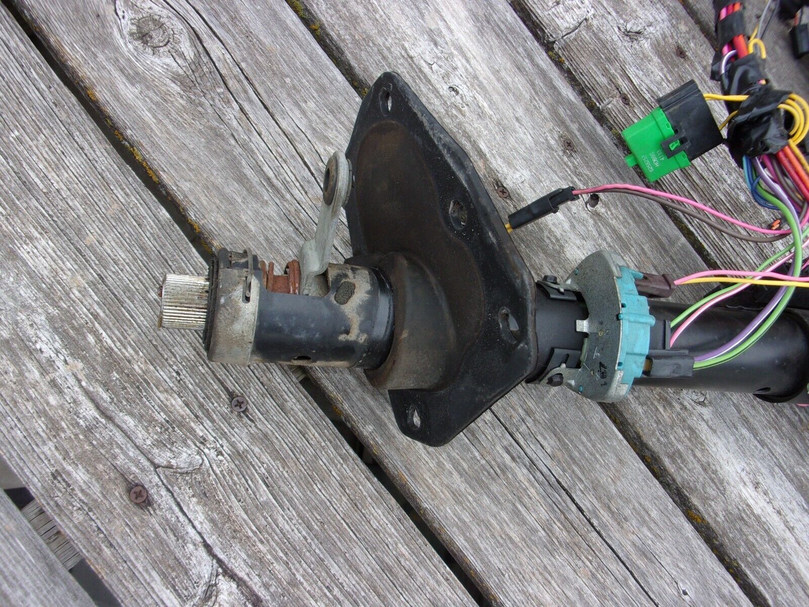

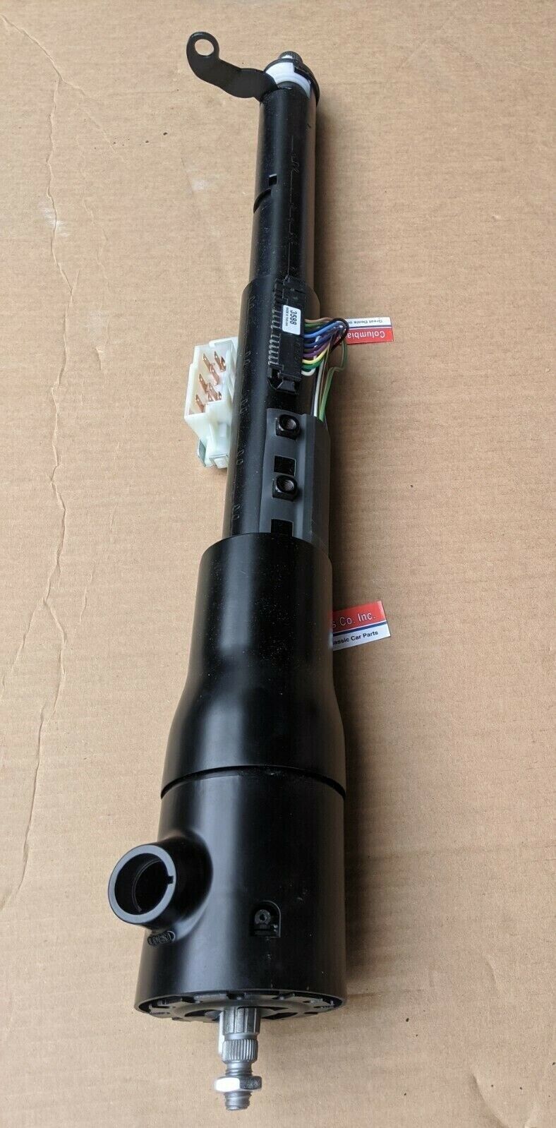

I've been collecting comparison photos of various parts for quite some time, so I figured it might be useful to post some "what's the difference" comparisons. Today's thread is steering columns. The 1973-77 A-body columns will fit the 1969-72 cars, but there is a difference, and it's pretty easy to tell at a glance.
The shift arm on the 69-72 columns is J-shaped and has a substantial offset.

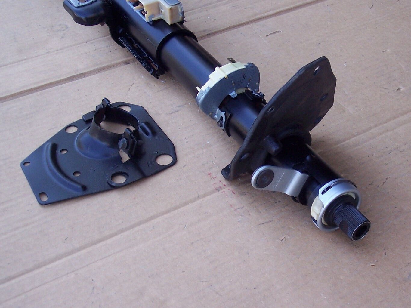

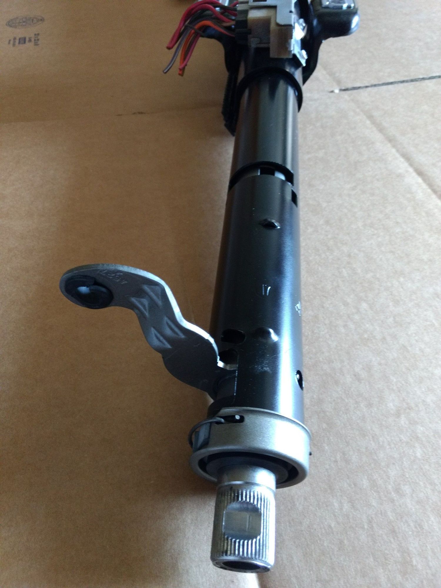

The shift arm on the 73-77 columns is straight and has much less of an offset.
