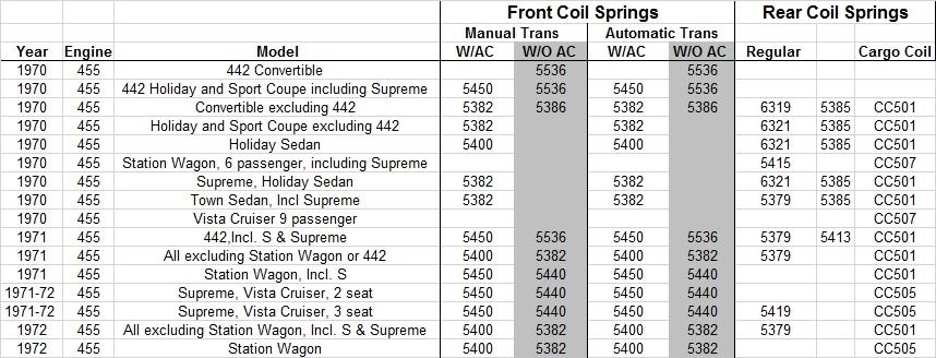

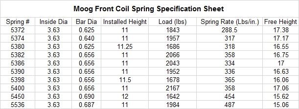

The spring rate varied depending upon the vehicle configuration, such as AC, non-AC, HD suspension, FE2, etc. I think the ride height was lower for the 442 vs the "other" Cutlass models, too.
Here's info I have from the old online Moog catalog:
