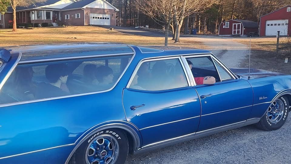

Here’s a video of her, with a full passenger load. Of course she was bottoming out when hitting bumps.

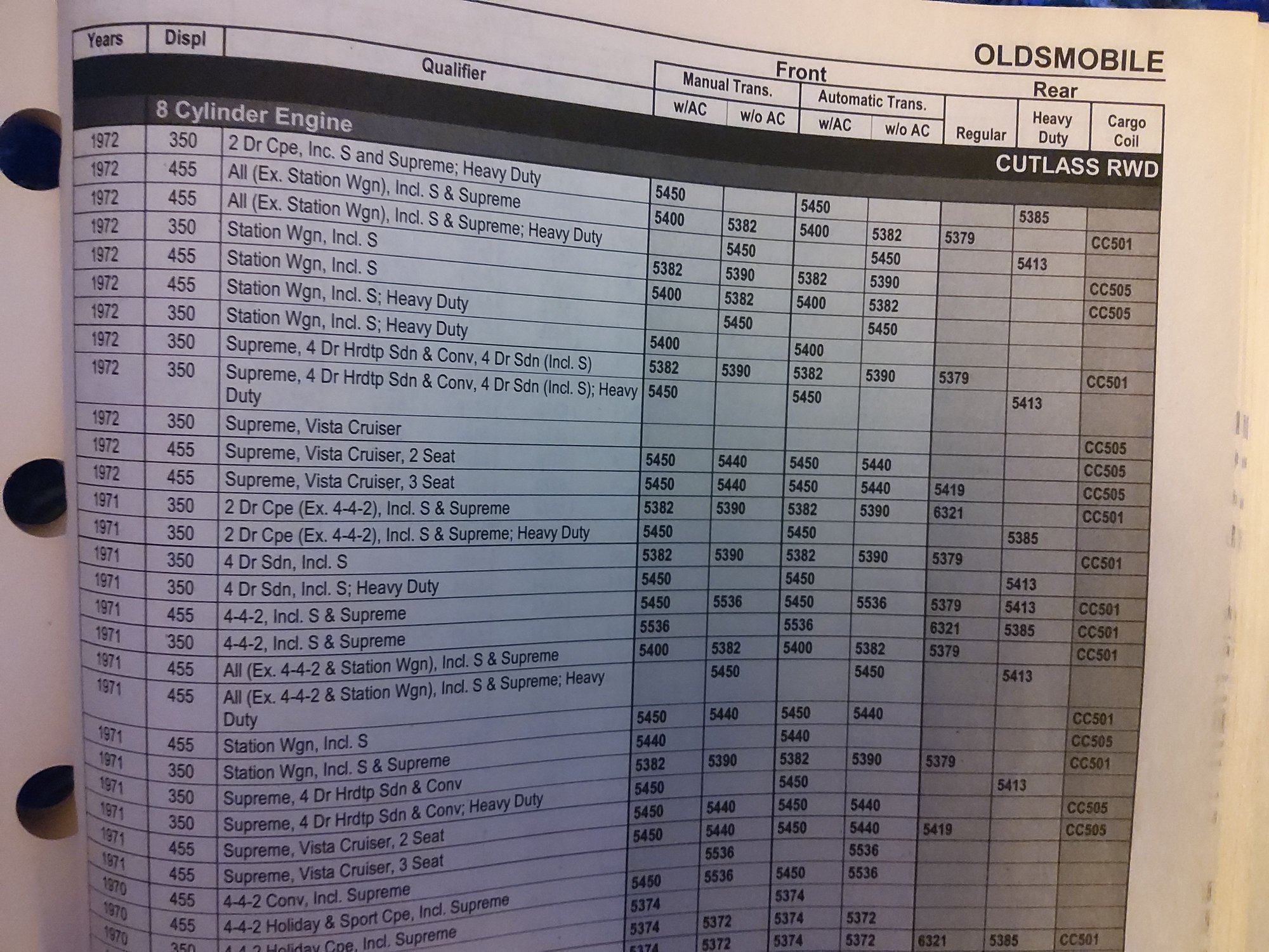

Beautiful car and looking at your pictures, I would consider replacing both front and rear springs. Changing out the springs is really easy on the rear and just a little more work on the front.
This pg will explain the difference between the Regular Springs and the Cargo Coil Springs.

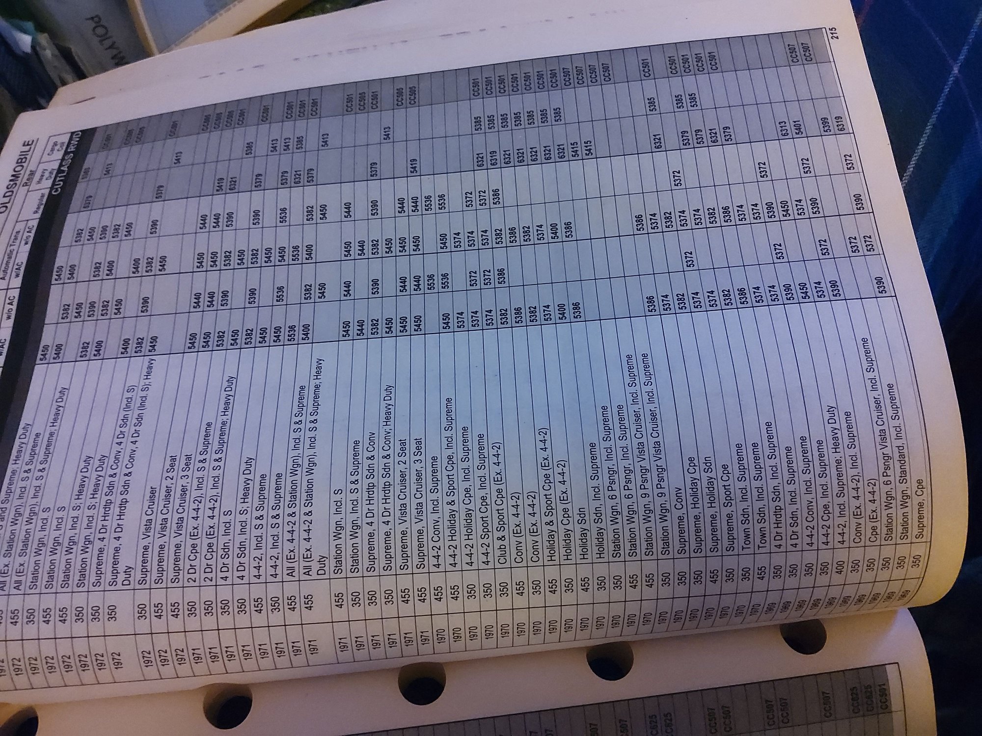

All information comes from this Catalog. The part house that I used to buy parts from was throwing them away and gave them to me.
It has everything in it as far as springs rates, installed height, Free height.

Can you post a better picture of the part number page that shows the top headings? That is great information. I have it in a spreadsheet format but a good, clear image of the page posted on the forum would be a great reference.
Here you go. If you need more send me a pm so that we won't be hijacking the post.
