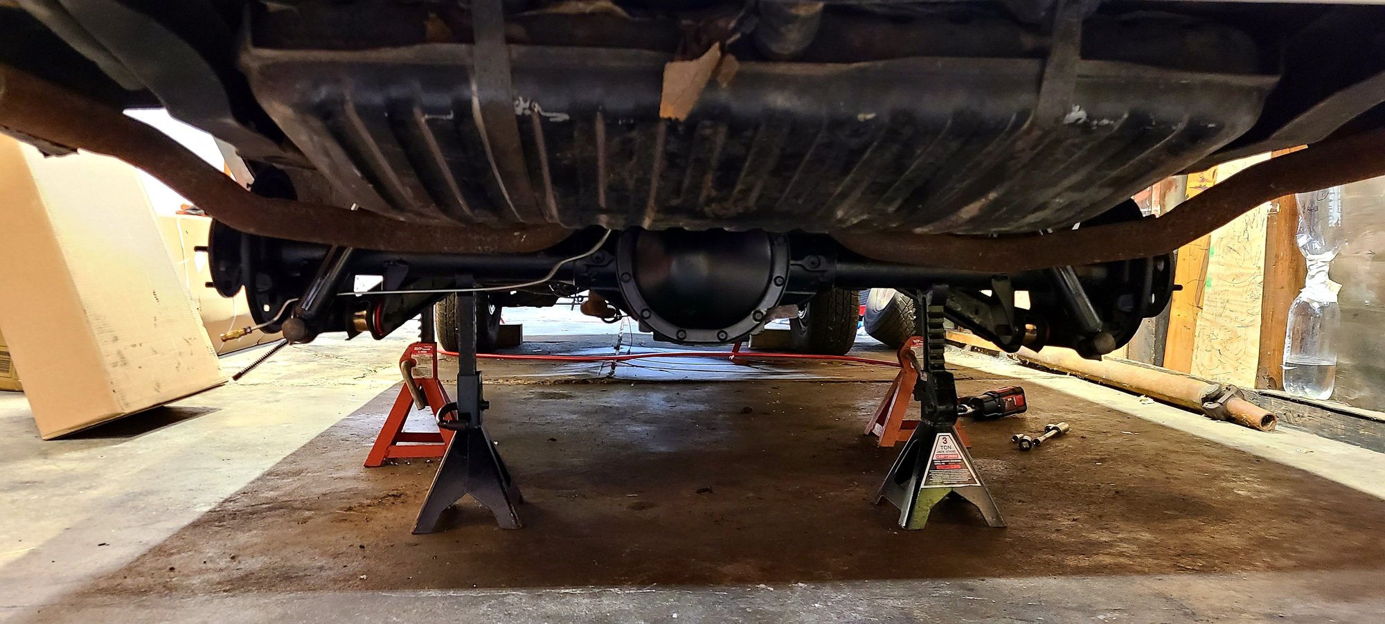

convinced the wife to not only helping with the bushings, but actually putting the axle in. Still need to torque everything down and reinstall the brakes as well as add diff fluid.. but my goal of getting it rolling by the time the engine goes in for assembly is just about there.
Old Mar 4, 2022 | 07:12 PM
  #71
Posts: 15,394
Well this is too late to help, but I always add the diff fluid before installing the rearend. It’s much easier with the rear out of the car.
yeah, I was going to then realized I didn't have any fluid. At that point, I just said screw it (really didn't want to lose my help). Dad has plenty of practice filling up a diff with fluid (2nd gen Ram problem) so I'll add rhag to the list for when he's here
