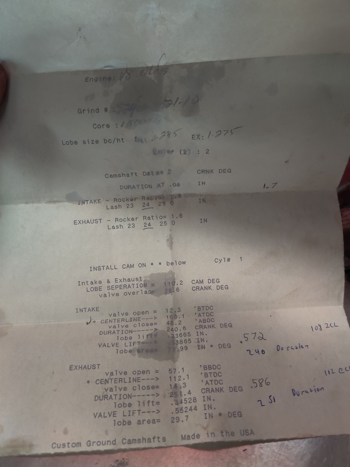

Well this build is still on track. I got a different cam with matched lifters. It's a solid engle grind , I ended up getting new speed pro Pistons because there was one that was too far gone . I dropped everything off at the Machinist . It's getting balanced the block crank and rods are all getting checked , crank is getting ground , the bores are getting opened up to have .005 piston to wall , the deck will be milled .020 . Still need a few parts but all the major things are covered.

I got everything back today !!!! I got questions lol. Nothing serious but I need to make a list to address a few items and maybe bounce ideas around ., If everyone is still onboard on this thread. And yes all clearances will be shares and what not. My machinist made me a duplicate of his notes. I was actually impressed he files all his notes from every engine he does.
