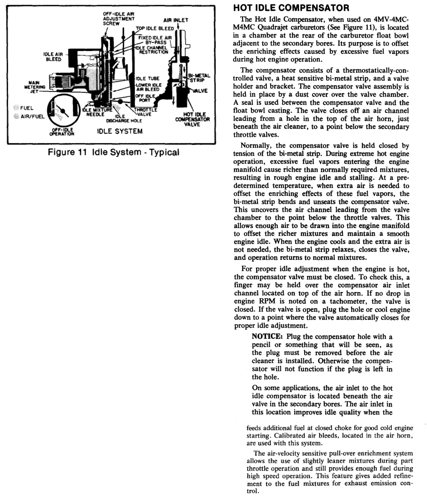

I still think I have a leak somewhere, since when I spray carb cleaner around the back of the carb it effects the idle. There's a small vertical plate at the rear of the carb. According to the manual (something to do with idle) with a spring loaded pin sticking out? When I hit it with carb cleaner it changes the idle. Not sure if it's meant to or not.

The thing on the back of the carb is the hot idle compensator. A bimetallic strip in the mechanism opens an additional air inlet when the underhood air is hot and less dense. It's possible that the gasket on it has deteriorated.

^^^^ This^^^^
Certainly the rebuilder should have replaced this gasket. It is a small cork-like composite gasket in most kits. Again, talk with your carb guy to know what he did; not all rebuilders are created equally.....

Thanks Joe, for the blurb on the Hot Idle Compensator. I'll run that test next and see is it's malfunctioning.

Not that I think your rebuilder needed to see your carburetor on your car, but in my opinion, he sure needed to test it before he returned it to you, which he may have done, or not. If shortcuts were taken and if gaskets were not replaced, like Joe P. indicated, any overlooked gaskets could be dried and dusty at this point. Your test indicates a leak at the rear of the carb and it very well could be a fault at the compensator, or other anomaly.
