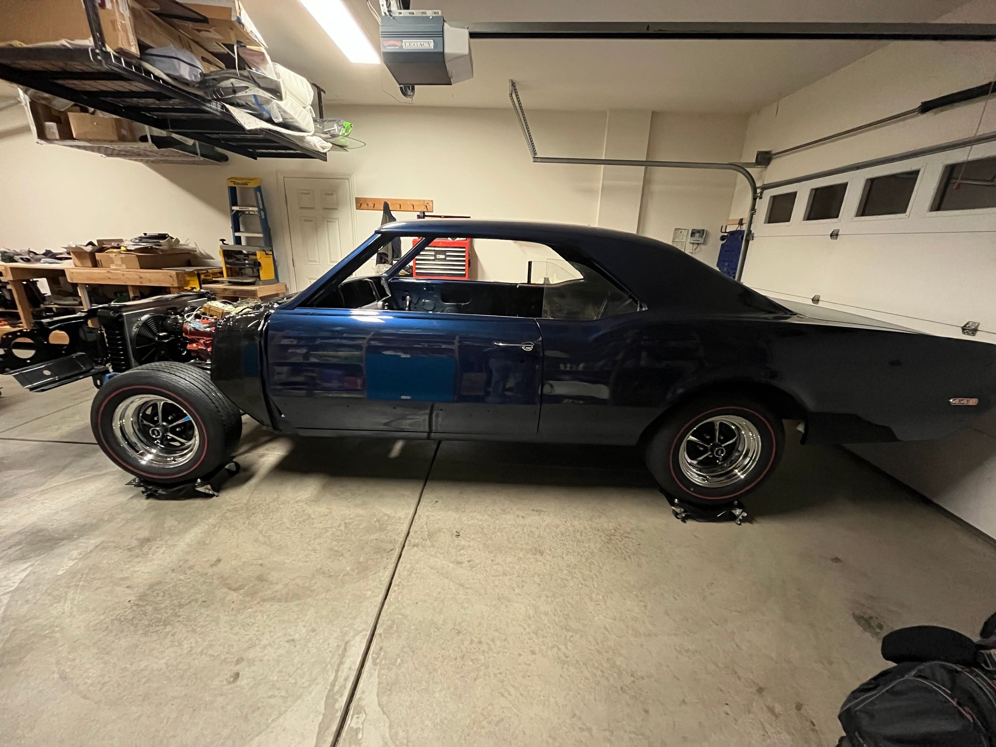

That's a beautiful blue. Is it viper blue pearl?
Old Dec 20, 2025 | 08:55 AM
Taz54904's Avatar
Joined: Jan 2024
Posts: 207
From: Oshkosh, WI
Thank you! Honestly, I wish I knew what blue it was because it has been a pain in the a$$ to find touch up paint for it and one of the previous owners never documented what color they painted it. It is more on the darker blue spectrum, with some metallics and possibly some pearl too.

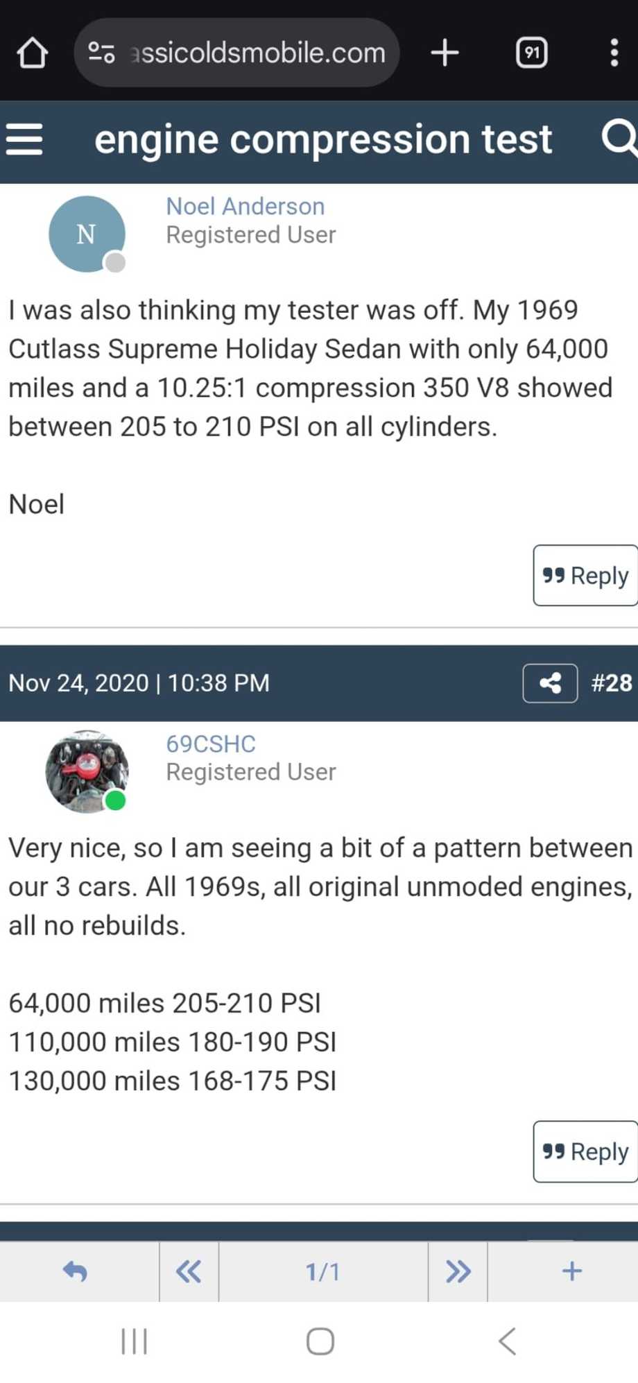

Russ, sounds great, runs great, looks great.
Compression numbers are excellent for low comp. Plugs look very good for 2800 miles of usage within a total of 128,500 miles, on the engine.
Here are high compression numbers for lower and higher mileage.
https://classicoldsmobile.com/forums...on-test-79166/

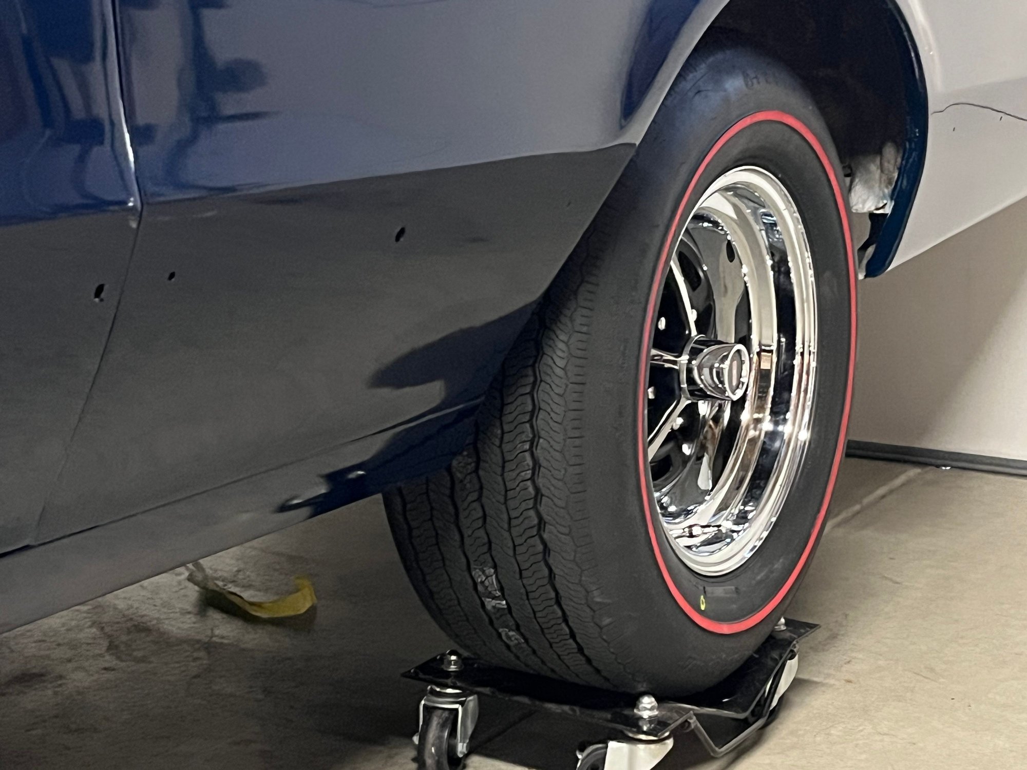

Nice work, I noticed it sat in a different location but couldn't make out the interesting rerouting. Neatens it up beautifully.
TOC and Fleming442 made great suggestions on color, I've been working on it since Fleming mentioned it. But very difficult to match, definitely close to viper pearl blue. But your color seems to have a touch more purple to it...
This is the closest to a match I have come across. Chevrolet Targa Blue Metallic | 979 / 927 / 4282 | 1972-1973 | OEM Bas
Here is a picture off of computer screen image, your car is on top. Its the door pic from the above website. That picture in particular seems to have similar lighting to your pic. Unfortunately the pic is not downloadable, this was the only way I could capture it.
The door is open, I'm sure that alters lighting slightly... Also the reflection of photographer is darkening the blue a bit.

Thanks Phil. It took a little while of staring at things to figure how to route it.
That blue you linked looks pretty close. I agree mine does seem to have a little purple (or red shade blue) in it and it seems to be a touch darker than the link but still that's pretty close. When I take in my part to get matched, I will have to tell them about that paint code. Thank you again.

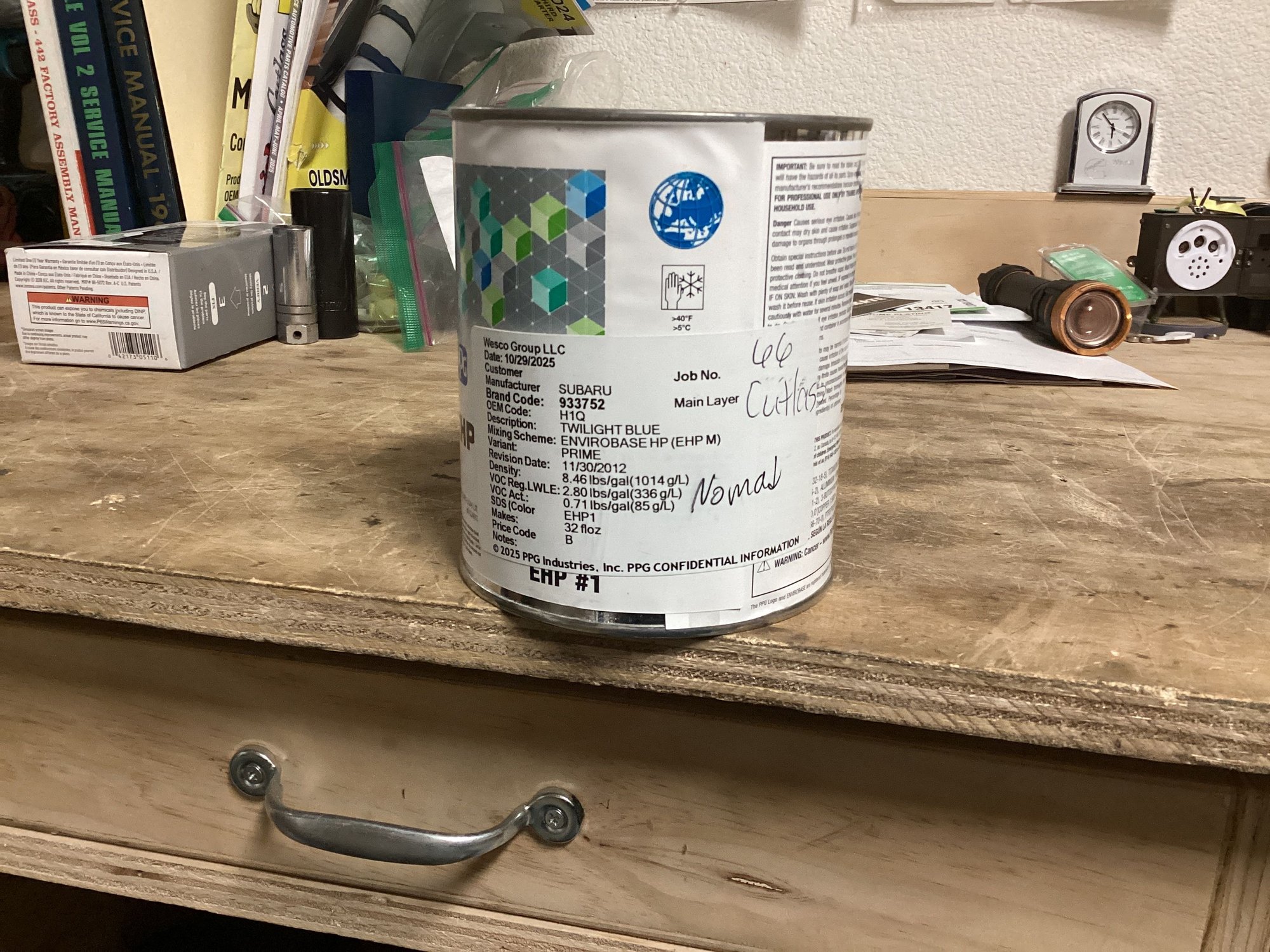

Russ, here’s a pic of the leftover paint from my body shop………looking at it, says it’s a Subaru color……hmmm!
Old Dec 30, 2025 | 01:19 AM
Taz54904's Avatar
Joined: Jan 2024
Posts: 207
From: Oshkosh, WI
Thanks, Tom. That doesn't surprise me because in a previous life, I used to work for a local paint store and I would color match paints for body shops. Sometimes having to look through DuPont books to find a color that a customer wanted that wasn't the same that was on their car/truck.
Earlier this year, I was helping to color match my car and the closest we got was a BMW blue.
