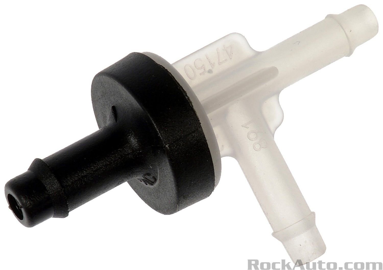

Because that's not how you connect the single port vacuum ball. You need a check valve with a tee connection. The inlet to the check valve connects to the manifold. The other legs of the tee fitting connect to the vacuum ball and the HVAC. Note that this will only help your HVAC operate under low vacuum conditions. It will NOT help if your brakes don't have enough vacuum.
This is the valve with tee fitting. Dorman 47150. Black goes to the manifold, one white to the vac ball, the other to the HVAC source hose.
I think I could rob that check valve off the 307 I pulled outta there. I only experience problems with braking when the ac is on.
