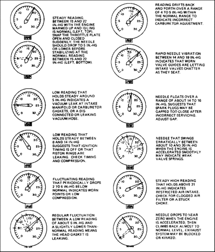

(3) Adjust A/F mixture screws (performed w/ a vacuum gauge) to highest achievable vacuum. Adjust each screw one at a time until the highest vacuum is achieved for each A/F mixture screw. A stock 350 Oldsmobile engine should achieve a vacuum of ~17"Hg.

Maybe I should have (also) highlighted the importance of measuring vacuum because you do, in fact, bring up a valid point e.g. deteriorated base gasket can rob vacuum. Vacuum hoses are inexpensive and critical to supplying and MAINTAINING the proper A/F mixture (ratio) throughout the vehicle's drive cycle as well e.g. idle, cruise, acceleration & WOT. Cracked/Deteriorating vacuum hoses can rob vacuum, as well. When reading the vacuum gauge ensure you have a "steady" reading (~17"Hg).
