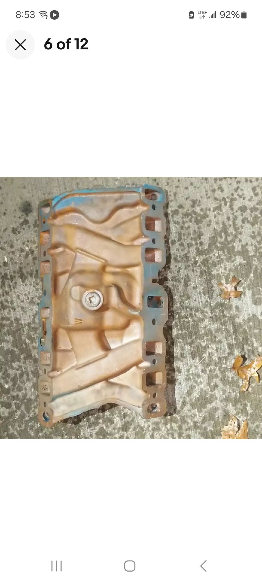

Here are a few pictures of what i did. I remember calling Morel and asking about grinding the rivets and they were ok with it as shown.

The last pic I saw of someone trying to make a 2711 work, it looked like they needed to grind on one of the runners as well? Just asking.
Old May 1, 2024 | 06:59 AM
BillK's Avatar
Joined: Dec 2016
Posts: 1,979
The only picture I have of the bottom of the intake looks like I probably ground off the crossover passage if anything. I dont remember if I did that because of the Turkey tray or to clear lifters.

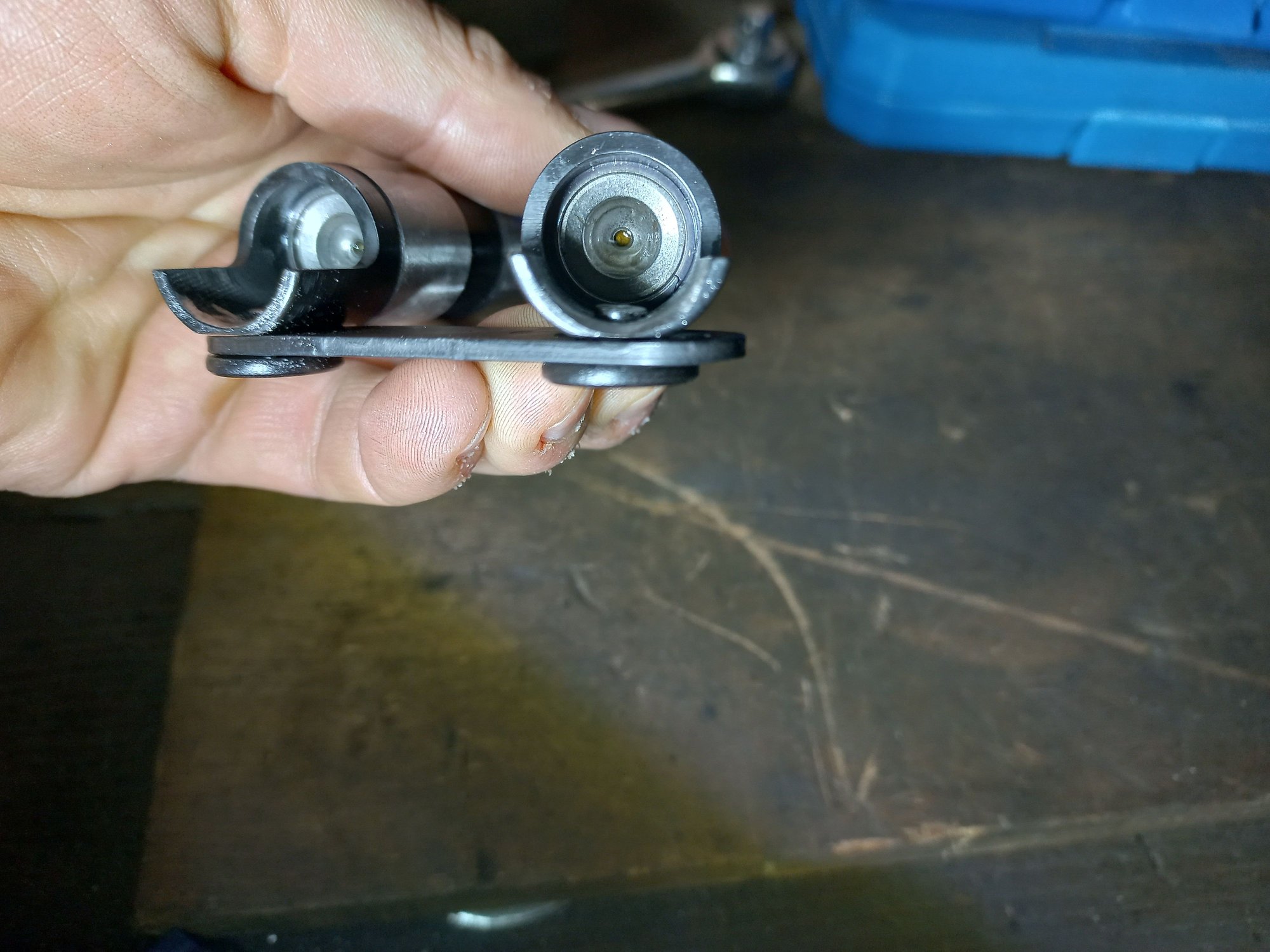

So, I tried to grind lifters of cylinder 4 and....
It works !!! There is no more problem when flipping lifters and using 3/8 pushrods.

Glad you got it to work Looks like you did not even have to grind the rivet like I did. Did you check it at full lift ??
Just wondering why you are using 3/8 pushrods ? Really not needed.
A lot of times Summits pictures are generic pictures. That's why I never go by their pictures or listen to their tech people.

Many thanks to you. Honestly, grinding the lifters went through my mind but I was not bold enough to do it. Seeing your picture was very instructive and gave me trust to try.
I've slightly ground the rivet.
And yes, I tried complete lifters movement with rocker and pushrod, preloading lifter, full lift, etc.
I'm using 3/8 just because I thought it will be better when beefing up my 403. I've switched 4a heads by a pair of 6 ones, rollercamshaft, roller rockers, Edelbrock intake and carb (800cfm), exhaut manifold/4in1 by Thornton...
Wanted to do things as best as I can.

Let us know if those lifters rattle. I went through 2 sets of Morels and they were louder than the solids I have in the car now. I'm not saying this to start trouble. I'm genuinely curious if they fixed the issues that they had going on.
Ok, I'll tell you my feedback. But these are not Morels => I guess that you've noticed I use Comp cams lifters. =)
Old May 11, 2024 | 06:57 PM
  #32
olds_freak's Avatar
Joined: Nov 2013
Posts: 128
From: Michigan
Boy is my face red. Those look just like them.

Old Aug 14, 2024 | 08:31 PM
  #40
zoner2328's Avatar
Joined: Aug 2024
Posts: 1
Mondello garbage
Glad I found this.been having g the same issues putting a 403 together. 3/8's push rods won't fit thr mondello heads with a roller cam. The 5/16's still rub the push rod hole. Going to elongate it up until today I was going to mill the bottom of the intake off to clear the lifters until I went to fit the intake. The head side of the port barely seals. The port is to tall and there isn't enough room on the intake flange either.. I still have to mill the gasket surfaces to get the bolts in. My question is does the 7111 intake have a taller port or am I stuck with welding the head to fill in the area for more gasket surface?
I bought everything from mondello thinking they build these things all the time and i can get what should work. Nope its been a fight. I have no problem making changrs if i know ahead of time. There's been no contact from them since mid July.
I ordered push rods from them in late may never received them.it takes a week from Cali to Pa. Called for 3 weeks got the runaround ben busy short handed we'll get them right ouut and I'll send you a tracking number. Never got it called all week of the 4th no answer or call back. That Friday the phones were disconnected. Two weeks later back on was told I'd get a refund email for the push rods never got the refund or email..
Think long and hard before doing business with MONDELLO PERFORMANCE
Any input would be appreciated and thank you everyone for your time
