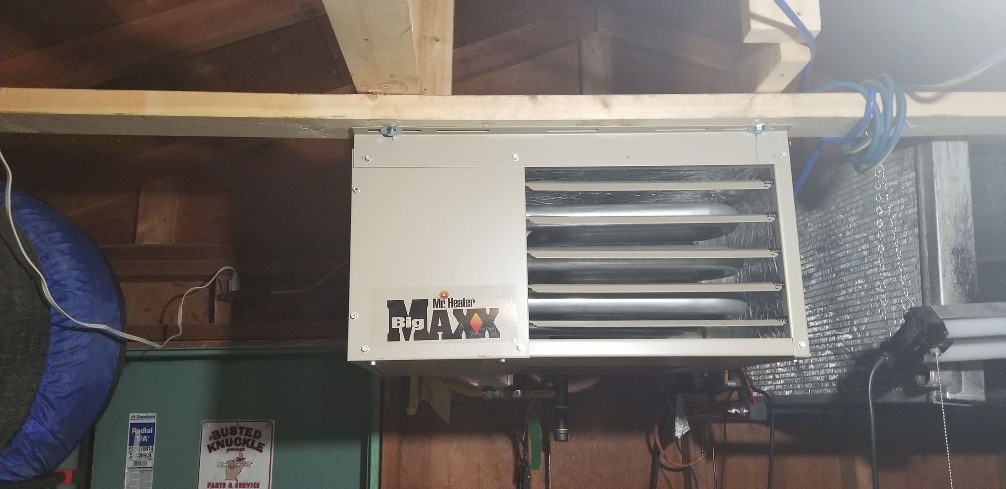

Sorry, my mistake, add $300 for the Google Nest thermostat, best one I have ever used by far. I can turn on the heat in my garage from anywhere with the simple app. I am draining the coolant out as I write this. Pulling the top end of this week after work and this weekend. I plan on contacting Parkland Engine Builder's next week to see what their return times and costs are. The 350 block needs bored an honed .068" over, clean up mill on the deck, new cam bearings and an align hone on the main with the ARP studs and 1/2" 4 main halo installed. The 3.5" stroke was offset ground by Ohio crank to Smitty's clearance specs. It will need balanced along with the 403 pistons pressed off and new Icon pistons pressed on for the second round at the machine shop.

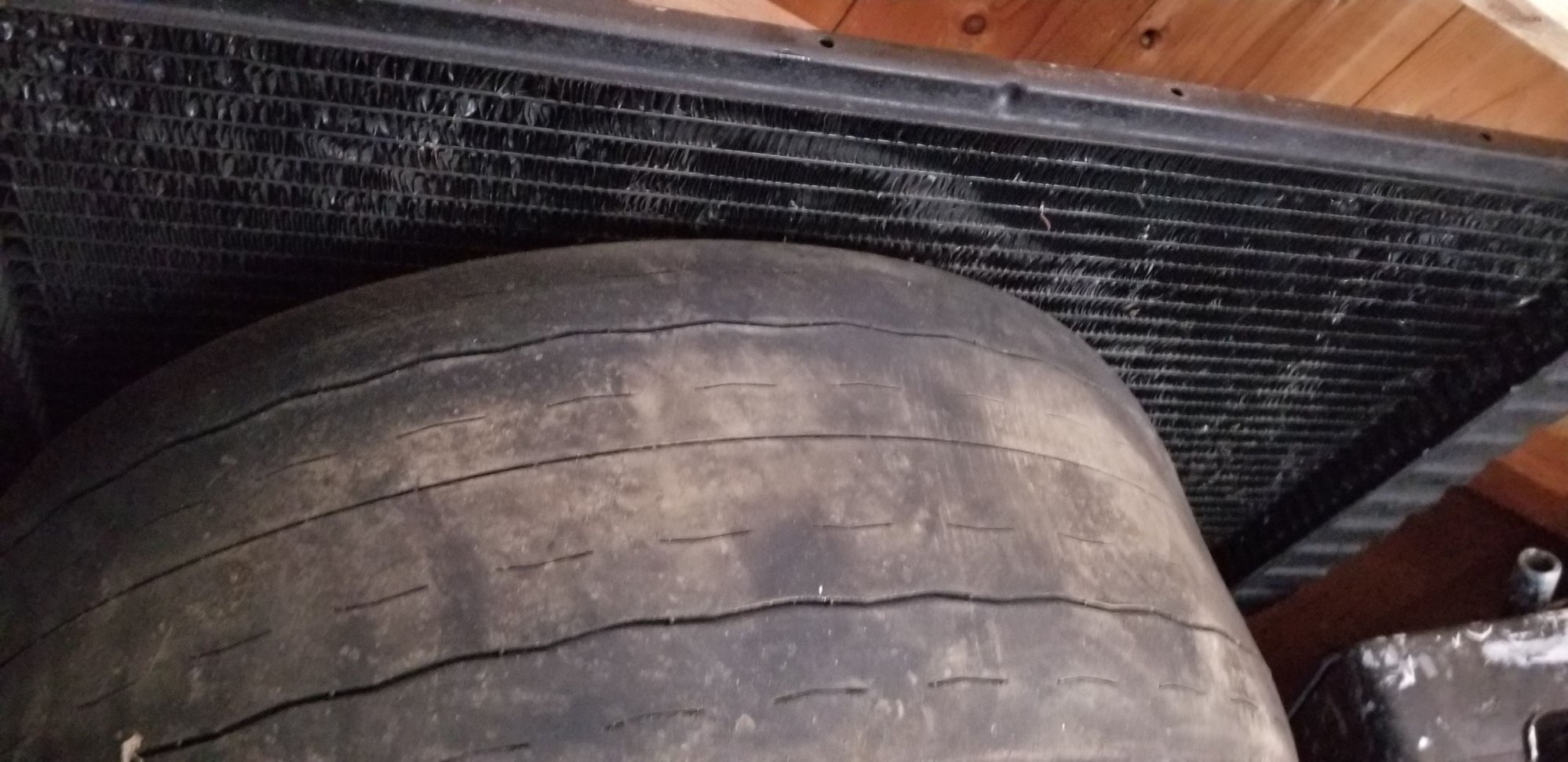

Rad drained and stored on top of my racing slicks, won't realistically need them till 2022. This was the factory 2/3 core rad recored at some point. They only used 2 cores, so cooling is marginal at best. I have a plastic/aluminum 1 core A body replacement that never went more than 10 degrees over thermostat temperature. It should cool the stroker just fine. Another reason to not go with the 403, the rad needed to cool it would cost around $500, nearly pays for the pistons. I am also shelving the 4 blade direct drive fan. It cools very well but has to be a power and mileage robber. I have Plymouth Breeze electric fans, they move a lot of air. I am going with the Davies Craig controller, all the rest I have used are junk. The most important part, I discussed taking my block to the machine shop with my Wife. I haven't been Married as long as I have without discussing this with my Wife. She didn't say no, so full speed ahead.

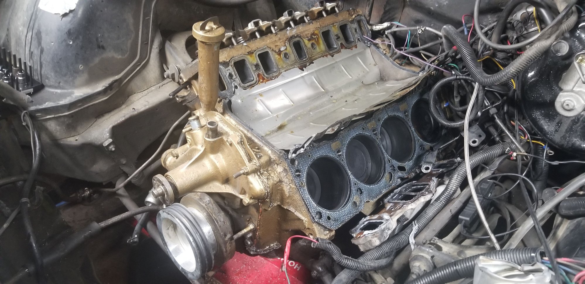

Getting it pulled down.

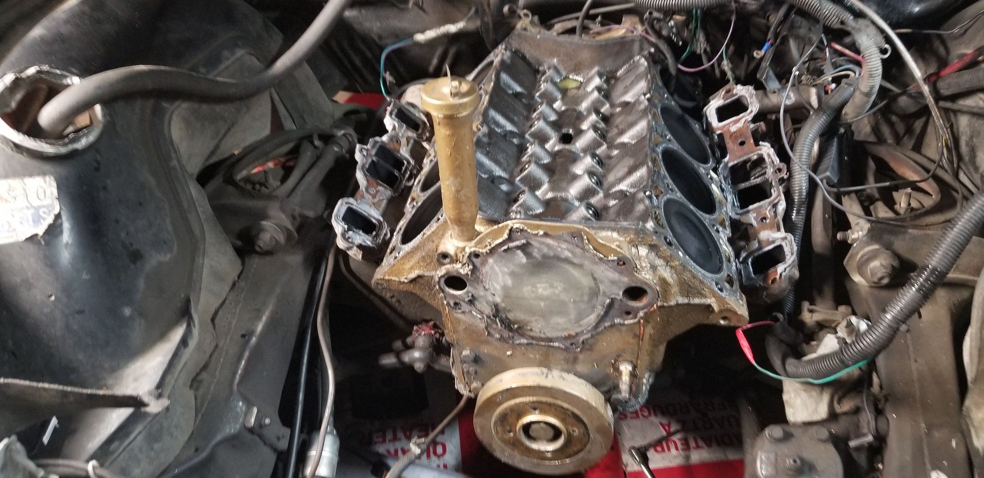

A couple of steps closer.

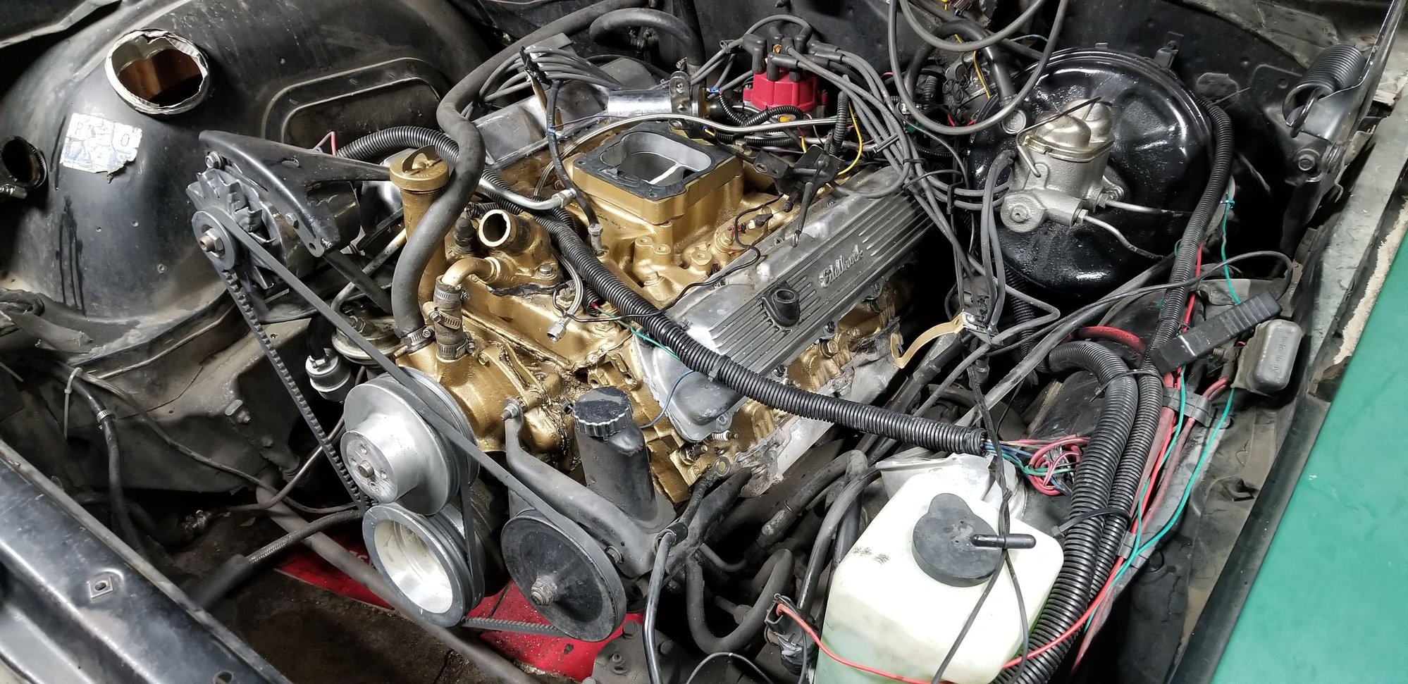

Ready to pull.
