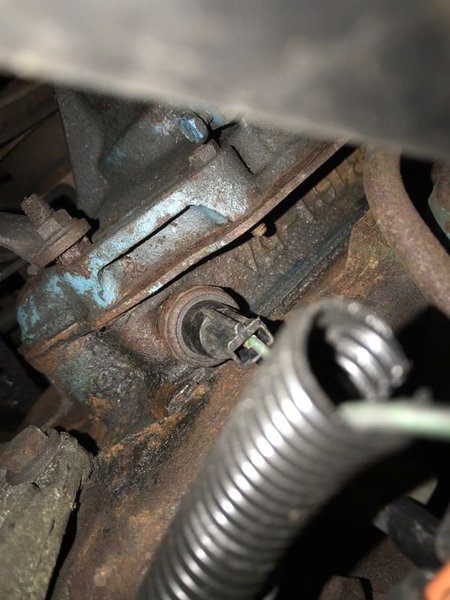

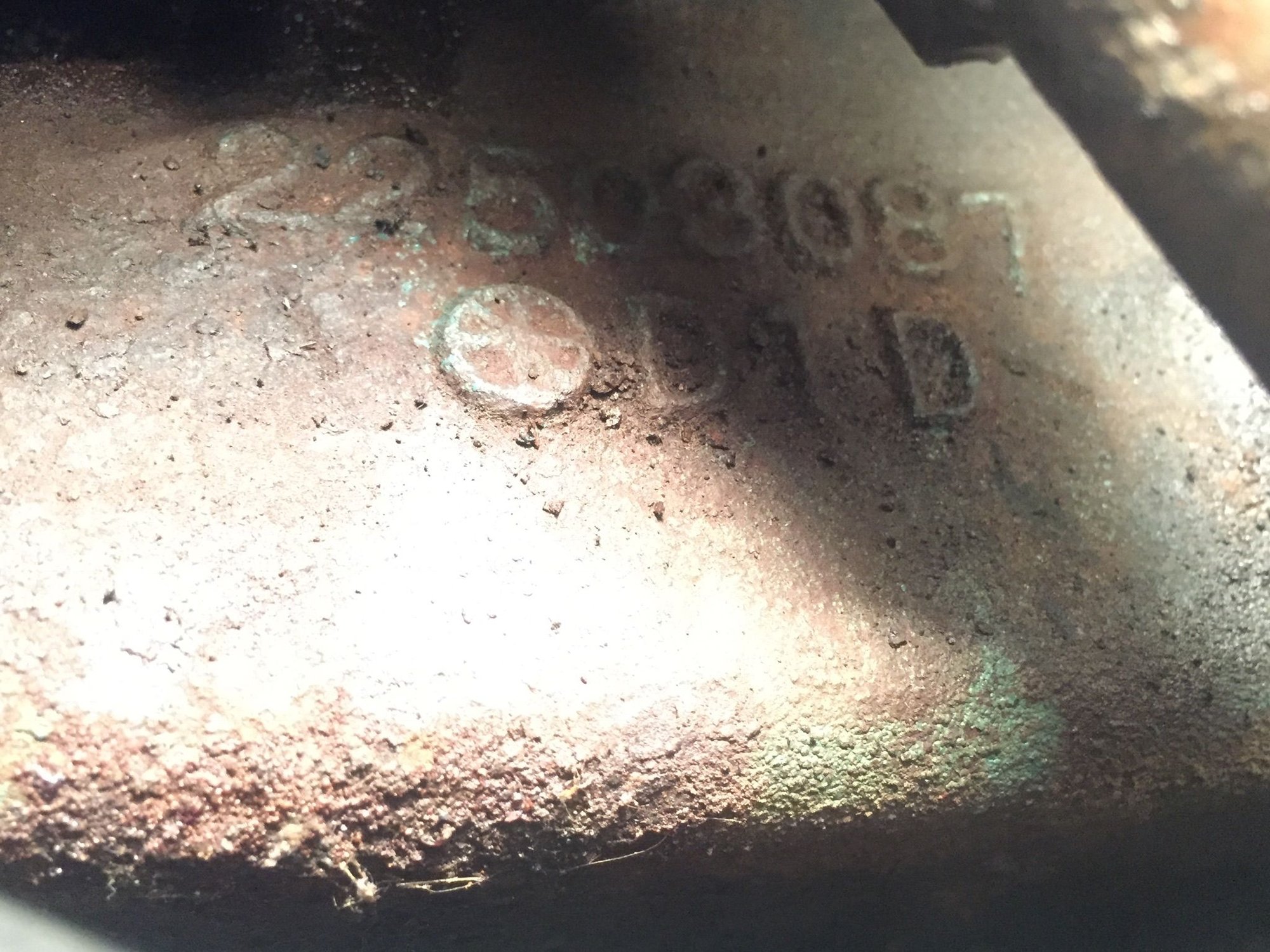

My VIN shows a 368 engine (cadillac I suppose). I know that I have an olds, on the intake manifold, I can read 22503087.
Same indication on the sump’plug. I think it is a 307.

Your Olds engine should have three groove pulleys, as I think you suspect. I'm guessing that whoever swapped the engine cobbled together parts from the original and whatever donor car they used. Unfortunately, without knowing exactly what was done, it's difficult to know what is correct and what isn't. Olds used three different length water pumps and the brackets and pulleys need to match the pump for everything to align properly. Likely the easiest thing to do is to get a complete set of brackets and pulleys from an Olds 307 as a matched set, or at least provide more detailed photos so we can tell exactly what you have. Those pulleys look like they've been in a lake for a while!

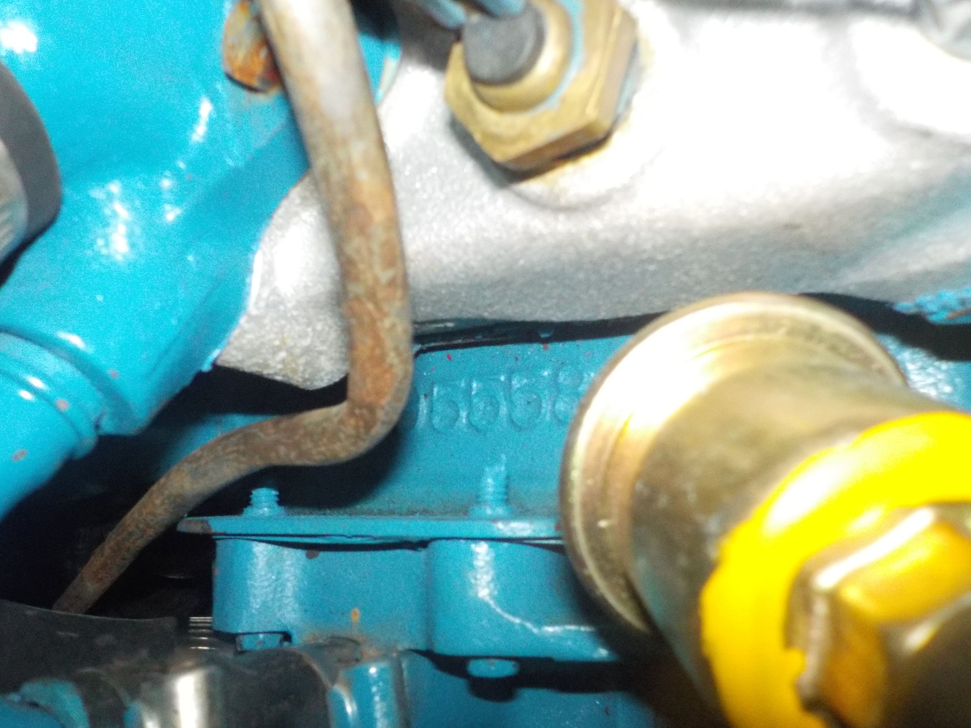

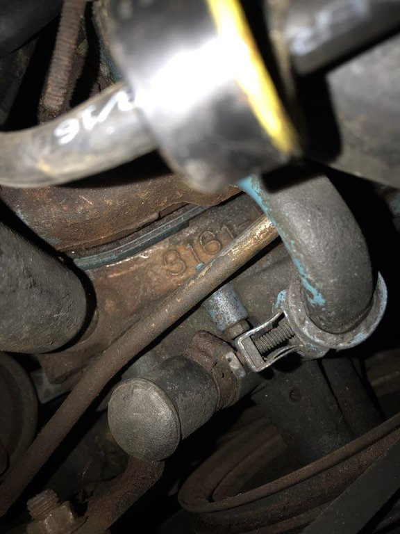

Also, you need to find the BLOCK casting number, as shown in post #5. That will tell us exactly what Olds motor you have. Look above the water pump, next to the oil fill tube and below the thermostat housing.

I can see from those photos that whoever installed that motor didn't use the correct spacers on the power steering pump bracket, so that's definitely part of the belt alignment problem.
Unfortunately this photo is small, but the water pump pulley needs to have three grooves. Innermost groove drives the A/C compressor. Middle groove drives the PS pump. Outermost groove drives the alternator.

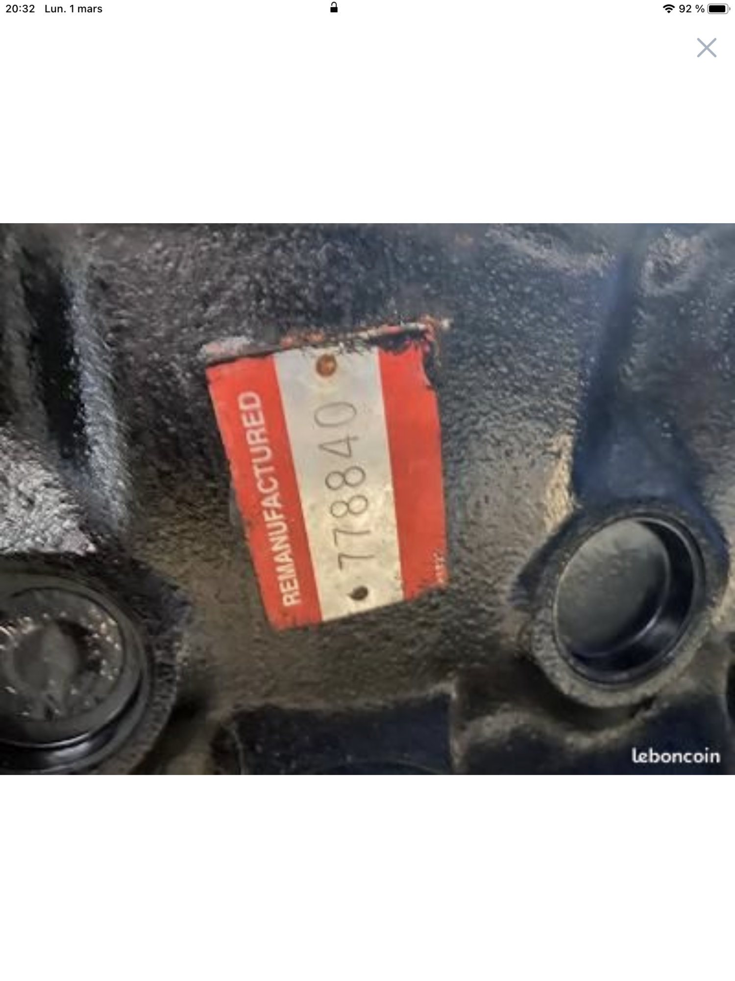

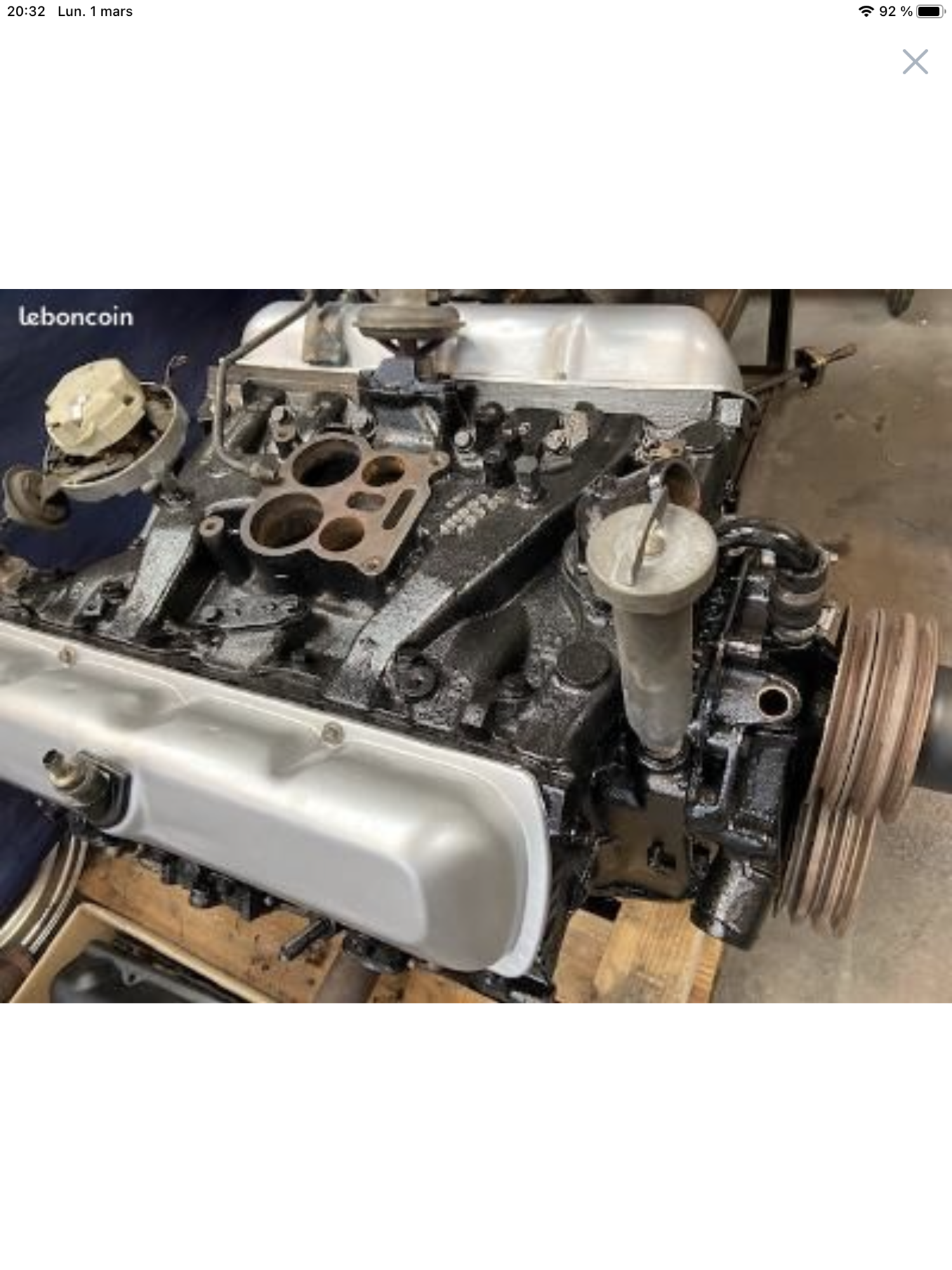

Now That I am sure I have a 307 olds engine and probably in bad condition (with pulleys problem because I have only two groves instead of three) , I am considering buying a 350 olds and making a swap.
The 350 is a crate engine, with a 557752 3B case, herebelow are the pictures.
The engine is almost new and the price is low.
Does anyone know if the swap is easy ?
In a way, I thought the swap from a 307 to a 350 should be straight forward...even if initially the fleetwood had the original 6 liters.
Thanks for your help.

The swap is super easy. That is a windowed main 350, hopefully it is close to the factory 8.5 to 1 compression. They probably used 24cc dish cast pistons in the remanufacture of that motor.

Well, that definitely makes this motor more desirable, especially if cheap. Everything from the 307 is a direct swap, he should not need any parts unless some of the parts are worn out on the 307.

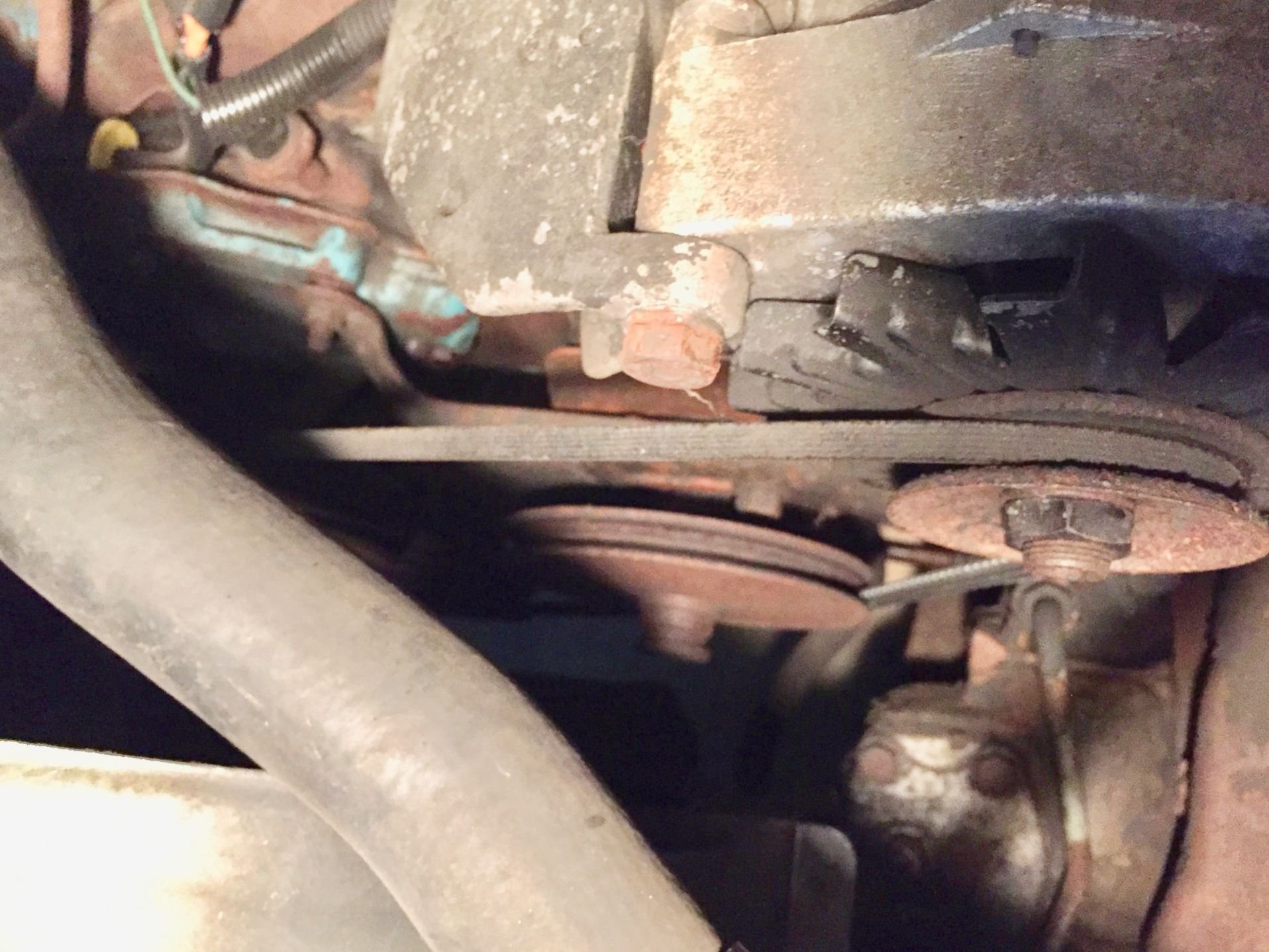

that is the routing i was thinking of,your alternator doesn't look like it lines up with the p/s pump and it shouldn't for the set up in your last pic.i will check tomorrow for the pulley

Hi,
Thank you.
Currently, there is one belt for water pump, p/s and alternator, but it is a non sense. The p/s pulley does not really rotate.
Here is the situation (see pic).
It could be great if you have a wp pulley.
thank you.
