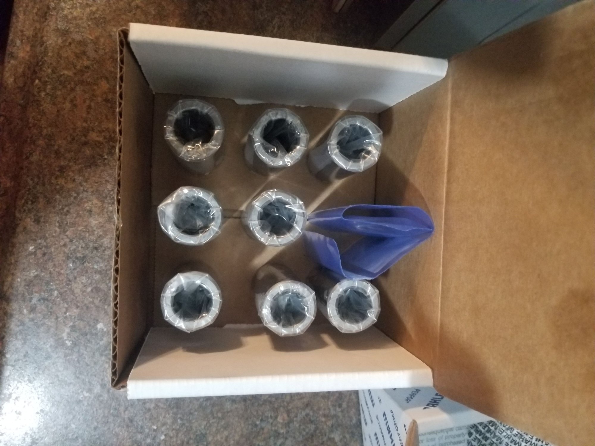

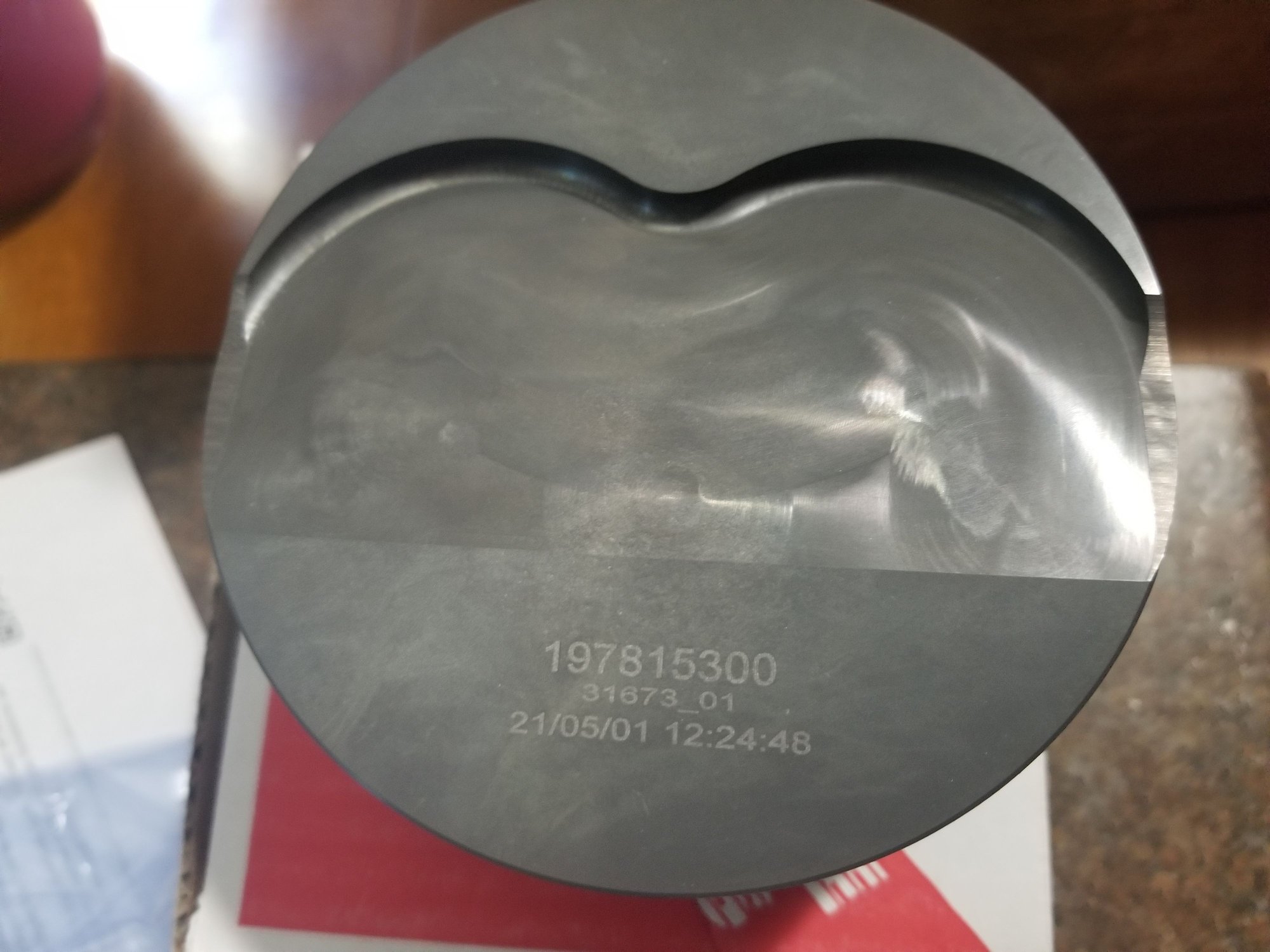

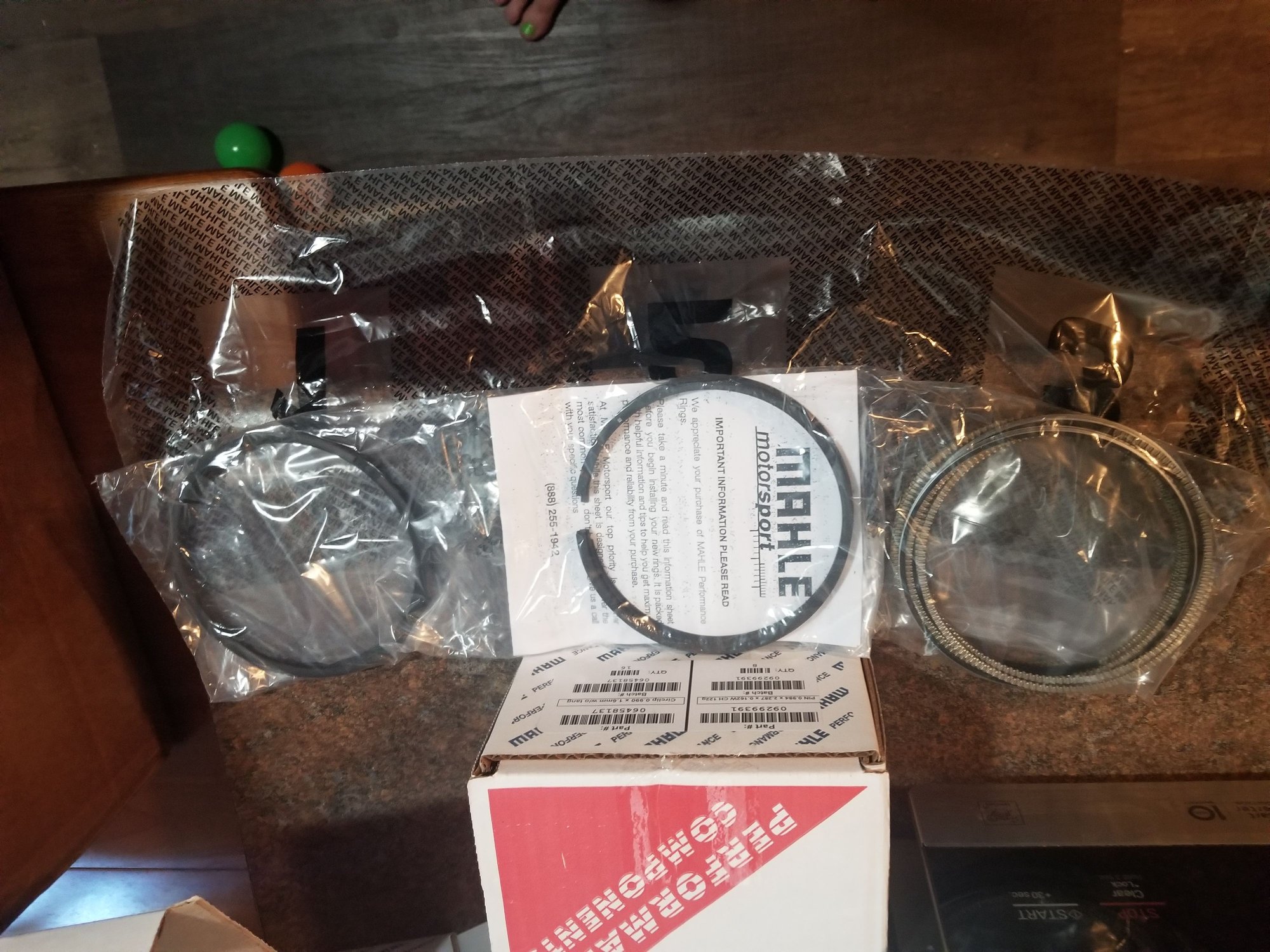

Top pic should be what you are after. The rings are file fit FYI. Along with the new Scat and Molnar rods, these bring the Olds 350 to another level. You will be mid 9 to 1 compression, give or take. My block needed a .016" cut which will put the pistons .003" above deck. The Felpro head gaskets being .042" compressed thickness, .039" will be close to perfect.
