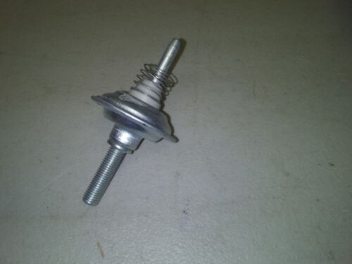

It should fit. This is what my current dashpot looks like (photo not mine). My bracket is mounted in holes cast in the intake. For 30.00 I'll give it a try.

Ah, if you want to bolt something in place of the dashpot, yeah, that one might work with the dashpot bracket. That long nose might actually be too short, so you might need to add something to the end of the actuator. Or not.

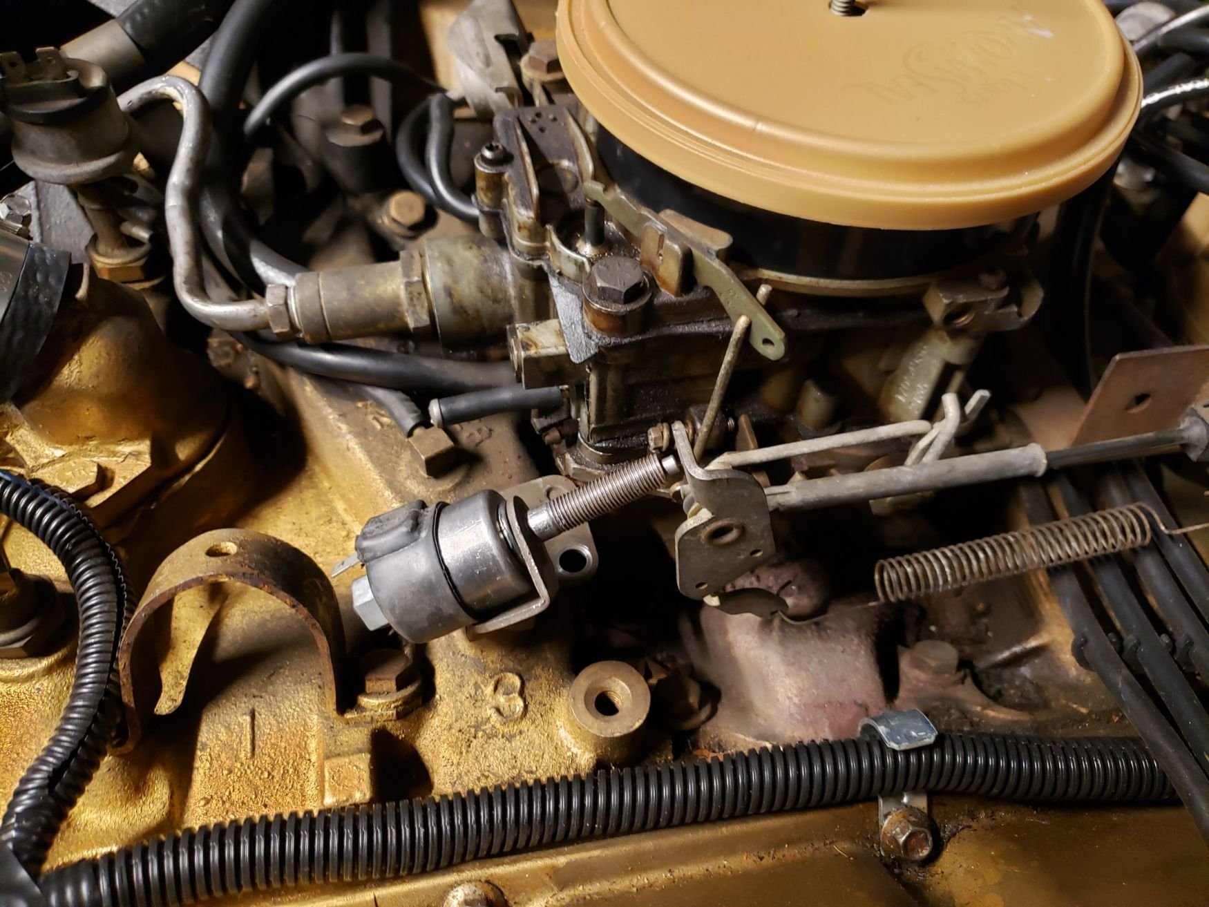

I have the bracket adjusted & ready to run the wire to the clutch circuit. I just wondered whether this is a constant duty solenoid. It will have constant power when energized. I assume this is OK of course. Correct? It won't burn out? Here is a rough fitting. I still need to attach it solidly & fine adjust the speed when it gets warmer & I can run the A/C compressor.
