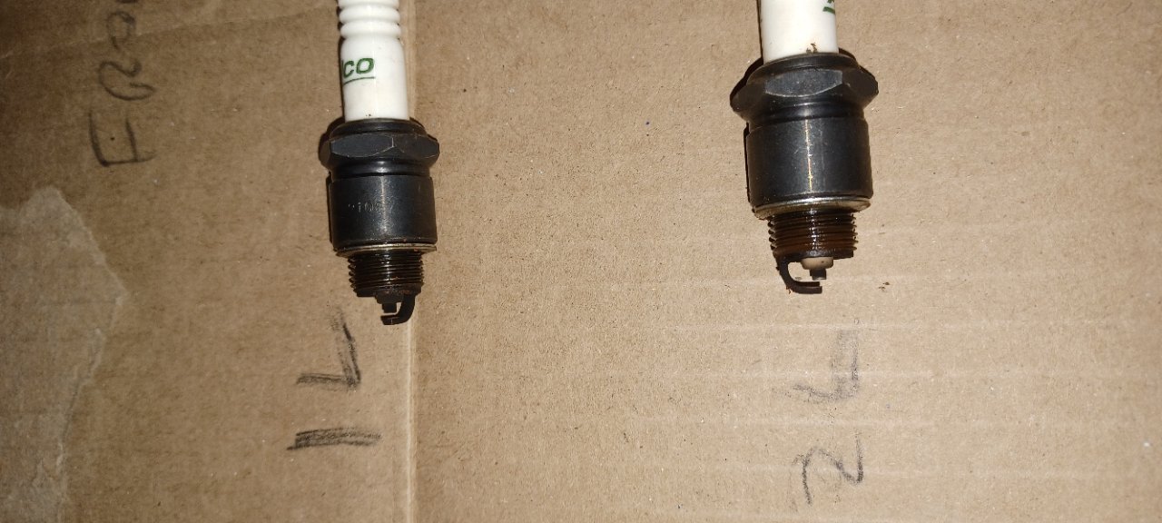

Has 50 to 60 lbs of oil pressure when it first starts up, goes down to about 35 to 40 when it's hot at idle. Timed at 12 degree's base timing, with mechanical, at 3k, it's all in at about 30 degree's. The vacuum advance is about 16 degrees, so all together around 46 or so. (Using manifold vacuum, on the edelbrock. I've also tried using ported, and there was no change in the sound). I did remove the vacuum advance and plugged it, capped the carb, and ran it down the road. and there's no change in the sound. Vacuum is right around 18/19, but moves up and down about a degree or two very slowly. Idles great when warm, and has power while accelerating, no bog or hesitation. There's no surging while cruising, and the sound is only when you put a load on the motor, like going up a hill, or from a stop. I've read a lot on here about spark knock, but this doesn't sound like that. I do hear some ticking from the valve train at idle, and in park, revving the motor up doesn't produce the sound that it does under load. I have compression of 135 to 140 in all cylinders with the exception of no. 6, which is 125. Motor doesn't seem to be using any oil, and no blue smoke out of the exhaust. I pulled the valve covers, and all the rockers are solid, with the exception of no. 6, both of which are very slightly loose side to side. All rocker bolts are tight.
1, 2, 3, and 4 plugs look fouled, but 5, 6, 7 and 8 plugs look great.
Pic is #4 plug and #6 plug.
I do have plans to rebuild the motor, but it's not in the budget right now and would like to put some more miles on it. Am I hurting anything by driving it like this? Any idea's to mitigate this noise?

Maybe do the valve cover gaskets, if not already done and check valve train play without it running. It could be a sticky lifter or it could be worn rocker arms. Easy to pull a set of rocker arms and inspect for wear, especially if you find the cylinder. You could try an engine oil flush as well. The GM oil flush used to be really good. What brand of oil and what weight of oil are you running?

Header gasket leaking ? Sound like it has a missfire to me but hard to tell for sure. Not smooth.
