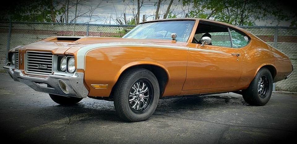

I don't know how people get heat soak. I ran a stock starter with long tubes no issues and I have never had ground clearance issues. I finally went to a mini starter with the new engine ( plan on running locked out timing) . All the arguments against them and I have never had an issue.
A picture of the ride height for reference. just a little lower in the front close to stock.

What headers Copper? My car does sit high in the front like the pic above.

Olds307and403 these are old blackjack headers.
