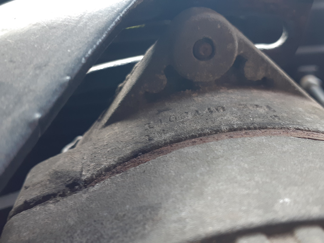

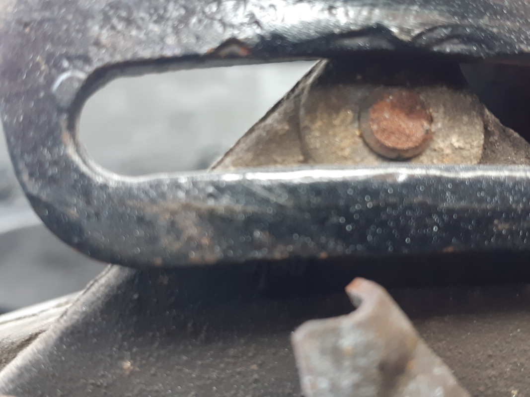

Ok, I will try to think of something, at least the power steering pump pulley has no play in it anymore, really don't no how to go about getting the broke bolt out of there
Front and back view:
Old Jul 27, 2019 | 09:13 AM
Gpc1's Avatar
Joined: May 2019
Posts: 205
If you don’t have the tools or experience removing broken bolts, that alternator looks pretty old it might be easier and less frustrating to just get a new or rebuilt one. Good luck
