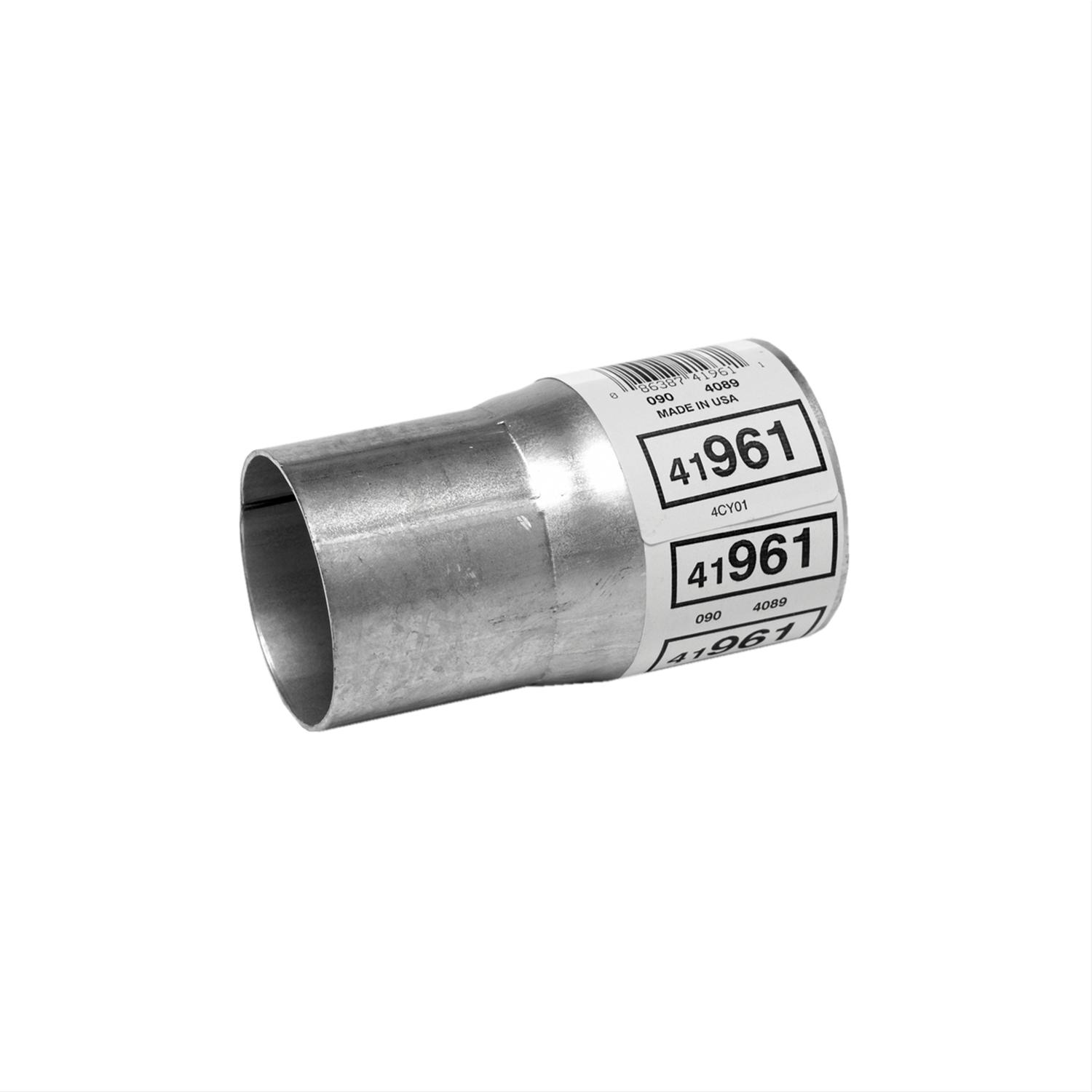

I bought a set of hooker 3901hkr headers for my 72 supreme, I've purchased the gaskets, ARP bolts, etc. to do the job right. I am not an exhaust guy but I am very mechanically inclined. I plan to install the headers,gaskets, etc. I know they'll need a lil tweaking but I'm a boat guy so I'm used to these sort of excerises in futility. The only question I have for you guys is what collector/reducer to choose. I currently have stock exhaust that I made dual exhaust. With a crossover pipe. I took the caliper to it and i'm coming up with 2-1/4 OD pipe. It says the Hooker 3901HKR has a 2-1/2 outlet so I'm wondering do I go with a 2-1/2 outlet to 2-1/2 outlet and slide the collector over the pipe and clamp it until I take it to the muffler shop for welding or do I choose a 2-1/2 to 2" and slid it inside of the pipe and clamp as I'm not seeing a 2-1/2 to 2-1/4 collector reducer. I can also buy the band style clamps, etc. just to get me by until I can get them welded on. I'm working at my buddies place so I would just need to get about 30 miles without dragging a ton of sparks down the freeway LOL! Thanks in advance!!!!

...as I'm not seeing a 2-1/2 to 2-1/4 collector reducer.
Took less than 30 seconds on Google.
Walker P/N 41961. About $6 at Summit.

Thanks guys, I was thinking this as well. I just saw various installs were taking the collector and (welding or clamping) it directly to the pipe and then bolting it to the header, without the reducer. I was having a tough time figuring out how this would work for me without the use of a reducer. I'll go with the collector 2-1/2 to 2-1/2 collector and then use this reducer to get what I'm after.
