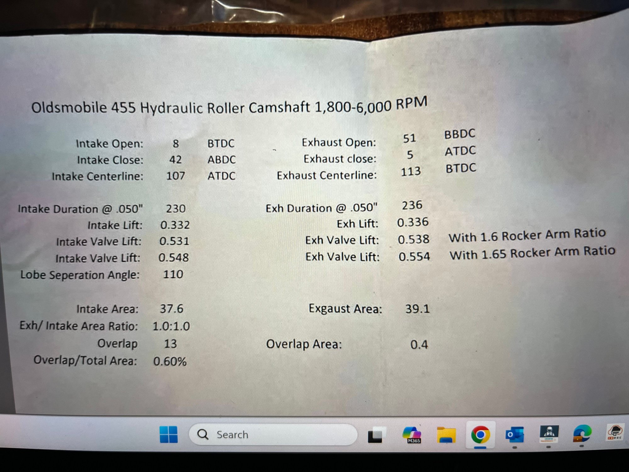

Hi all. Can anyone give me some direction on this cam. Bought it because of decent deal. Currently the blocks in the shop getting forged flat tops and bored out. It’s a 350 and the Heads are ported number 7’s with 2.07 intakes and 1.710 exhaust valves. Stall converter, headers and gears. Looking for good power from 1600-5800 and this cam seems to fit the bill. It was a mondello custom grind for a 455. This is not a strip car, but looking for good street ability and about 400-425hp out of the 350. Car is a 71 cutlass supreme convertible . Thoughts? Thanks in advance.

do you have any other specs on the cam like grind # or part#?
maybe it’s stamped on end of the cam or on the box? look to see if the advertised duration is shown anywhere

based on the card it doesn’t look too radical at all.. Somehow I don’t see the pics I posted before, so reposting..The card I found online with the same part number.
