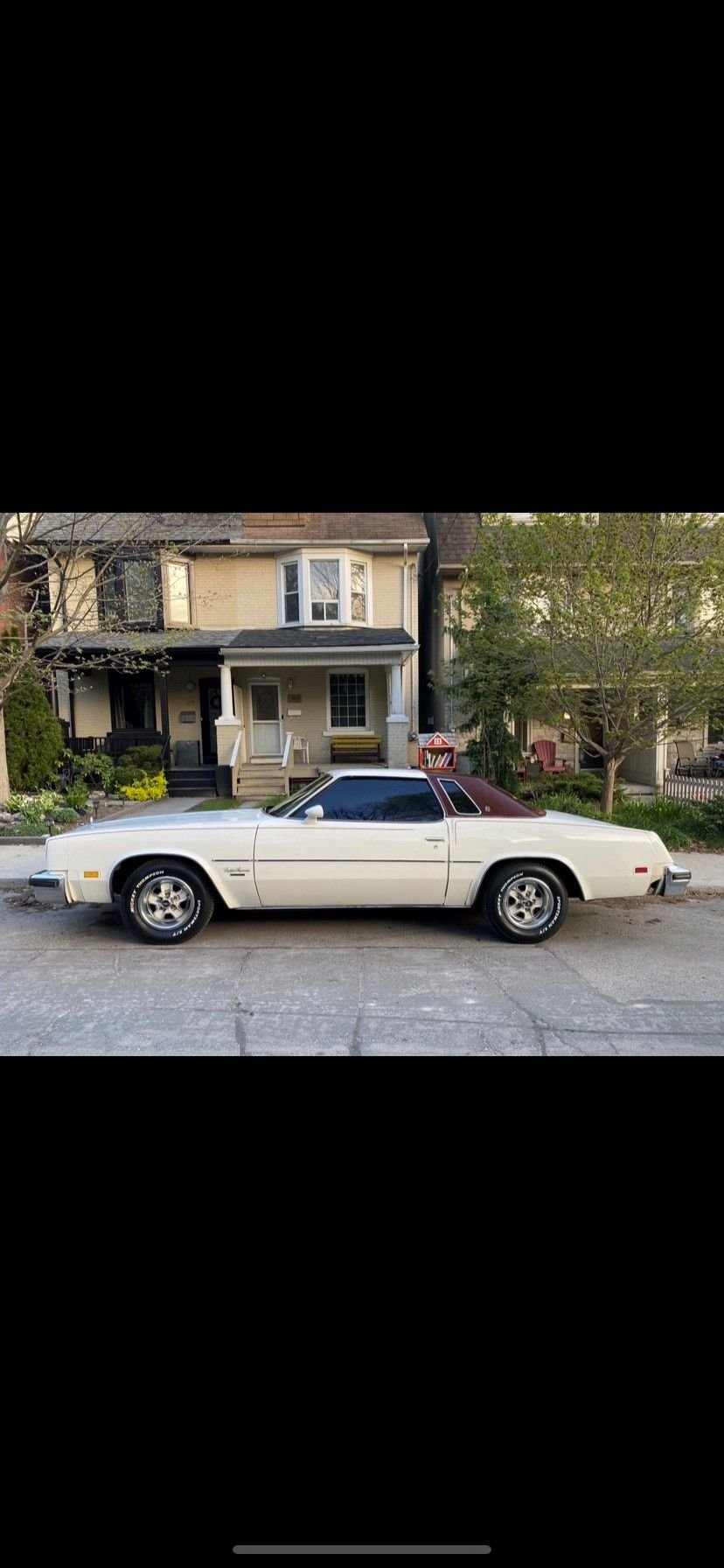

What is the overall condition of the car? What are your goals with the car?
As far as rebuilding it yourself, what is the extent of your mechanical experience?
Good luck!!!
Overall condition is great especially body and frame....picked it up in Arizona last year. My goal is to cruise during the summer/fall months as my everyday car and really would like to keep driving it for at least another few summers. Open to keeping it longer term ..not in a rush to sell. I have ZERO mechanical experience lol I bought this car for sentimental reasons.
