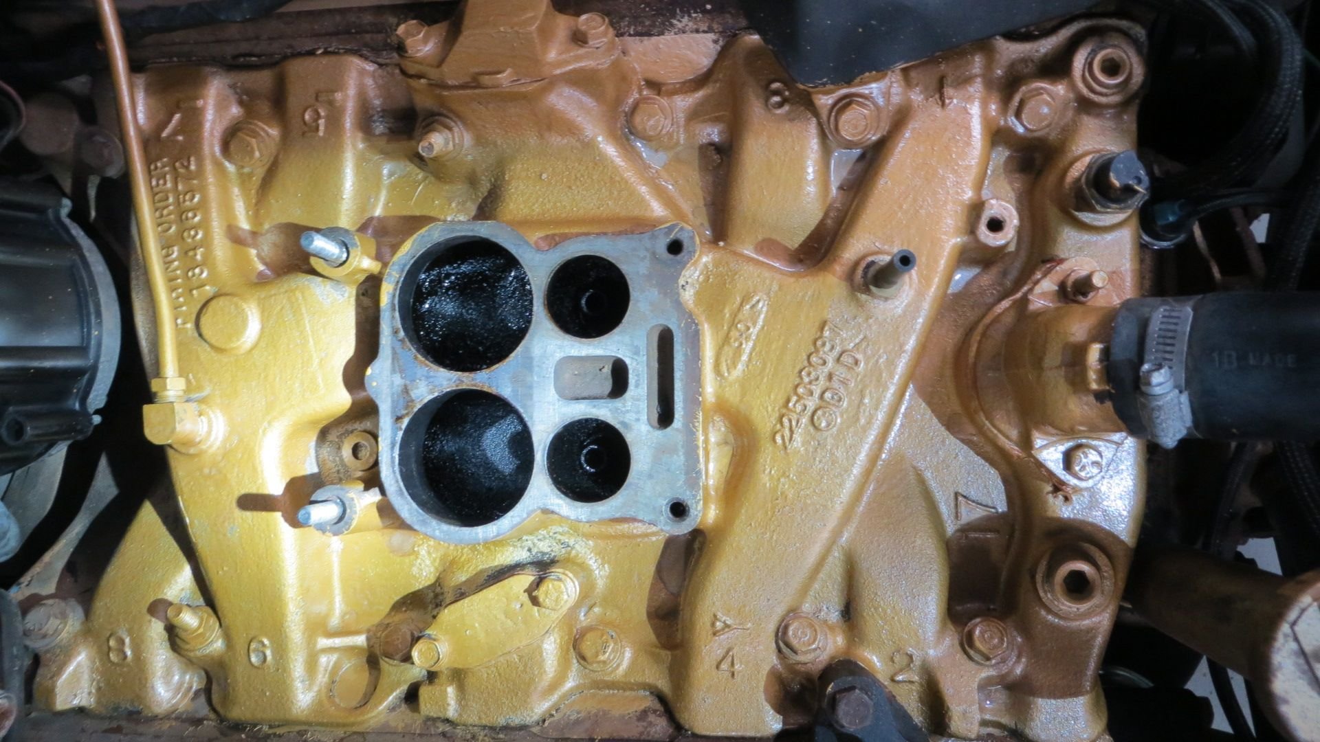

72 cutlass 350 intake
VIN indicates the car was originally a 2BBL carb. so this intake was added by a prior owner.

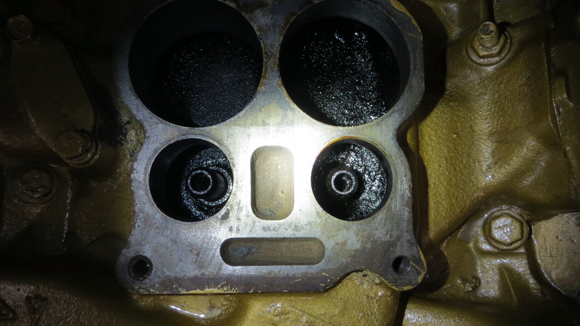

What are these tubes in the primaries?
Also, the intake plenum appears to have been coated with a black ceramic or powder coat?
Casting # 22503087 GM PatsWiki shows 1980 307c.i.

Not a 72 intake, as it has a egr valve Tim

Yes, that is the common early iron, regular sized port Olds 307 intake. Yes, those are part of the EGR system.

Casting 22503087 was used on the 1980-84 307 motors and on 1980 350 motors.
