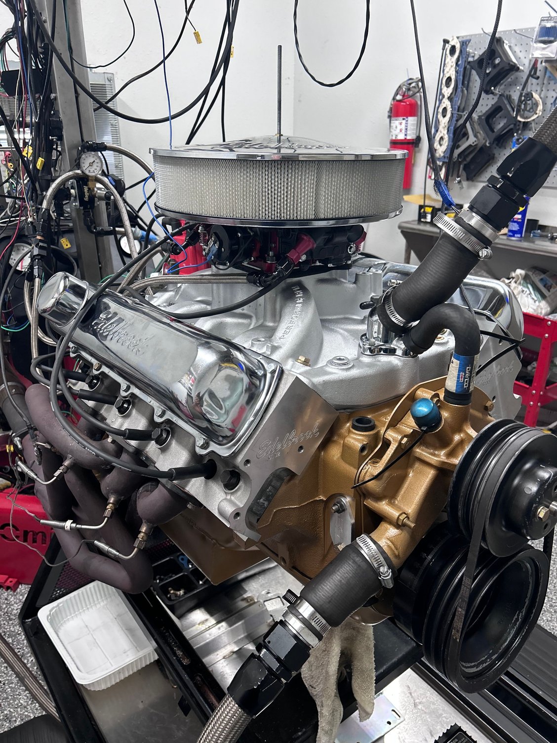

As mentioned use the 7111 intake. You can search drop bases online that’ll help make that work with the shaker hood.
Per Joes statement, here’s a 9.8:1 403 with the new Edelbrock “big block” heads. It made 471/519.
