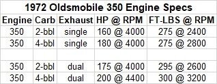

Old Apr 8, 2024 | 02:31 PM
Posts: 15,411
The only comparative data I have is the actual Oldsmobile specs for the 1972 350 engine configurations. While the 1972 350 engines are not the same as the 1967 330 engines, the power gains should be comparable.
Old Apr 8, 2024 | 02:51 PM
In 1967, Olds offered both the 2bbl and 4bbl motors in both 9.00:1 and 10.25:1 CRs. The RPO L65 low compression 2bbl 330 was rated at 250 HP. The RPO L73 low compression 4bbl 330 was rated at 310 HP. Unfortunately these are not apples-to-apples comparisons, as the 2bbl motors got the 250/264 cam with 36 deg overlap while the 4bbl motors got the 278/282 cam with 47 deg overlap.
