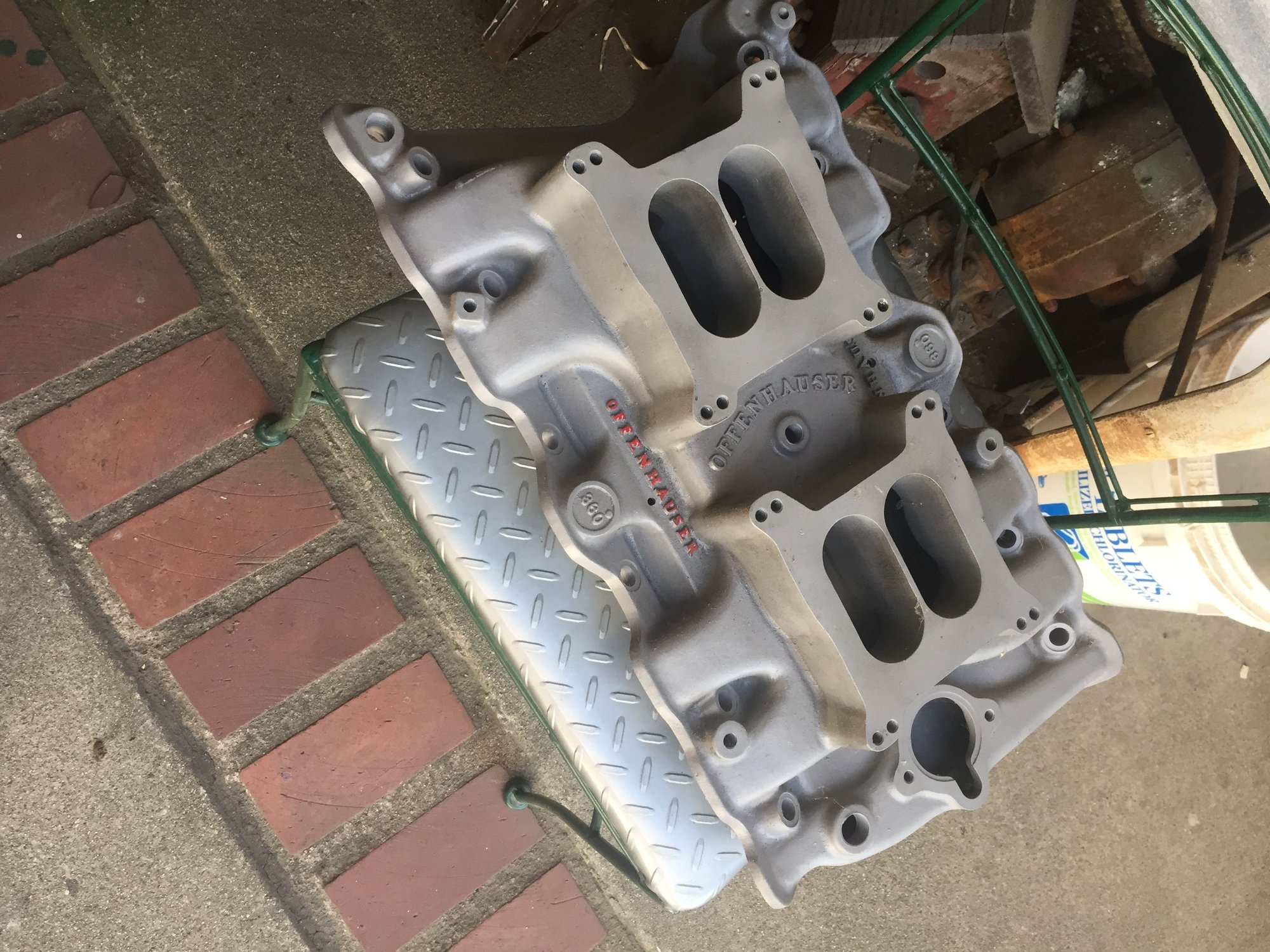

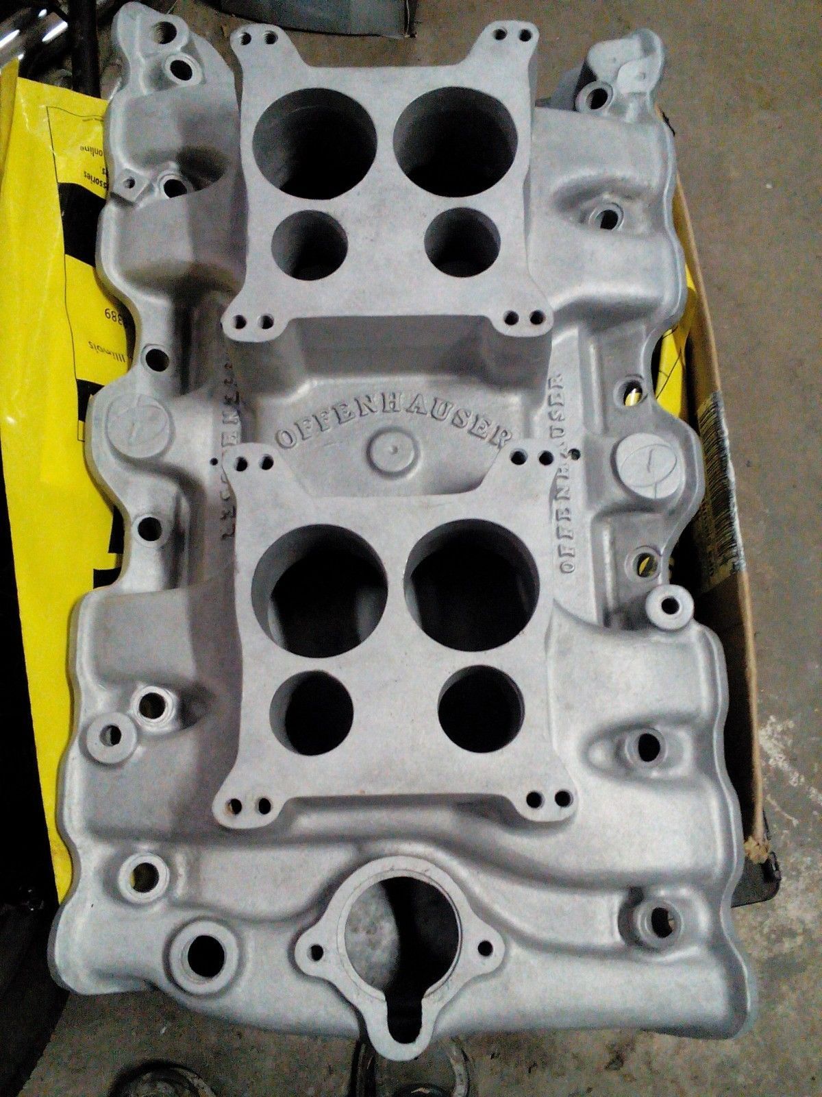

I have an extra Offenhauser dual four 360 intake for a SBO.

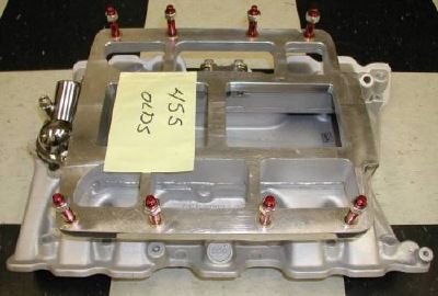

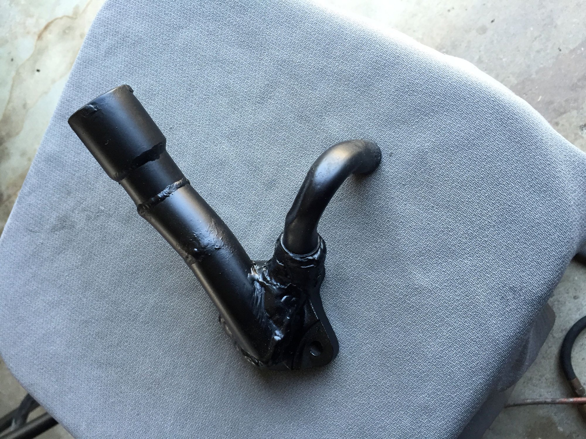

Also pics of the blower and manifold machined and blower plate heliarced in place and a pic of the filler neck modified under the blower neck.

That blower manifold looks like the 180 (or whatever Offy called them) with the center divider wall that separates the two banks from each other. Most blower conversions mill that down to avoid flow disruptions.

Joe, you are very observant...........this was the first one I had done..........it was a single four manifold..........the one I have on the car is a 360 dual four, and I have an extra 360 in case we screwed one up during the machining and heli-arcing.

Machining the Offenhauser 360 with the top of the 3/8" plate even with the top of the runners allowed me to keep it under the hood............no hood cutting here.

Offy made those dual quad intakes in high rise and low rise versions - the one in your photo is the high rise. They even made them in dual Qjet versions. Too bad they are such crappy manifolds for NA applications - just gimmicky. Their sole reason for existing is to be made into blower manifolds.

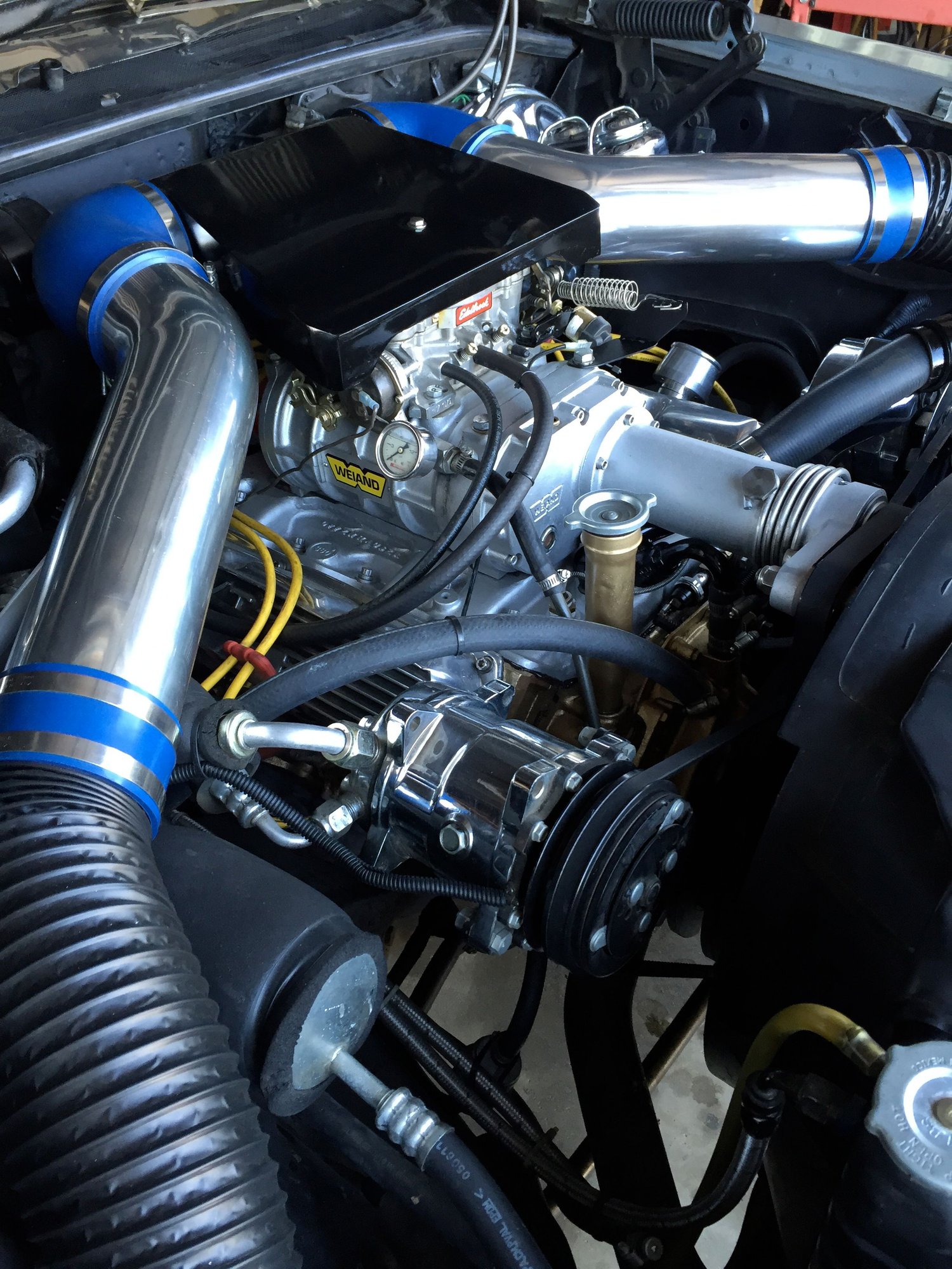

No running videos............it sounds like a stock engine, the boost gauge is in the non-positive range, when you floor it, the gauge goes to +5.25 psi, very drivable.
I had a serious problem 3 years ago...........lost a piston, Cutlassefi diagnosed my problem as possible detonation. So took the distributor to an old one-man shop and he put it on the Sun machine and we saw the advance go to almost 50 degrees at 1800 rpm.........so he talked to a friend who dealt with supercharged engines and said block it at 20 degree max, get rid of the vacuum advance and set crank timing at 12-15 degrees.
No more problems, engine runs cooler, starts easy, problem solved. Cutlassefi hit the nail on the head.
