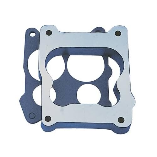

hey, could anyone reccomend where i can get a spacer for my carb. my dad told me it was jetted bigger for the bigger cam it has in it, and i need a carb spacer anyways since the throttle gets stuck on one of the head bolts,
thanks!!

easiest and fastest shipped to me is usually amazon.com or rockauto.com
i like rock auto!! i got a bunch of stuff from them! one of us messed up on a piece of pre bent exhaust pipe... idk who, but the pipe is wrong...
i didnt notice they have carb spacers!

is this it?
Old Nov 25, 2008 | 09:48 AM
  #56
J-(Chicago)'s Avatar
Seasoned beater pilot.
Joined: Jan 2007
Posts: 5,468
From: Chicago
Looks like it.
It depends what carburetor you are using.
That one looks like a quadrajet spacer judging form the gasket.
Just remember the quadrajets have a different bolt pattern than the rest of the carbs.
Old Nov 25, 2008 | 09:52 AM
  #57
Joined: Jan 2007
Posts: 5,468
From: Chicago
There are ''square bore'' bolt pattern carbs, and "spread bore'' bolt pattern carbs.
Old Nov 25, 2008 | 09:56 AM
  #58
HARDLUCK88's Avatar
ROCKETeer
Posts: 199
From: Eastern Seaboard
it looks about right... will i need 2 gaskets for this?

Yes.

this is the gasket rock auto has... its different
Close enough.
Same with the 58 egr washer in my opinion.
Don't make it so hard on yourself bud. Although I'm glad that you're trying to do everything perfect.

Thought so spent enough time frying there to recognize it. The carb gaskets will work fine . What do you think will hit the egr valve, the throttle linkage or just the cable? You might solve it with a universal cable mount to change the geometry a little.
i think the spring might not clear it... ill order the gasket and the spacer, if anything i could make a new gasket for it.

this spacer i bought, came with mounting studs that were too short!
with the studs in and the carb mounted, the top of the stud is flush with the top of the carb, i cant even get one thread on it... so now i have to go out any buy longer bolts... what the **** is the point of buying an adapter if the hardware that comes with it is wrong???!!!
anyway... i got the adapters for my trans cooler lines ready, i have to go to Napa tonite anyway, so ill get all of my vacuum line and tranny line and ill inquire about getting some new mounting bolts...
