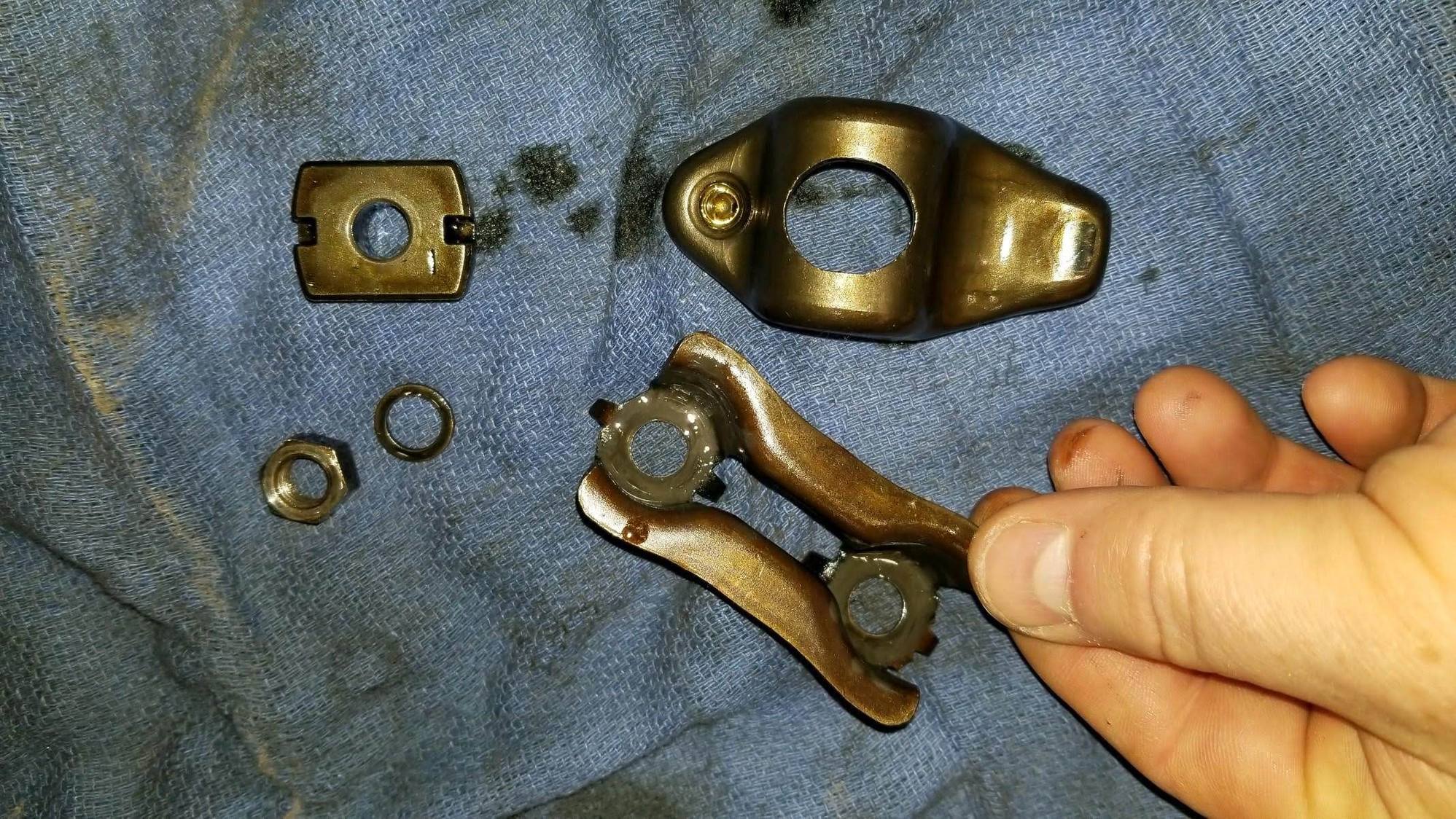

Can you post a picture of the head showing the rocker arms ? I did a 65 425 engine a few years back and ran into the same problem because apparently some of the very early 65 engines used a stud for the rockers instead of the later bolt down bridge setup. You might have the same setup and I could not find rockers for them. I ended up converting it to the new style. I had to buy some unusual bolts and washer for spacers but it turned out very nice. I have some pictures somewhere of what I did.

I think this might be what he has. I will see if I can find a picture of the stud that holds it down.

Another picture.

I believe 65 used a different size stud vs later engines 3/8's sticks in my head so check before you order anything.

The 1965 heads do use 3/8" studs instead of the 5/16" bolts, but the ROCKER ARMS are exactly the same as on any other 1965-90 Olds motor. It's the pivot blocks and bridge that are unique to the 1965 motors. Replacements do not exist. If the problem is confined to the rocker arms, you can replace them with new and reuse the pivot blocks.

I dont know if you remember when I did the 425 a few years ago. I ended up drilling the new style pivots for a 3/8" bolt and used socket head screws to mount them. I honestly do not remember if I had to cut anything off the bottom of the pivots but i dont think so. Here is a pic of what i ended up with. I think I still have a box of the bolts and washers at the shop It worked great.

I also used the '66 and later bridges on a '65 head. Standard grade 8 hex head 3/8" bolts of the correct length with flat washers worked fine after drilling the bolt holes in the bridges. perhaps the one piece bridges are no longer available and thus the need to use a socket head bolt for the conversion.
