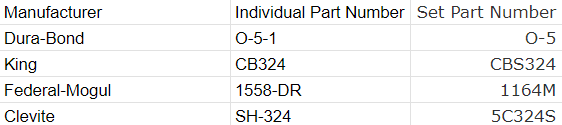

<!--td {border: 1px solid #cccccc;}br {mso-data-placement:same-cell;}-->Also I should note. I believe the 1956 has all the same size bearings but, 1955 has one or two that are sized differently. Below are cross reference part numbers I was able to find.
Manufacturer Individual # Set #
Dura-Bond O-5-1 O-5
King CB324 CBS324
Federal-Mogul 1558-DR 1164M
Clevite SH-324 5C324S

If you look at the cross reference chart I created from the Dura-Bond catalog information. I think the CBS324 Kanter part number came from the Manufacturer King Bearings and they just continued to use it. I did call Kanter yesterday and they are on backorder as well. The sales guy I talked to said Dura-Bond has not been very reliable recently.

I agree it is strange. If O-5 fits 54-55 plus all the later years. Then CBS214 and CBS324 should be almost identical.
