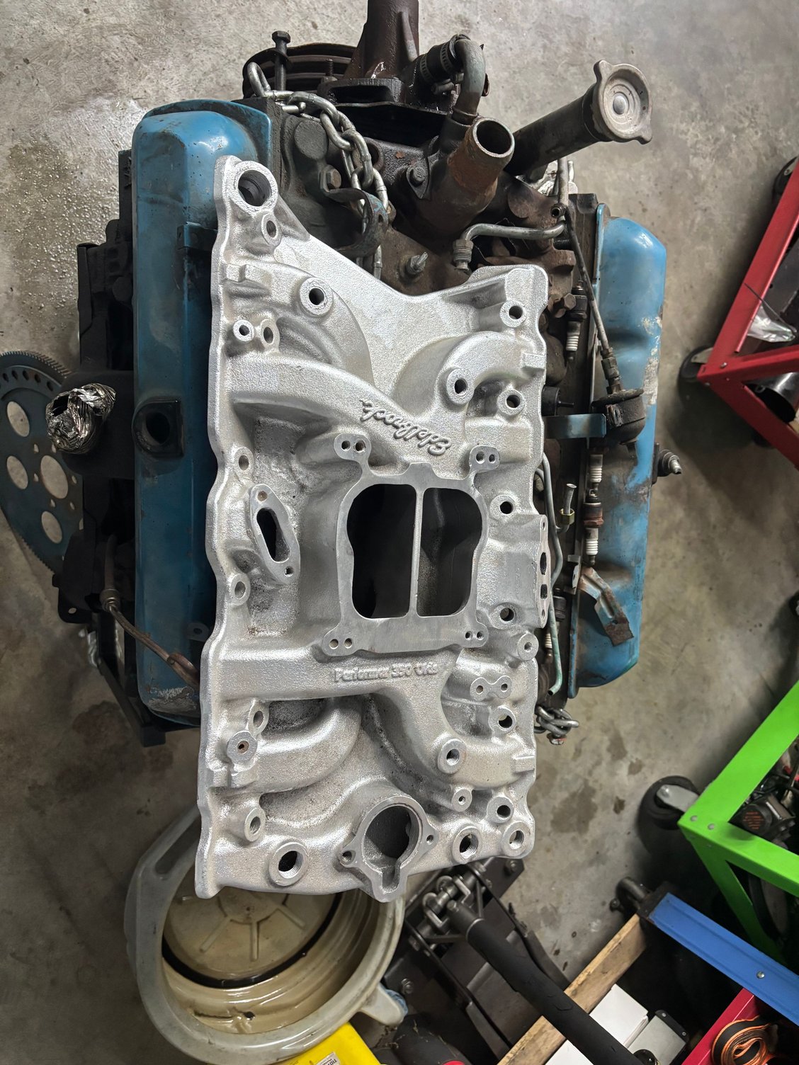

The engine came with a great shape EDDY 350 intake. That I can use.

Welcome. Unfortunately the tiny runners in that E-brock Performer are inconsistent with your goals. Sell it and get a Performer RPM. The 403 has windowed main webs that require a girdle for high HP builds. Your best bet is a set of aftermarket heads that will flow appropriately for that engine. Talk to Mark Remmel (cutlassefi on this site) for details. He's build a few of these.
