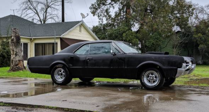

Need input on cam selection. 67 Olds, 3400lbs (lightened), 468, 9.76:1, Speedmaster Alum Heads, Torker Intake, Roller Rockers, Rhoads V-Max 2nd Gen Bleed Down Lifters, 3.55 posi, 200R4 w/2500rpm stall (9.72:1 total 1st gear). Planning on installing a nice Lunati Voodoo (227/233 @.050 w/.511/.523, but have a big Engle too (248/256 @ .050, .548/.566. Will this overall combination be streetable with the big Engle? HP differrnce btw the 2 cams?
