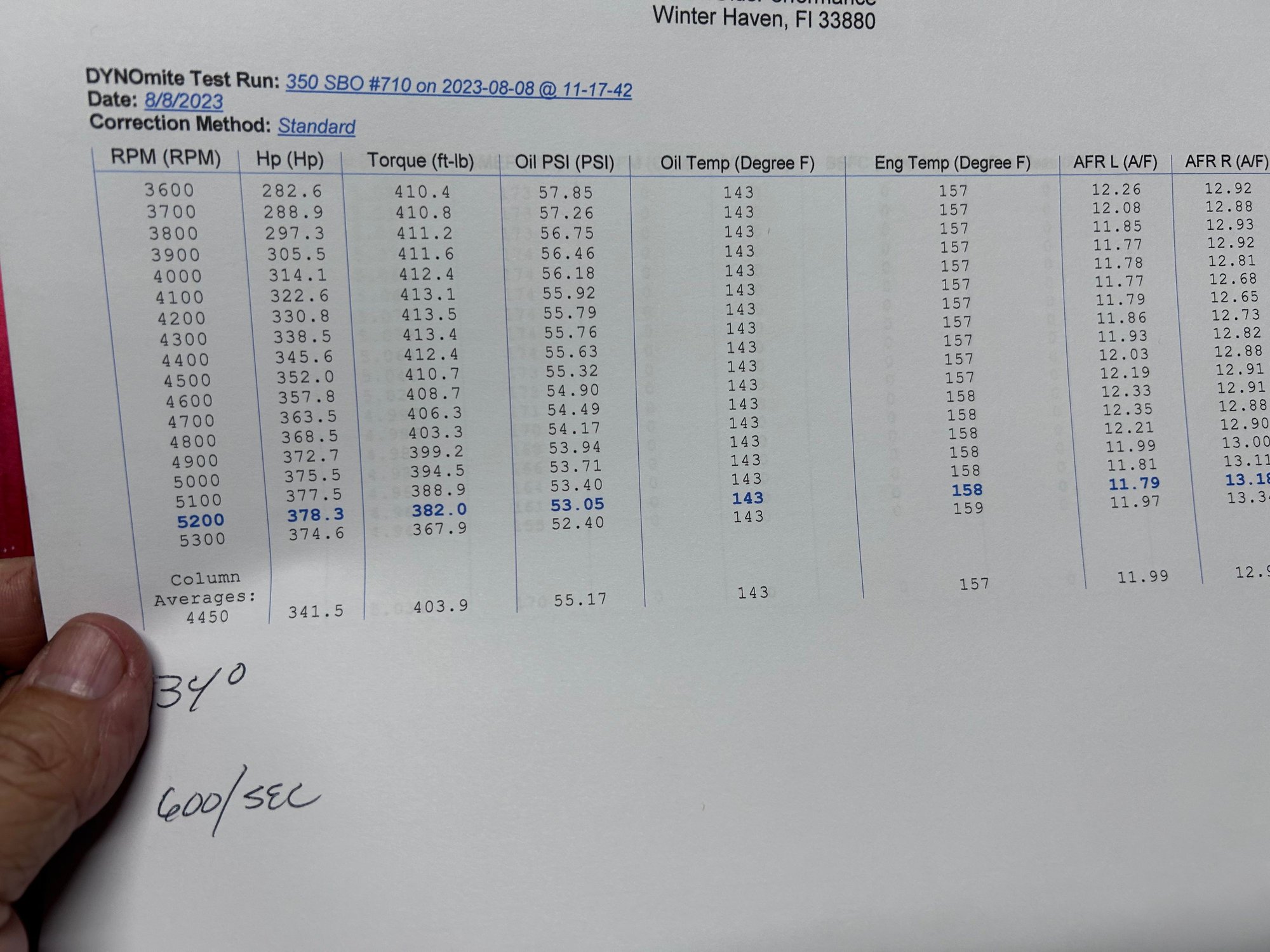

This what you can expect from a mild 350 build, done the right way.
4.100 Mahle pistons, 9.4:1
Scat Rods
N crank
#7 iron heads with 2.00/1.62 valves, no work except crossovers filled/dividers welded.
Erson hyd roller, 220/228@.050/112lsa with BAM solid roller lifters
HS 50026a roller rockers
Stock bb pan, HV pump
RPM intake untouched
QF HR Series 750 vacuum secondary
Taylor HEI Dist

Old Aug 9, 2023 | 01:55 PM
cutlassefi's Avatar
Posts: 8,449
From: Central Fl
Final after valve lash adjustment and carb tweak

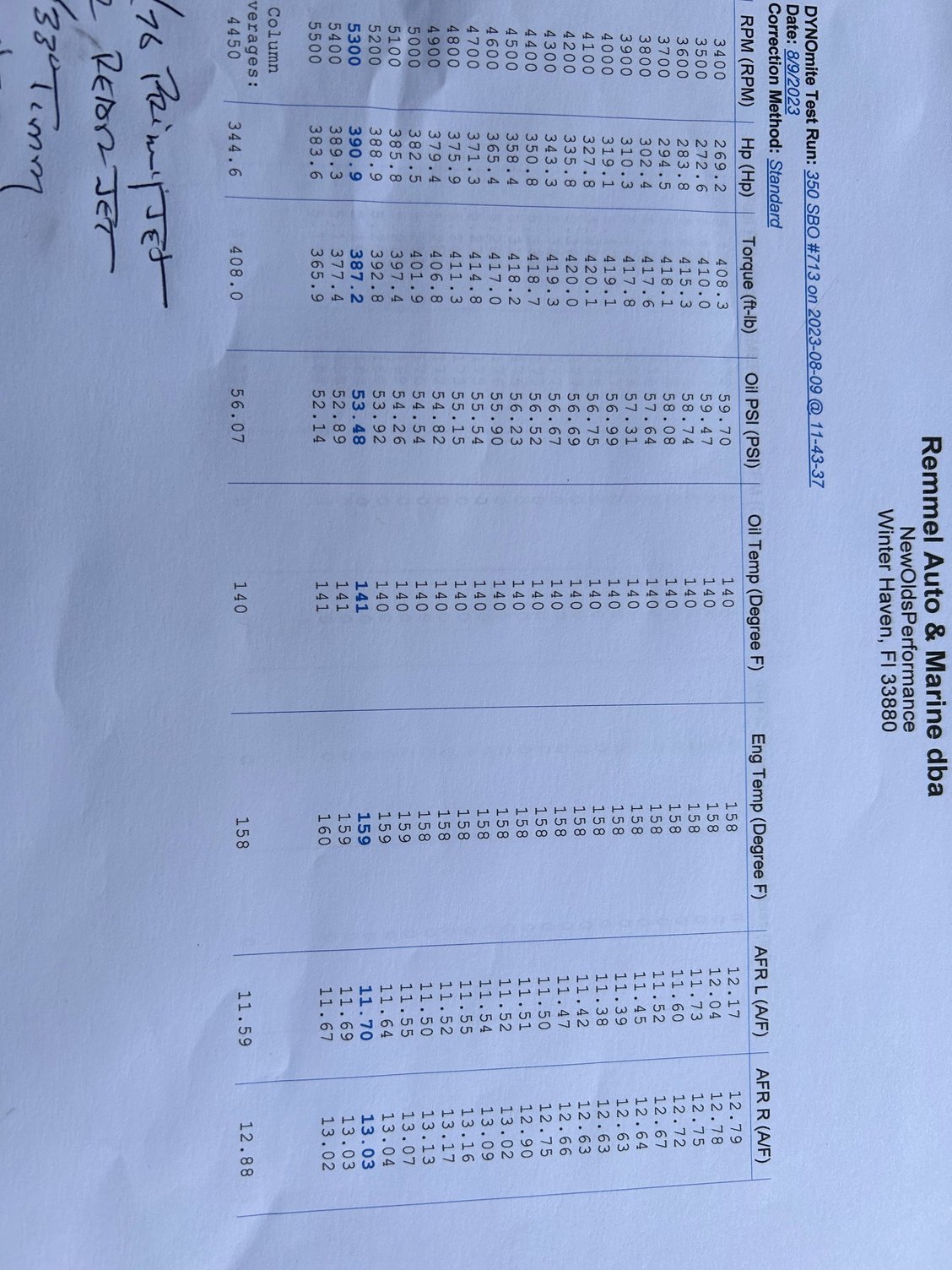

Old Aug 25, 2023 | 02:28 PM
cutlassefi's Avatar
Posts: 8,449
From: Central Fl
Update; I kept tightening the lash and it kept making more power, final is 402/428. I’ll post the final Dyno sheet a bit later.

Wow Mark you pretty much got another 25 ponies out of lash adjustments comparing your first post to the last, super job bud, Love seeing it go over 400hp for a mild build.
