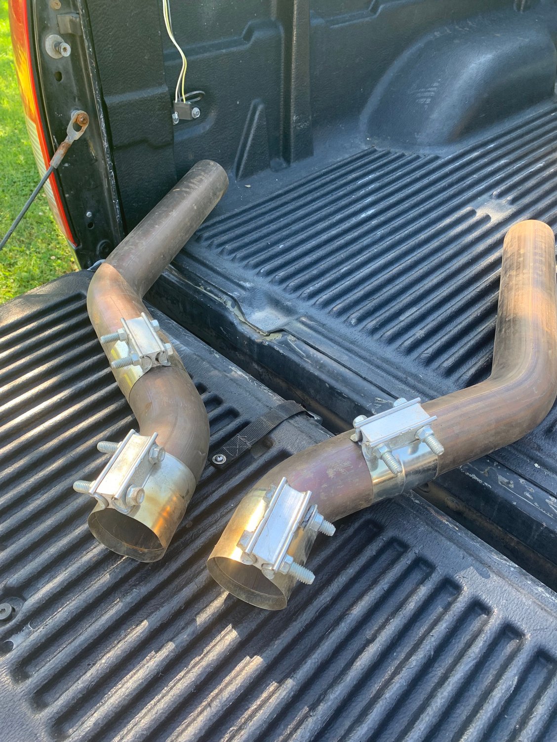

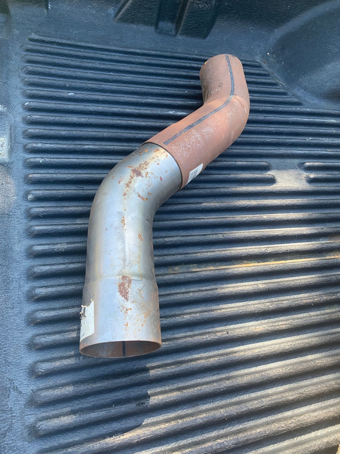

You use your regular headers..it’s downstream of the collectors that needs to be wider. I use a couple of offset mandrel bent pipes to get around that.
I’ll post a pic later

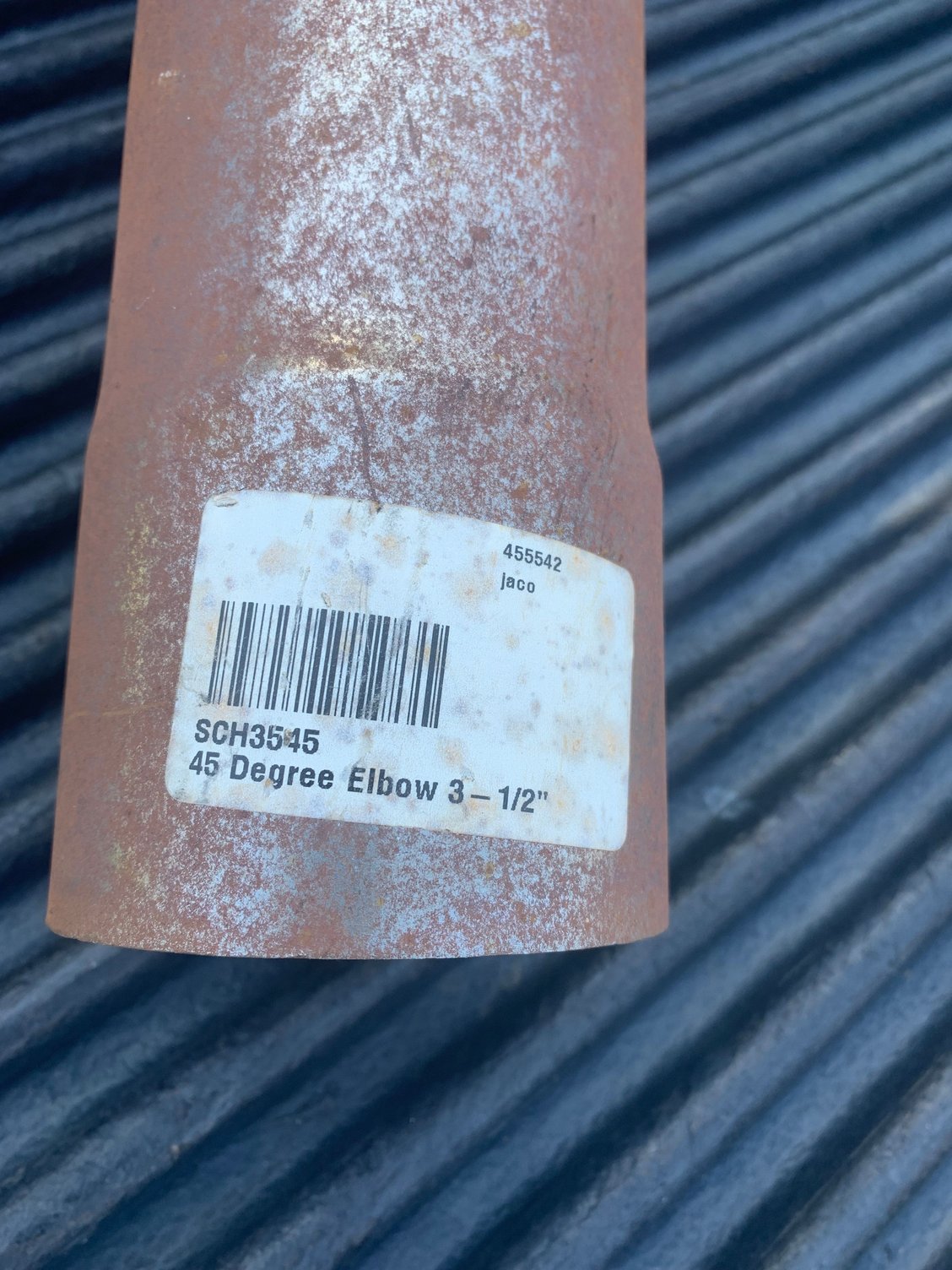

I use the long 3” ones most of the time. The bigger 3 1/2” ones are for bigger cube high horse stuff. You can get them in 1/2” increments.Got everything at a local truck exhaust shop.
You can use the big flexible stuff but that’s really pricey.

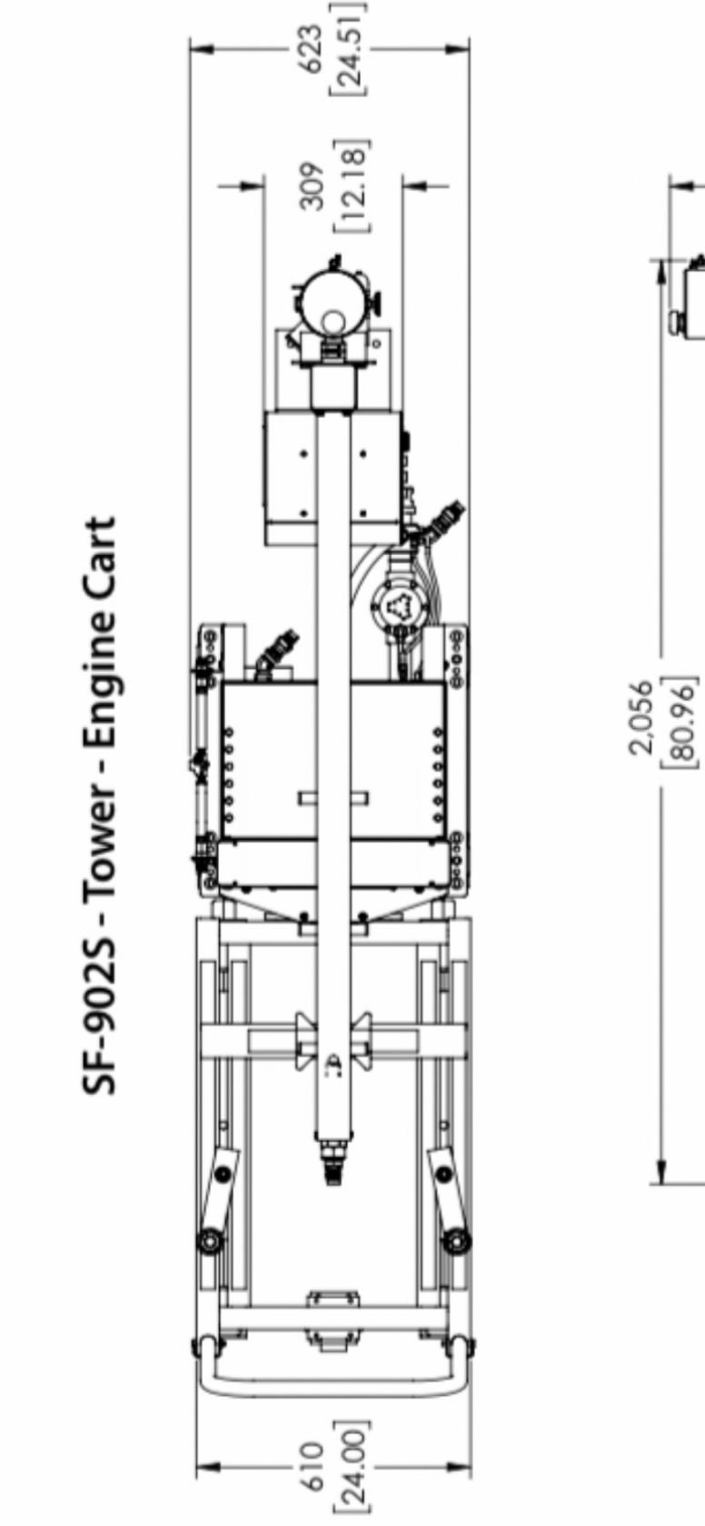

It’s not complicated..you use offsets because your dyno guy doesn’t use flexible or offset hookups to get around the absorber frame for factory style chassis headers which are approx 18” to 20” c to c
heres the 902 measurements..you can see it’s about 25” wide… if he was regularly doing chassis style headers set ups, he would have the offset or flexible hookups already set up to clear the absorber mount/frame…he doesn’t. so it’s up to you to do the offsets.
