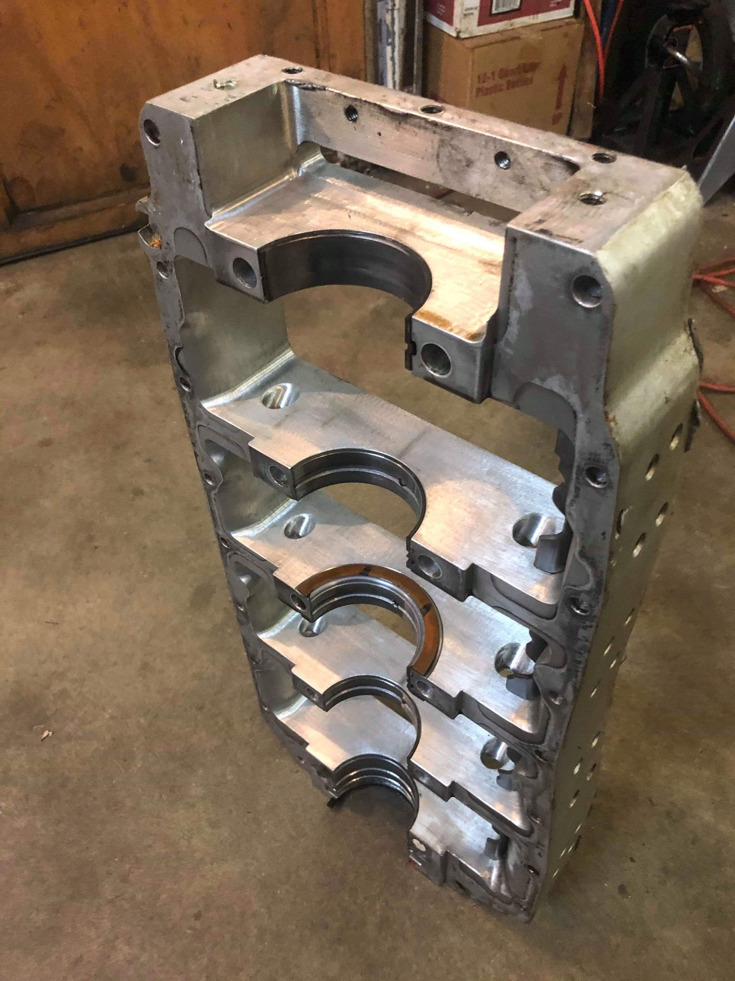

From: St. Paul Minnesota
That girdle has to be the #1 reason the "windowed" engine will last more than 10 minutes, and certainly the stroker crank from Cutlassefi helped. The power is impressive.

From: Barre,VT
Dan I sure wish we could try something like my dry sump girdle on your 403!

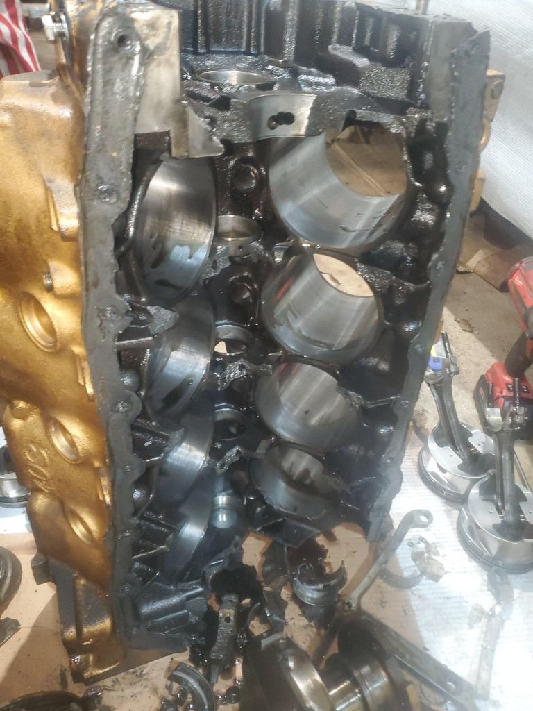

Old Feb 2, 2020 | 05:16 PM
  #62
madmax442's Avatar
Joined: Jan 2014
Posts: 621
From: Barre,VT
Dan has a BTR girdle on his 403 so I’m sure that it’s more than up to the task in keeping it all together. I was just talking about mine being a dry sump setup vs the normal wet sump.
Old Feb 2, 2020 | 05:53 PM
  #63
VORTECPRO's Avatar
Joined: Aug 2012
Posts: 1,878
From: Thousand Oaks Ca
So did this one above. Not Bills work above though. Its a shame they had to build that big bore block with compromises. It seems all production blocks from any manufacturer has something thats no good, thats the problem with production parts.
Old Feb 2, 2020 | 06:06 PM
  #64
Bubba68CS's Avatar
Posts: 351
No it didn't. It had a halo. There is a difference.
Old Feb 2, 2020 | 06:10 PM
  #65
VORTECPRO's Avatar
Joined: Aug 2012
Posts: 1,878
Could you post pictures of each? Thanks
Old Feb 2, 2020 | 06:13 PM
  #66
Bubba68CS's Avatar
Posts: 351
You could just look at the other photos in that thread you stole the photo above from and see it for yourself, then compare to what is on Bill's website...
The difference is obvious - one ties to the caps to the block and requires oil pan modifications, the other doesn't.
Since VTP was rude enough to steal a photo without credit or citation: https://www.tapatalk.com/groups/real...ld-t16955.html
