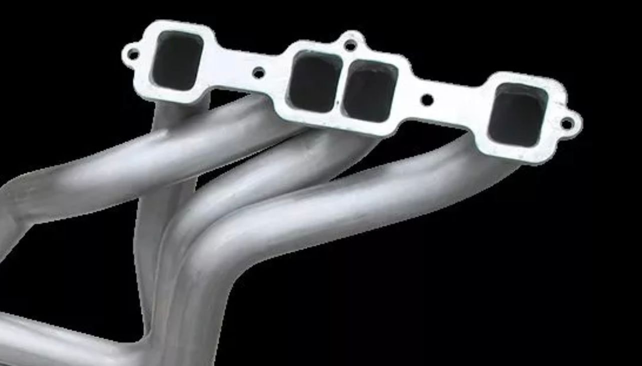

Pretty sure the super affordable Chinese stainless, thick flange, full length headers on eBay will bolt right in. They are very well made for the $100 price.
I just checked them out on eBay. They showed a pic of the inside and they don’t look that great compared to ARH

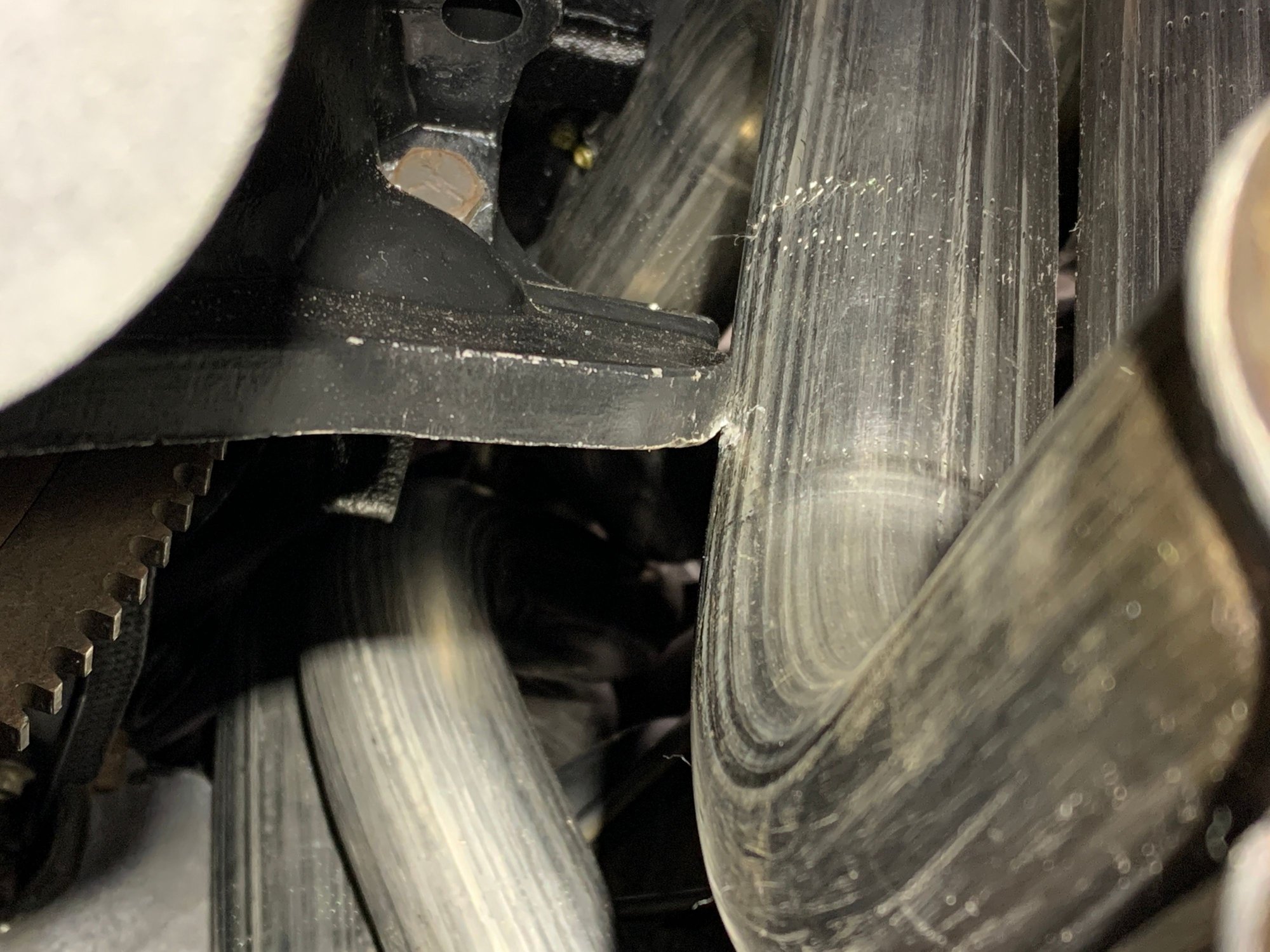

Headers for a 455 on a 73 - 76 Cutlass. 1-7/8 tube #3 tube (2nd tube from the front on the right side) is the issue. It will most likely hit the mount for the lower right rear control arm. I don't think ARH headers take that mount into account and you will have issues with their headers. Look at pictures of 455 headers for the cutlass. Compare the 1-7/8" vs 1-3/4" tube for the right side #3 tube. Ask me how I know. I have a 455 in a 73 cutlass with 1-7/8 tube Hooker headers. The left side (driver's side) was easy.

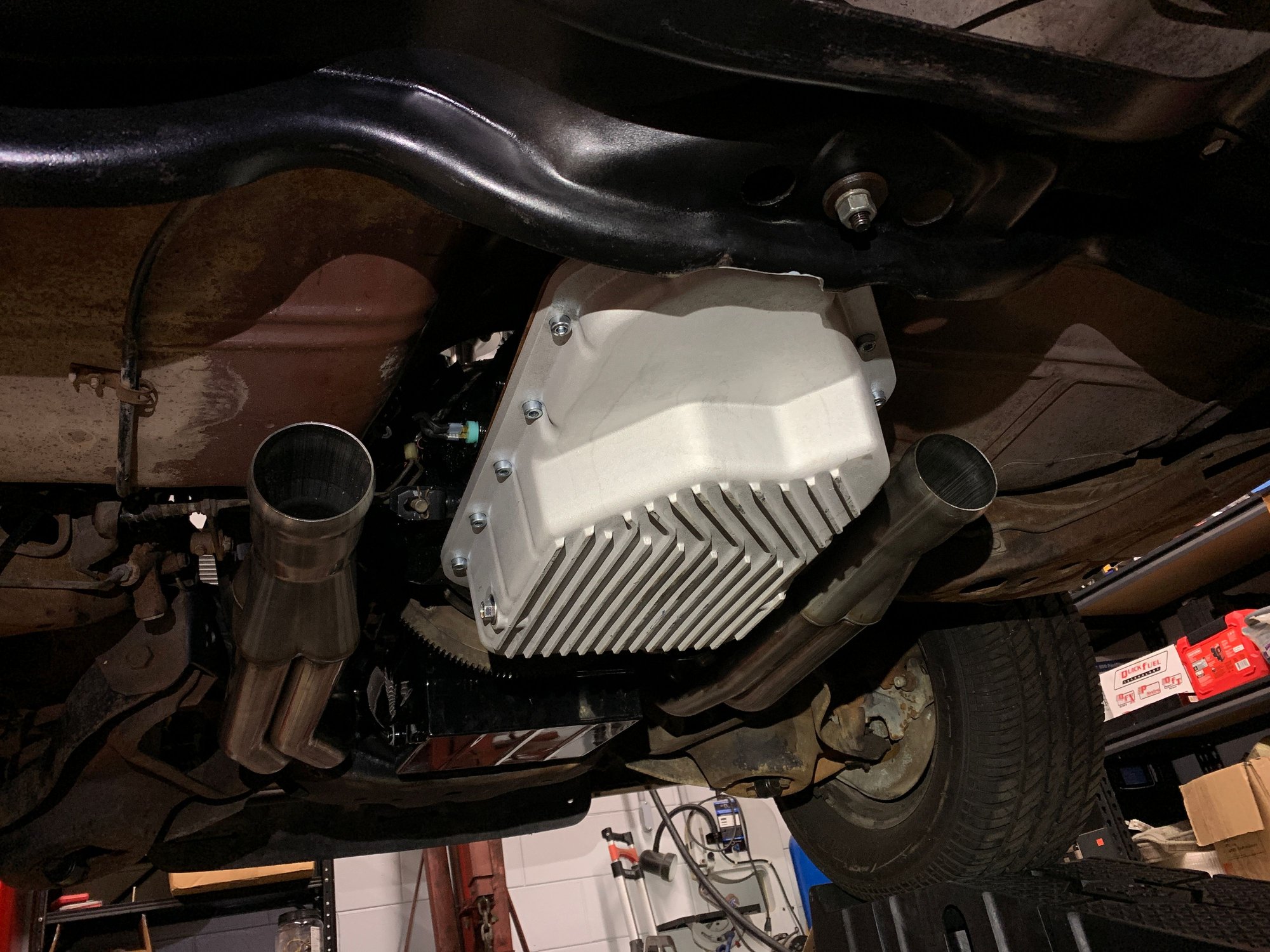

You were right lol. But it was even worse on mine. It didn’t hit the mount too bad. I trimmed the corner off and it cleared. My problem was it hit the bell housing on the trans. I ended up denting the tube and grinding about 1/4” off the housing. It was the ear that stuck out for the dust cover on that side. I even had issues with the drivers side. I have a column shift and the header hit the linkage pretty bad. I spent half the day today trying to rebend the linkage to make it work. Eventually I got it to work. I’m a little disappointed in how they fit. That was one of the main reason I ordered from them. They assured me they would fit no problem. The quality wasn’t terrible, but I thought they would look a little nicer.

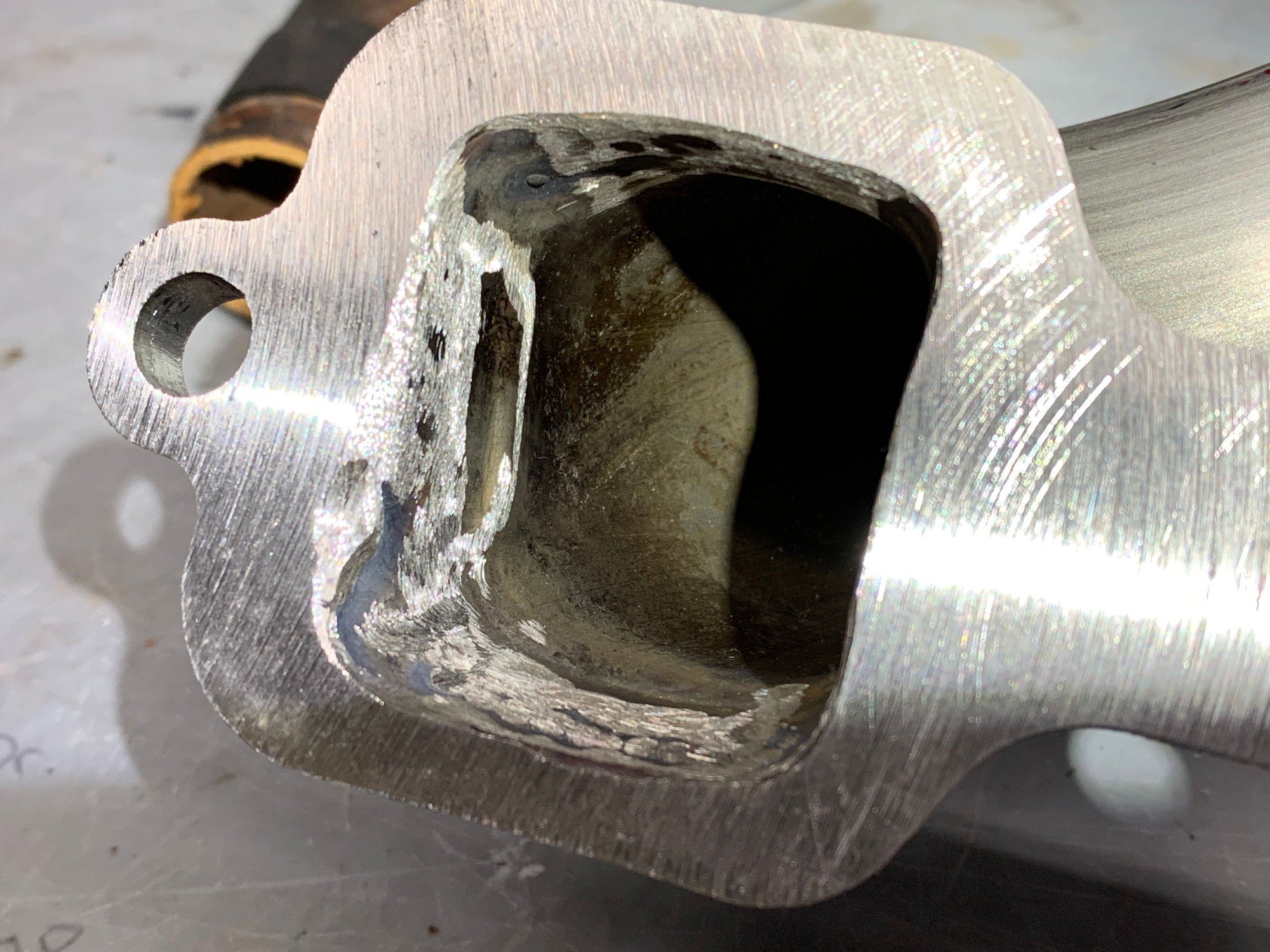

Sorry to hear about this. A $1500 set of headers should look like a Marcella intake, those do not. Those aren't any better at 10 times the cost of the Chinese headers. A bodies are so much easier than Olds powered G bodies, about 3 or 4 choices for them, none cheap except the Hedman's. Are you putting out enough power to justify 1 7/8" headers? It seems the bell housing "ears" are a problem on 1 7/8" and up on any Olds A or G body. I can get the Chinese A body headers for $180 Canadian shipped, a no brainer that pic in the thread is the worst I have seen from any pics shown.
