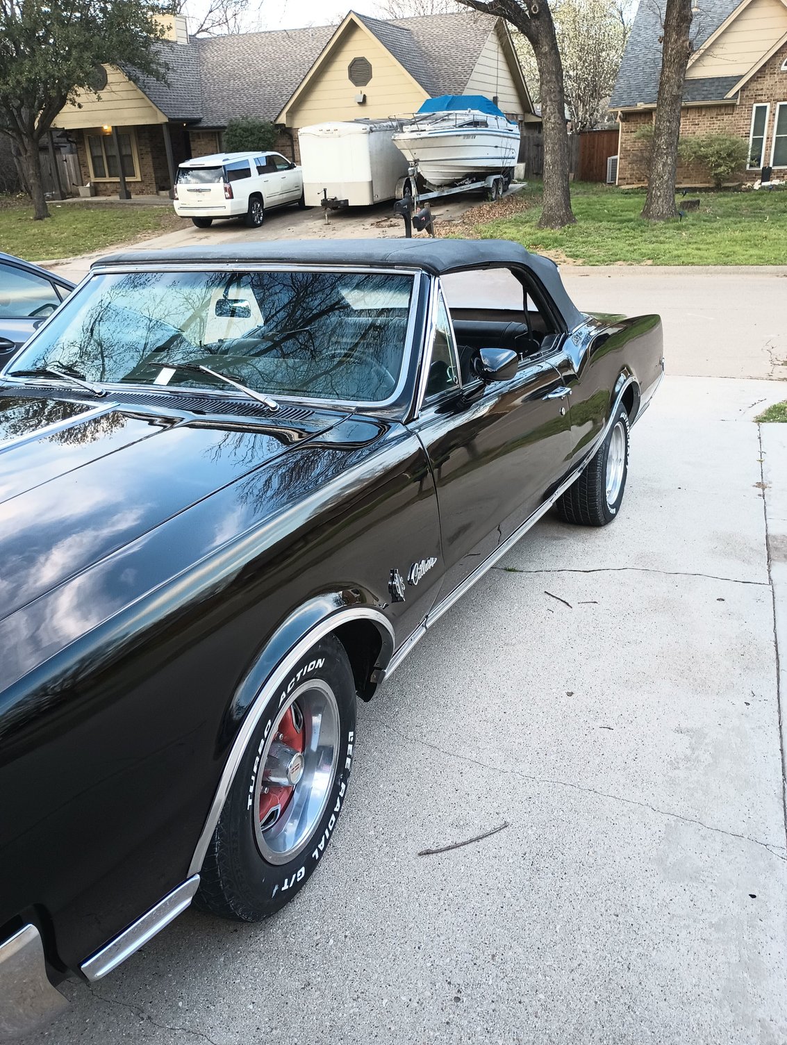

1967 Cutlass Supreme Convertible. I am replacing the 330 with a 1969 455. A seller on eBay is selling a ram air kit for a 1968 Cutlass but fitment says does not apply for my 67. Has anyone tried this and if so, what were the modifications that were needed? Or has anyone successfully installed an aftermarket kit?

You're right, not even close to the right place to post it. Try this. That 1968 kit won't work on your 67.
Old Mar 21, 2024 | 09:40 AM
Posts: 42,495
You can probably adapt that to work on your car, but the normal position for a 67 for the duct cowling was behind the parking lights.

The Olds term was outside air induction. Ram-Air is a Pontiac term. The Olds term is more accurate as you won't be stuffing any more air into the engine with this. Like, said, it's negligible. True "ram air" is compression done with a supercharger.
You are not going to have good success with any under the bumper, through the bumper, through the grill OAI system as the battery will have to be relocated to the trunk to get the hose through. As your car is a convertible, you will have to put the battery in the main part of the trunk and lose a lot of space. This is one reason why there were no 66-67 convertible OAI cars.
If you find you MUST have oai, I recommend getting another hood, fiberglass aftermarket, punch a hole in it, and hang 69 H/O style "mailbox" air scoop on it and use 69 H/O style air cleaner for OAI that way. Reverting back is just put the stock air cleaner and hood back on.
