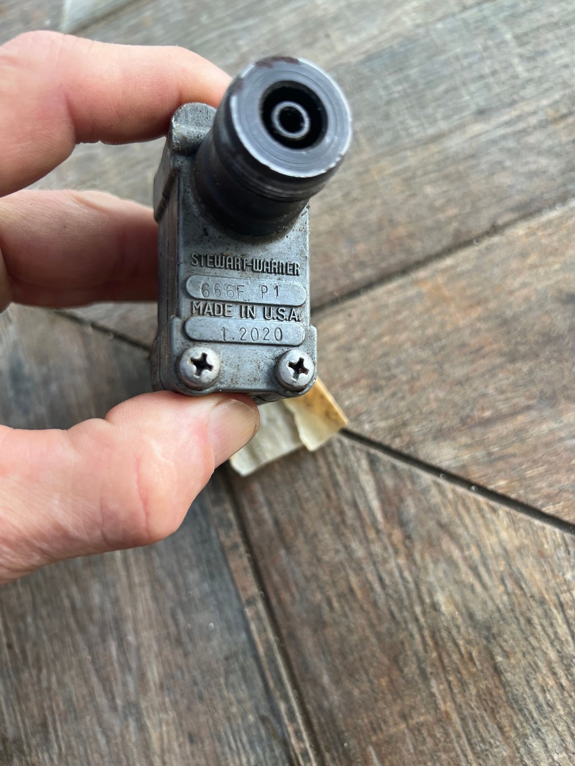

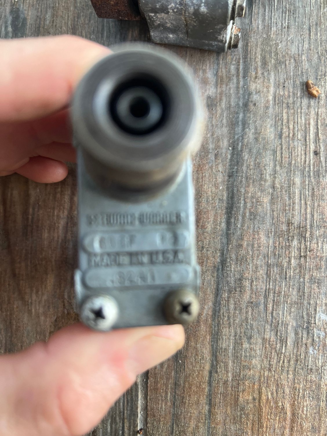

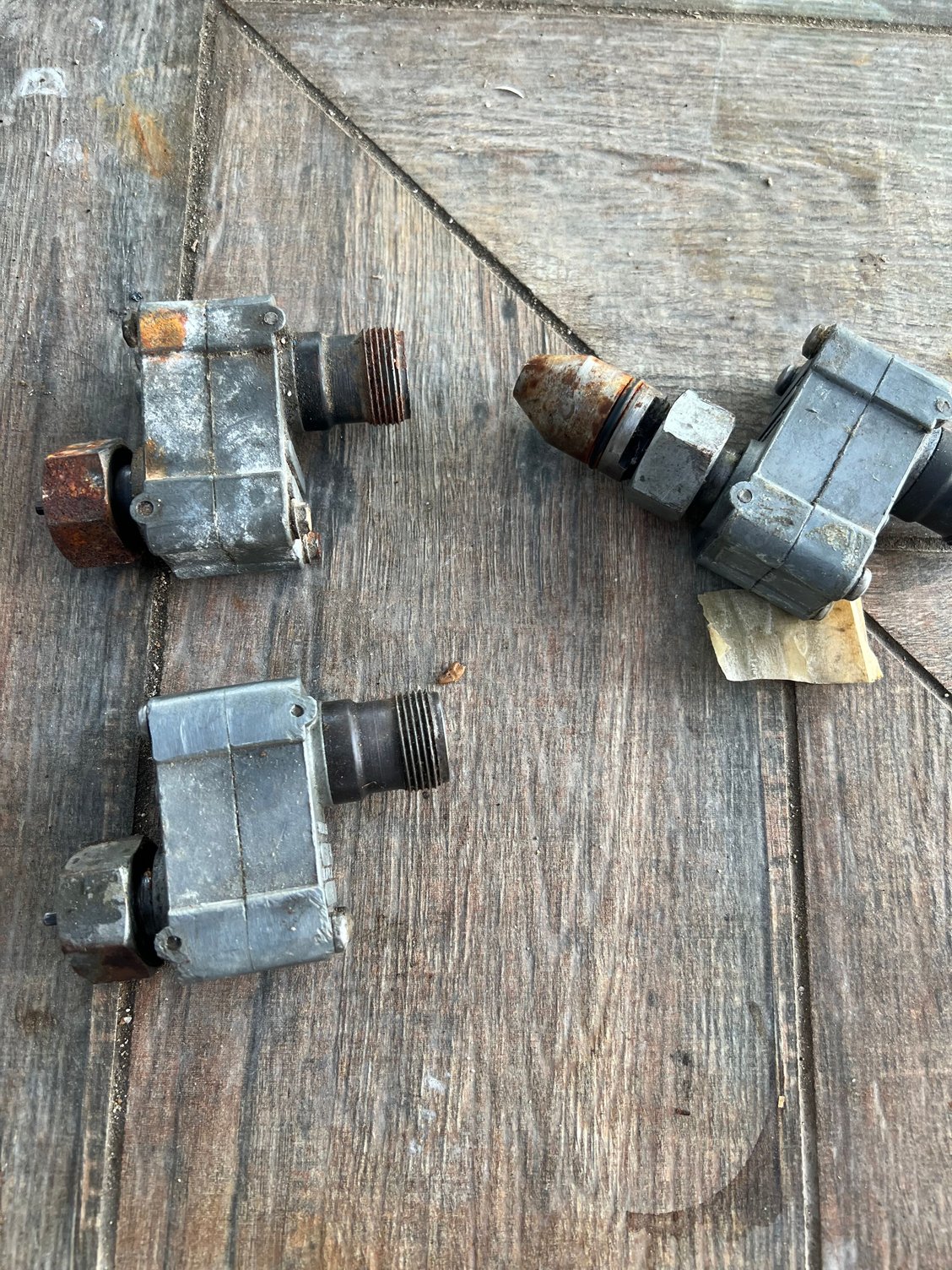

It looks like you resurrected an 8 year old thread , but I have several….i thought I had more…..these came from my dad’s repair ship so I don’t know the history. These are 3 Stewart Warner adapters with ratios ranging from .8241 to 1.3900….i always thought this was the Chevy type but I don’t know. Anyways I have these. Maybe someone can chime in and help.
The one with the masking tape is marked Chevelle 4.10 but don’t know. It says 1.2020

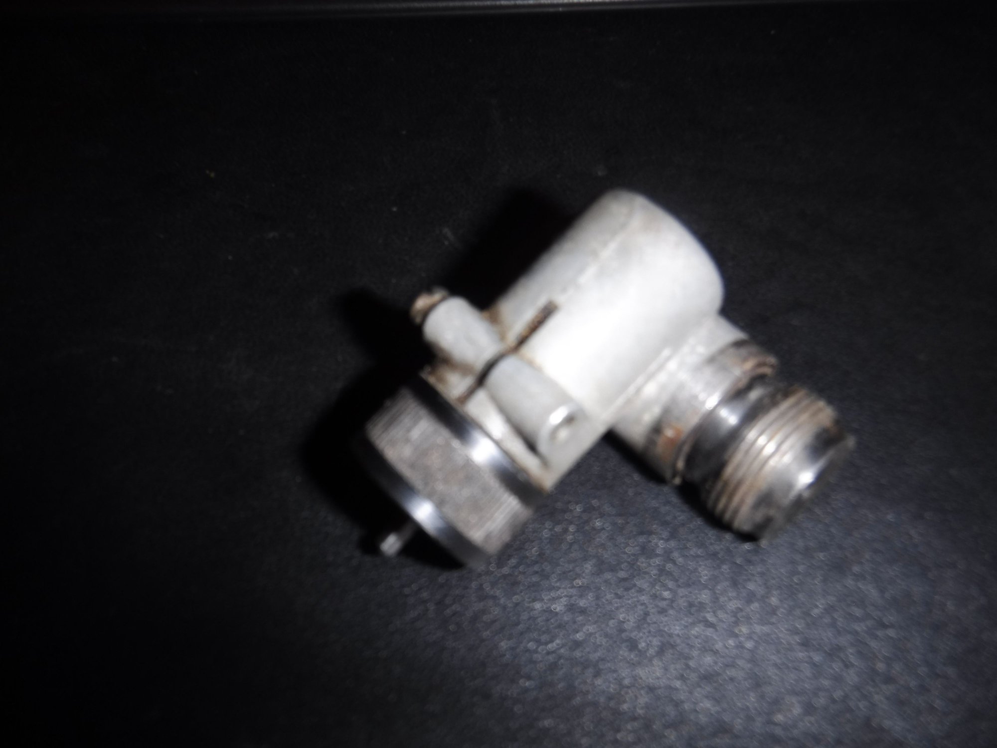

reducer
....90*..90degree. I have this ONE....But check is in the mail Sale Pending... The inline units are MUCH more common
