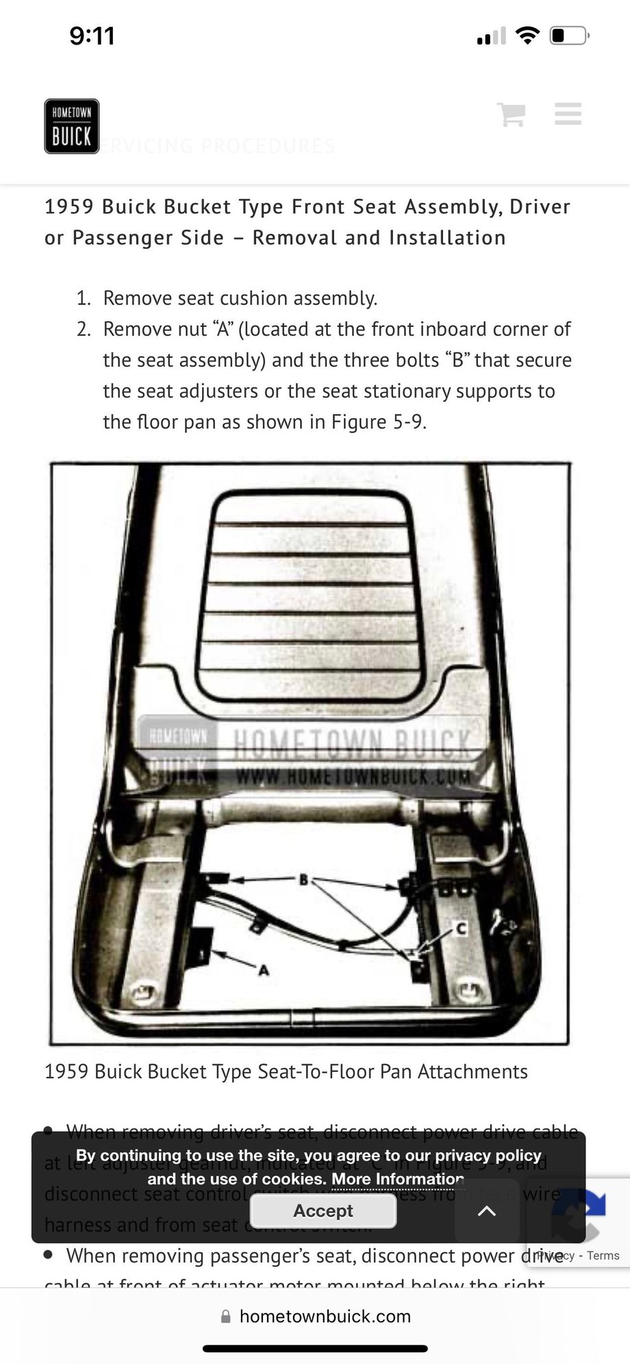

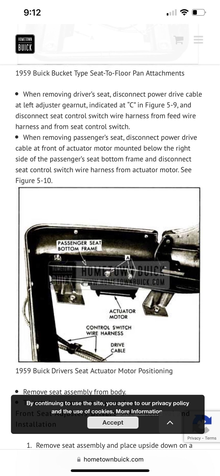

Hello guys I’m new here so if this is not allowed please delete. So I have a set of 59 to 61 gm bucket seats only the driver bucket is power but the motor is mounted under the passenger bucket and there’s a cable that screws into the motor then goes under the carpet to the driver side bucket seat and screws into the slide rail to make the seat move when you hit the switch I can’t find anyone who has one of those cables or any place that remakes them. Any help would be highly appreciated thanks in advance! Here’s pics to help

I am not certain where you can get a cable made, but I believe that it is identical to a speedometer cable.

If I could find my 1962 Olds body parts book I could try to cross it to 61-62 Starfire power bucket. Those numbers ain't in the 73 edition.
This is a two way seat, right?
If you could find someone to make up a short length of it, a speedometer cable will work.

Oldsdruid yes it’s a 2 way switch but only the driver side bucket is power but the motor is mounted under the passenger side bucket and these don’t have a seat transmission like other bench seats or bucket seats of that era
