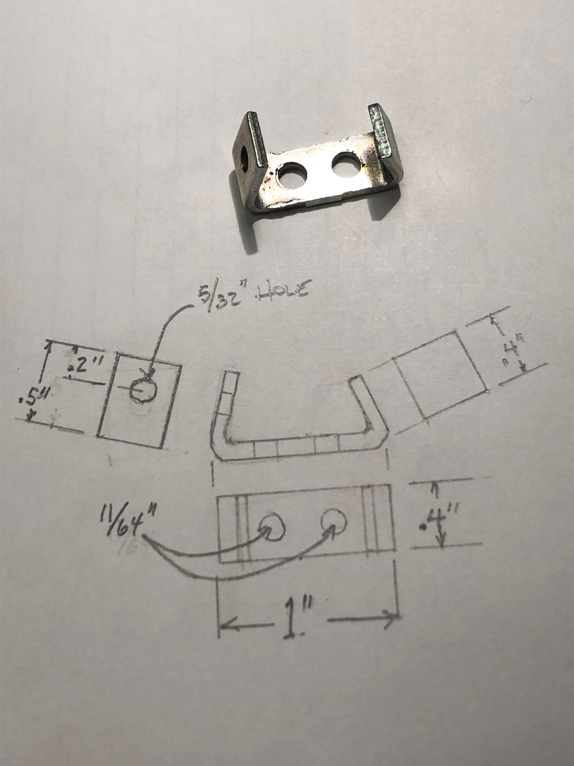

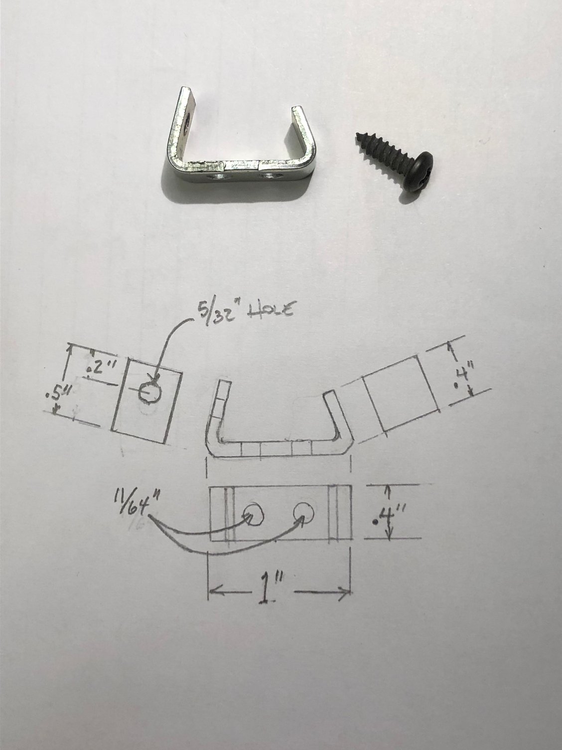

See if these help:
This is how it fits in the thermometer
The two holes in the center aren’t a critical measurement - use this piece to mark where the holes in the door will be drilled. The hole size is just big enough for the metal screws, which don’t fit in a 5/32” hole. The single 5/32” hole is designed for a rivet to attach the thermometer to the bracket, but most I’ve seen just use a stainless screw.

Hey man I can't thank you enough! Super great diagrams, I really do appreciate it! And I have the rivet, so that should work out beautifully with your diagram. I want to thank you by your name, but I realize I don't know your name LOL thanks! Chris
