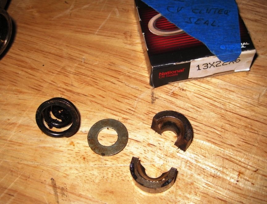

Is this the part you might need? I will sell it if you need it. A new rebuild kit hasn't been available for years, but I might be able to find a good used joint assembly for you. By the way, National Seal # 13X22X6 will replace the ball/socket factory seal, it's only 1mm thicker but works perfectly.

There are two or three inserts that ride against the ball and a spring keeps constant pressure on the assembly. When taken out, the spring pressure wants to pop the assembly off center, if it doesn't something is wrong. Here is a pic of the 2 insert style I sold last year.

Do you still have some? This looks like what I may need, possibly along with a new front section with the ball.

No I currently don't but I can get the parts (used) you need in a week or so. You shouldn't need the back driveline, the inserts take up all the wear, not the yoke itself.
If the ball on the splined shaft part shows any wear at all, it has to be replaced or it will ruin the spring loaded inserts that mate with the ball.
