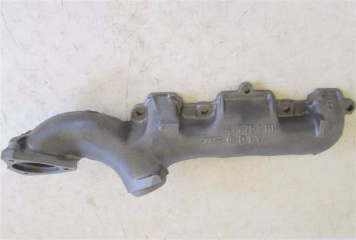

I am looking for a set of clean exhaust manifolds for my 72 350. Mine are pitted and need to be replaced. I am not sure if the rh manifold is correct. I have seen 2 types described as 72 manifolds. Some exit at about a 45 degree angle and some point straight down. I have he straight down type as shown. Thanks

Your pic of RH 417754 application was used on 75 260 in A bodies, 350 in b bodies, 75 B & C 455
according to the parts manual
71-73 350 all bodies RH 398704, 70-73 350 all bodies LH 411961
hope this helps

Apparently this manifold is not correct for my car. I need the 398704 and 411971 manifolds. If anyone has a set let me know. Thanks.
