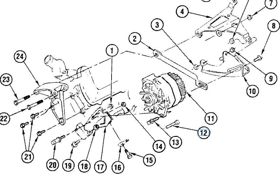

Bolt only has one piece. The threaded adjuster goes to the alternator ear, and the bolt threads through the adjuster. The stop is what the bolt rests on.
Bolt (12), adjuster (13), and the stop (20) in the pic below is what all you need.
