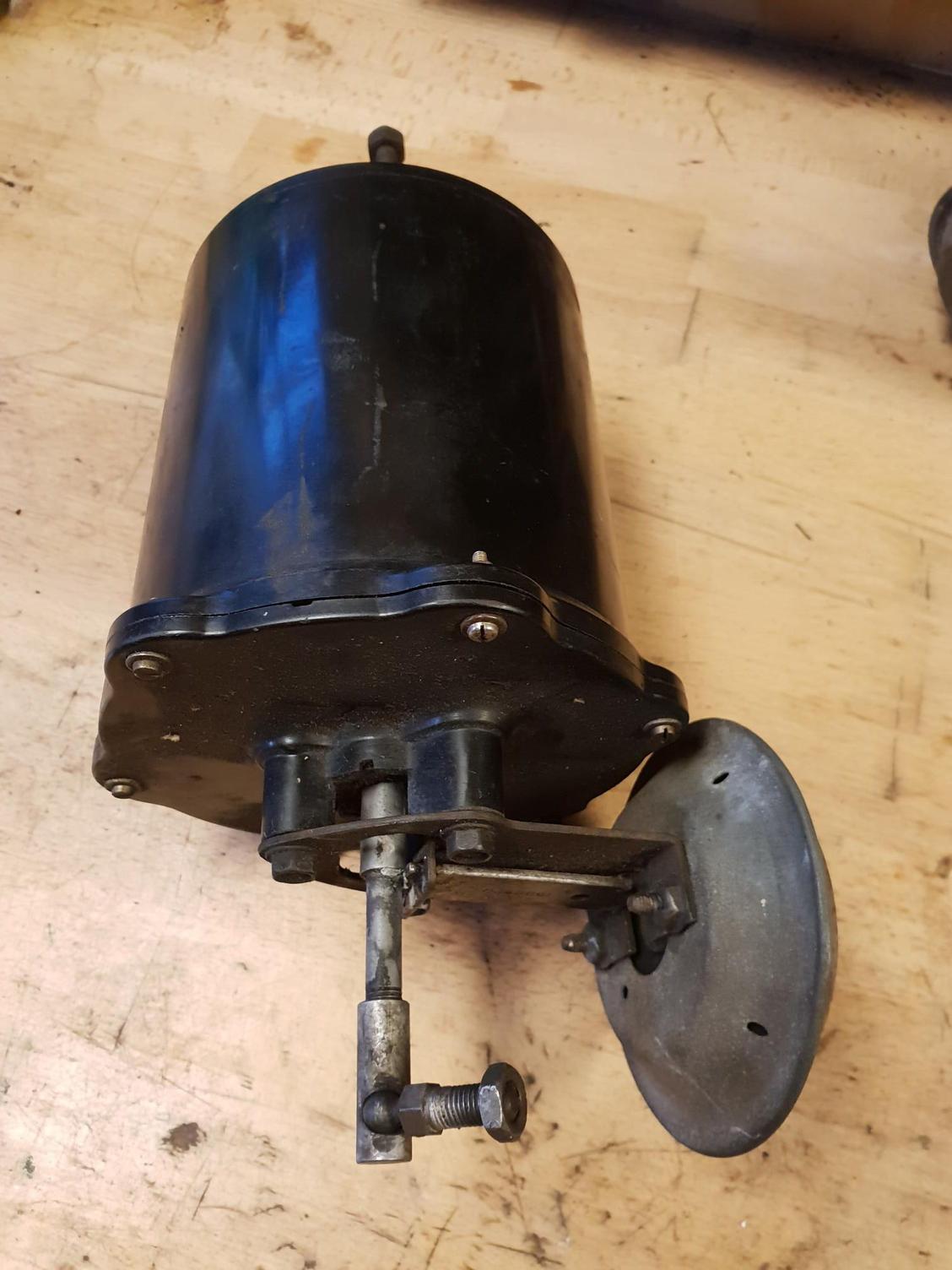

Hi, I am working on a 1966 Toronado, need a canister for the headlamps, anyone here?
Thanks Wim

is it the square one? vacuum tank?

Looks like this...

servo

oke thanks, I dismantled them today, need new springs... where can I get these??

Looks like that has already been serviced once as the canister is held by screws instead of rivets. The fellow that used to supply kits to rebuild them passed away a couple years ago. Best bet is probably take the spring to a spring supplier and try to match something close. Maybe a fastenal shop would have it?

Thanks, I will try a spring shop, one spring is broken...
