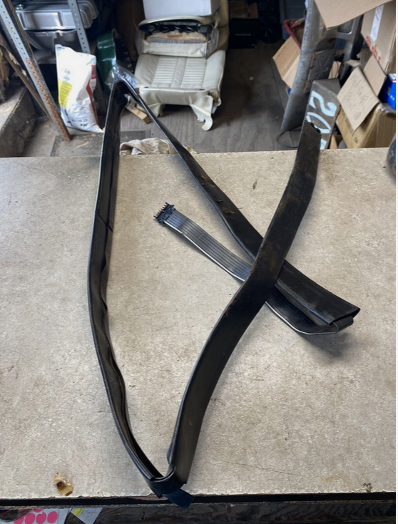

Apologies for not knowing what to call this harness. It runs between carpet and floor board supplying power to rear light harness. Basically a 6 flat wires in a sheath. 1964-65 is not the same. Thanks.

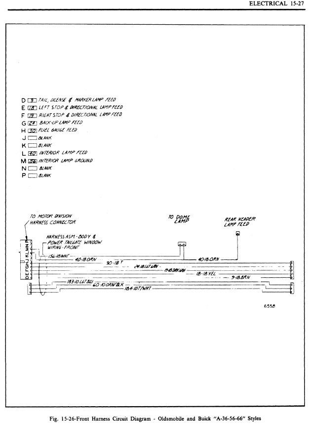

I'm not sure exactly which year Oldsmobile began bundling wires into the flat plastic sheathing from the fuse box between the carpet & the floor pan to rear of vehicle. Did you have a specific question regarding that flat plastic sheathing?
Old Mar 12, 2025 | 11:08 AM
Posts: 26,056
That sheathing was supplied by Fisher Body. The color code(s) & diagrams are contained in the Fisher Body Service Manual. Here are two diagrams from the 1971 Fisher Body Service Manual. I can't say if diagrams are contained in the Fisher Body Service Manual for 1966/1967 model years but I suspect they are contained in both 1966 & 1967 Fisher Body Service Manual.

it's called a ribbon cable
https://www.ebay.com/itm/22564569912...p=enc%253AAQAK
Old Mar 12, 2025 | 05:34 PM
Squarebody442's Avatar
Joined: Aug 2023
Posts: 91
Thanks for all the great info. Purchased from e. Bay link provided.
