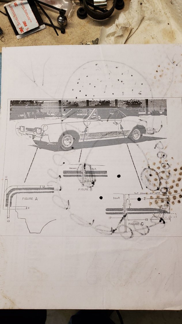

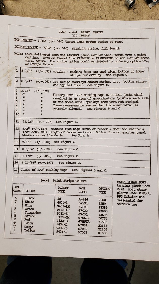

Anyone know the widths of the 2 pinstripes on '67 442?

I got this; don't know where it came from...
My daughter drew on the back with Sharpie 😕

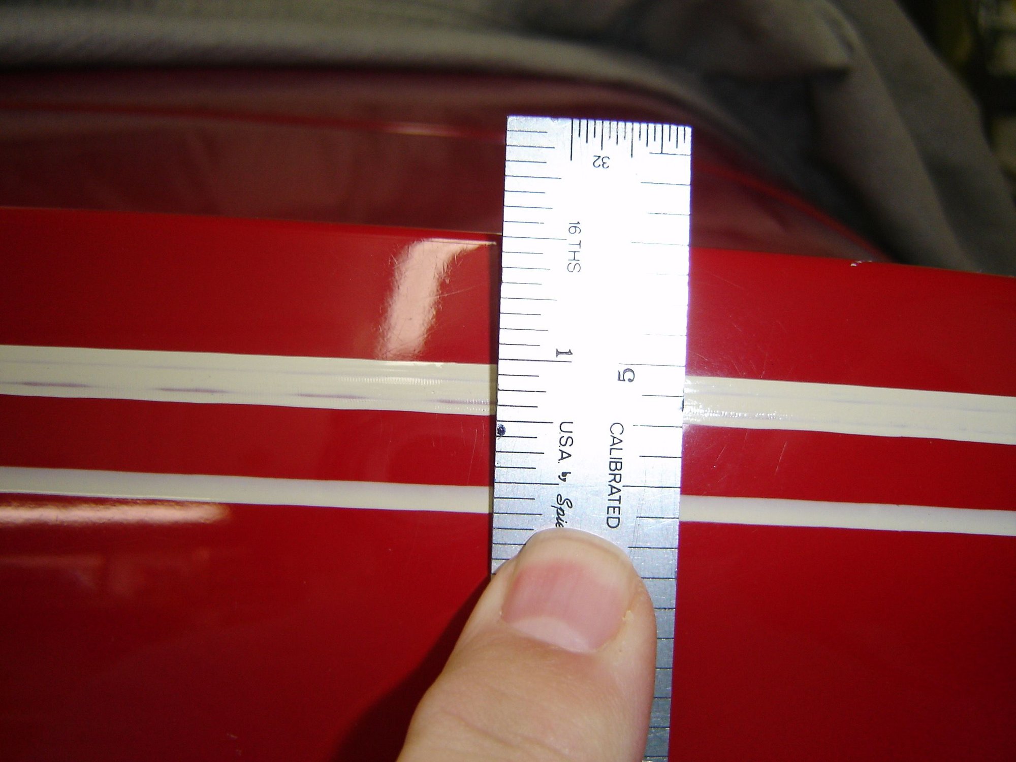

5/16" was pretty standard for a double pinstripe for decades.
