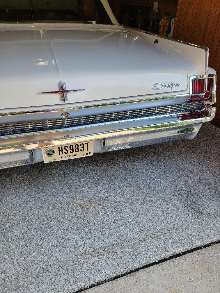

Hello, I am new to this site and this is my first post. Being an old guy i am still trying to figure everything out.
I have a 63 Olds Starfire Convertible that I purchased a year and a half ago that I am finishing restoring. a detail that I can't seem to fine an answer for is this. the Olds emblem on the center of the trunk is all chrome but i have been told that the center originally was a red star. I have also been told it was all chrome also i have looked at a ton of pictures online of 63's and seen it both ways.?? does anyone know if when it came out of the factory if the star in the center was red or just chrome??? the emblem on the grill is painted red in center star.
Thanks for reading and any input will be appreciated.

therobski, That does not look like the trunk emblem i have. It must be differant for the convertible.

Robski, that's an 88 emblem. Either the emblem or decklid has been replaced in the last 60 years. This emblem has a plastic insert. Painted red on reverse side with a silver backing. Plastic is held in with Ternstedt's trademark mushroomed retainer pins.
Skip1963 has the correct Starfire trunk ornament. The star should be painted "Oldsmobile Purple" which is actually a purplish magenta red.
Get some good masking tape and you should be able to find a suitable color spray bomb. Clean the emblem with some denatured alcohol, tape off the star and spray a few light coats. Wa-la!

Hay, thanks. I am going to do that

Hi Rocketraider, took your instructions for painting my 63 starfire emblem and "wa-la" looks great!!!!
Thanks, skip1963
