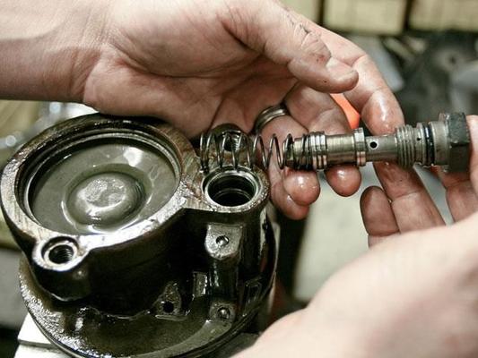

I put a pump back together once and installed the piston for the pressure relief valve backwards (flat side to the inside on the pump instead of against the rear hose fitting). The result was the car had no power steering just as you describe (no whining or noise). Took the fitting off the back of the pump, realized my mistake and the problem was fixed. Here is what the valve/ spring assembly should look like:

I'm put the plunger in first. Popped it out and back in the correct way and instant power steering. Thanks all!
