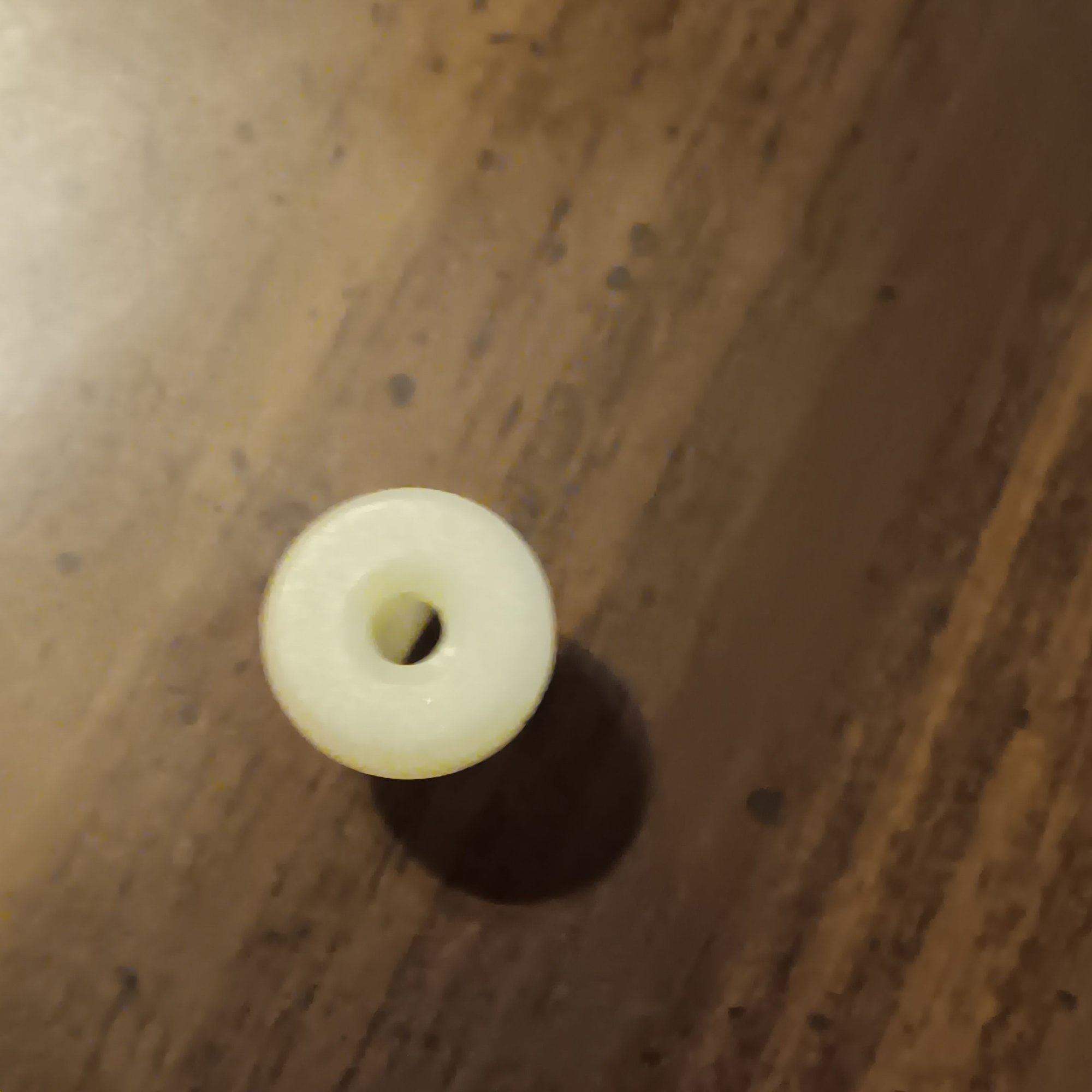

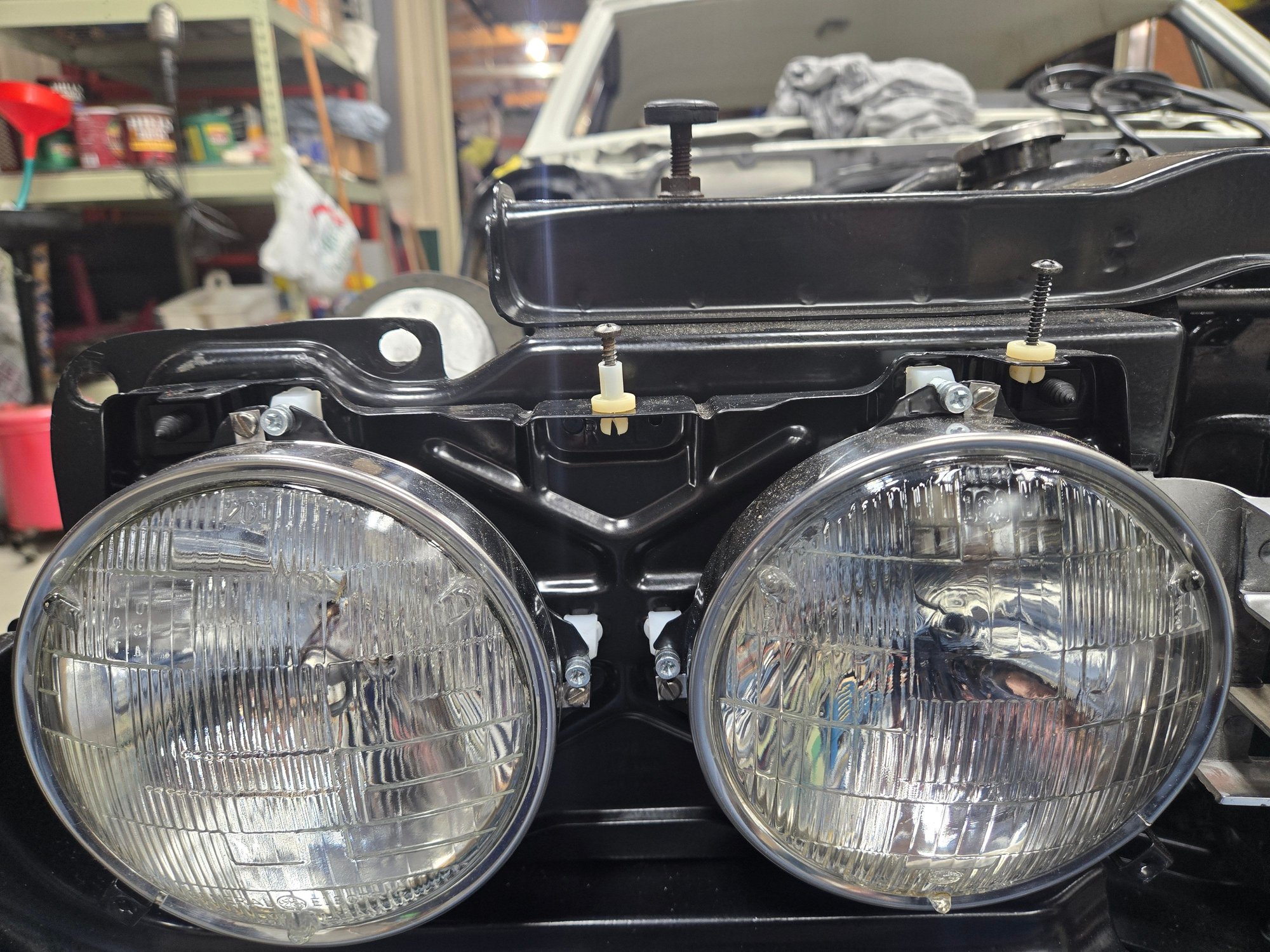

I was able to find the nylon push in screw fasteners at ACE Hardware in the giant Hillman product selections. These were listed as GM license plate fasteners. Dirt cheap too! 55 cents. They fit the square 1/4 holes perfectly. For the taller screw fastener, I used the same push in fastener and used a nylon spacer to get the correct height. I bought a 1/2" spacer that the #8 screw fit in and ground it down to 1/4". That gave it the correct height. Even though there is a square 1/4" hole for a third oustside fastener, I believe they did not use it because with the front fender corner caps on, you can't get to the Phillips head screw. That would make changing a headlight alot more work. Thanks for everyone's help!
