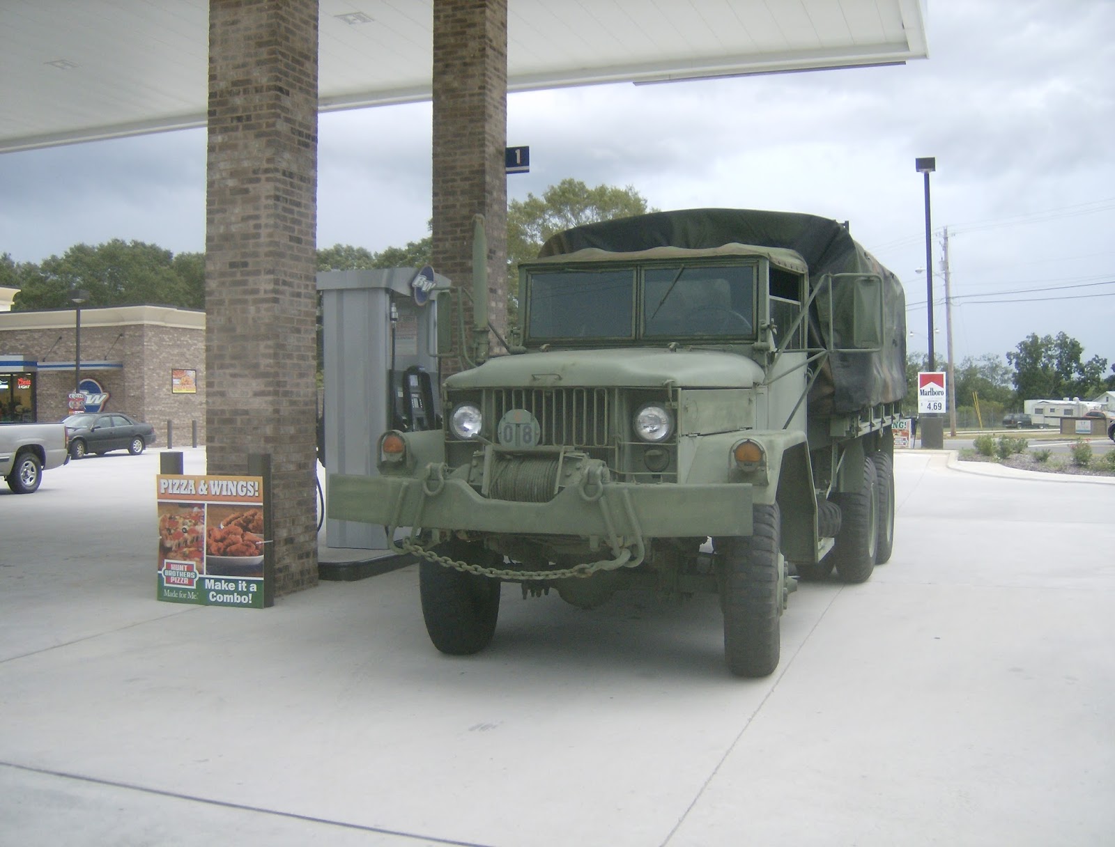

Mike? Just tow it with your M35
Allan R is offline
Old April 20th, 2014, 11:25 AM
Join Date: Oct 2011
Location: Georgia
Posts: 7,687
That's a great idea Allan! It would be the first Airstream with a pintle on it.
slantflat is online now

Brett your pictures aren't coming through. But what Allan meant was this one.
